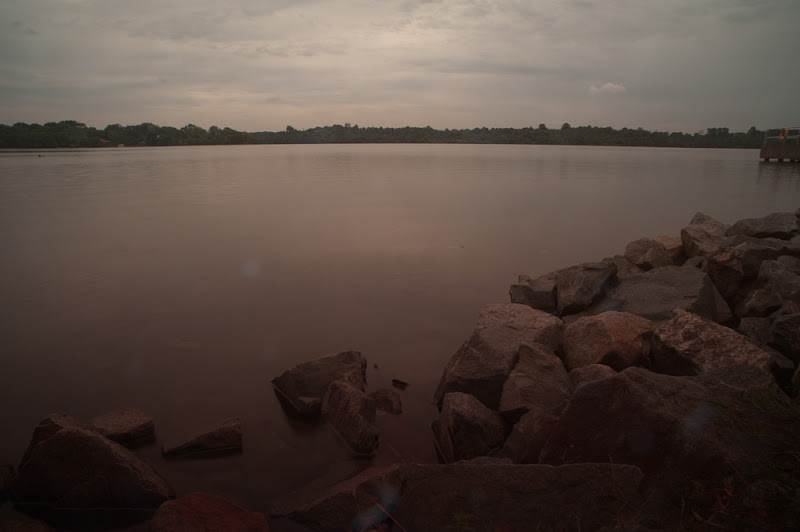

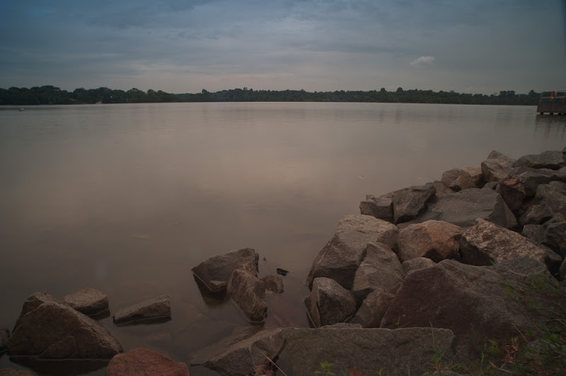

I find that when using the tianya ND8 or ND4 individually the color cast is almost not there or very minimal.
Like already mentioned I also have no problems with the tianya's GNDs (but so far i have only used GND & GND blue)
the color cast in my opinion is intolerable when the gnd 8&4 are stacked together
images below are identical (i hope)
both shot at f20, 1/2sec iso 200
both images(RAW) were zeroed in LR exported to jpeg
a)tianya nd8+graduated blue
b)tianya nd8+nd4+graduated blue
color correcting the first image was fairly easy(using LR) but i can never get the second image color right (maybe can be done in photoshop,still improving my photoshop skills).
if someone can kindly point me in the right direction on how to minimise the color cast of the 2nd image. i would be really grateful
Nonetheless i did have a go at cokin and lee filters my friends use and the lee filter system is color cast free to my untrained eyes.. but price wise :bigeyes:
cheers
cheers
erm closest i can think is erm...
go under curves and adjust?:think:
i never succeeded properly
but i liked the effects of the reddish cast so yea.
