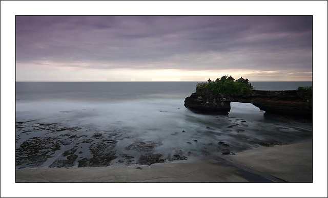

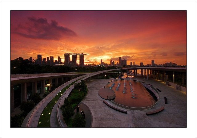

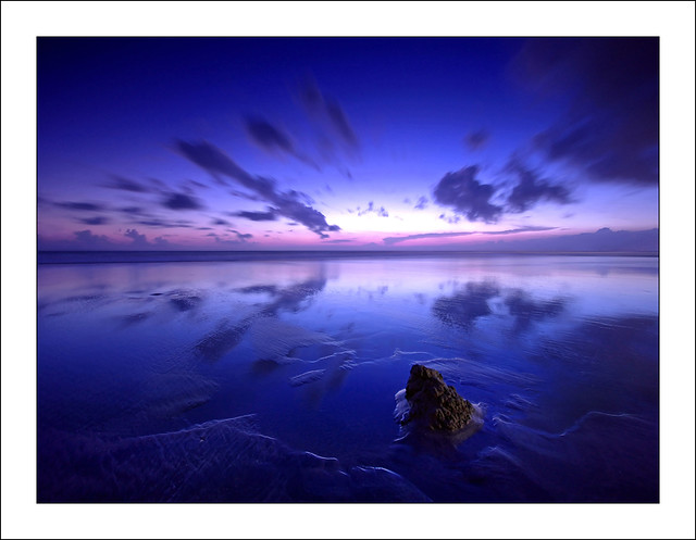

well, i don't know, do my photos look like they shout out that gnd is used? :dunno:
these are tianya shots.
i cant tell where the transition point is, so i guess it should be "soft" enough.
i'll give it a go.
thanks.
Hey n86m, are those done with Tianya GND and B+W ND110?
i can't tell for the 1st pic, but the 2nd and 3rd i can tell .. but i must say it is not obvious... err.. bcos it is sunset... and the clouds does help...
i use it before for some shot at mt faber.. it is not a sunrise or sunset.. and i can see the blue sky having uneven tone.. cos my tianya's soft edge is quite big... not very subtle...
only the first photo has both.
the rest are just GND only. ;)
sorry, can you explain why the setting being sunset helps?
the only reason i can think of , is that you seem to be overfiltering your photos, or you are not placing the line correctly.
tianya is best used at sunset, daytime unless you are facing a backlit situation, using a tianya will make the top half darker than the bottom half most of the time, if the light is falling on the direction you are shooting at.
if you place the graduation at the right portion of the photo, and you use the right strength for the lighting inherent in the scene, i don't think tianya will be visible.
i have some old shots where i didn't bother to check whether i placed the graduation properly, can easily see where it ends, because very abrupt jump in exposure, cos filter where not supposed to filter, or where supposed to filter never filter properly

because i have checked these 3 photos quite a few times, and i have seen unfiltered versions of all the ones without gnd usage because i did bracket to gauge optimal exposure before filtering. #2's horizon line was right smack in the middle, i just pushed the graduation line to the middle of the lens, for #3, i used live view to ensure the graduation was at the right part.
i am very puzzled as to where you perceive the filter graduation ends, because i am looking, and looking and looking at #2 and #3, and i can't imagine where you think it ends, other than the logical area where it should end, of course.
in fact, #2 and #3 are not even good displays of soft grad usage, unless you really **** up the placement or use a hard grad, wrong placement of graduation will not cause much visible effect.
#1 is the test of whether the graduation is obvious -
do you see an abrupt loss of detail in the temple? if not, then it is fine.

so going back to your qn, i will say in pic #2, i can see the graduation near the top... the top part is darker in tone... but i think u will prove me wrong soon... but since u ask, i will answer... :)
