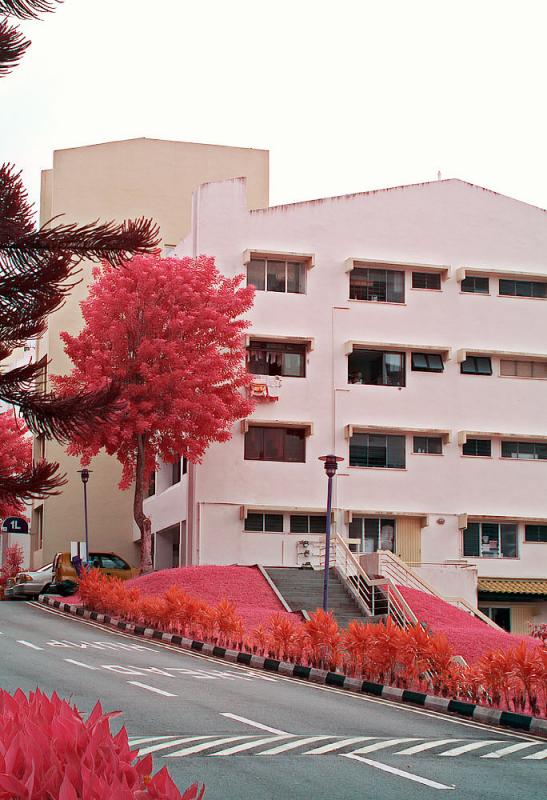

How about this? Give your opinions guys. No IR filter used in this pic trying to simulate colour IR.
Does not look "natural" leh although nice effect.
teerex said:
Have tried that before, but did not like the effect.

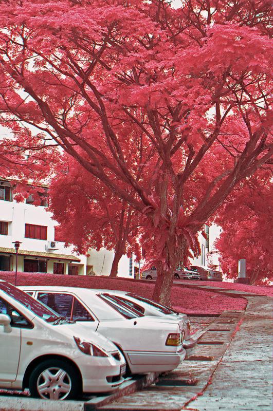

Dennis is right, not natural for a imitation of IR. I had accidently found a way to make a digital picture to look likes a colour IR pic, I am not good at PS so maybe someone expert might enlighten us here. One problem I found is that the method i used can't make white to remain white, but worth to try out. I hope Tomcat maybe can share with us his technique :)
1 Open any colour picture prefer with blue sky and green vegetation.
2. go to Layer > Adjustment layer > channel mixer
3. It will pop up a window, just click OK
4 Channel mixer window appear, drag or type in R ( Red) bar / value to 40 %
5 Drag or type B value to 35 %
6 Now check the monochrome box
7 Uncheck again the monochrome box
8 Now drag the R value to higher percentage eg 180 %
9 Drag B channel bar to lower value eg -25% ( minus value )
10 Adjust the both value accordingly to get the effect
You'll see the green become red vegetation and blue sky remain blue, however not all pictures suitable to do this, especially if picture contain white cloud, due to colour cast appear.
Anyway no harm trying. Save me a lot on colour slide $$$ hee hee !!
Nice work Panda.... with the grain in .... looks more like film IR.... well done. clap clap clap !
