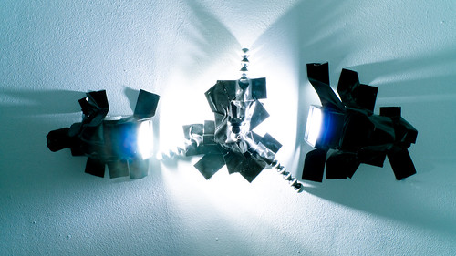

2 gridded Vivitar 285HVs top left and right at 1/16th power to light up the cam, another at the top gelled blue plus grid at 1/4th power to light up background..

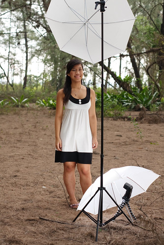

nothing too fancy, SB-800 ontop at 1/4th power, 430EXII at 1/8th, both through shoot-thrus.. my first try at off-cam lighting on medium format..
more from this shoot on my flickr stream..

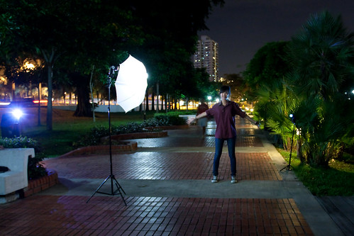

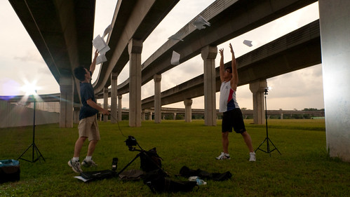

j-chan i finally can contribute something, cos i finally took behind the scene shot lol
here's one which i did a few days back showing the setup here
the resulting photo looks like this
i have a more detailed description HERE maybe next time we can have more contributors to share and learn from each other :)
