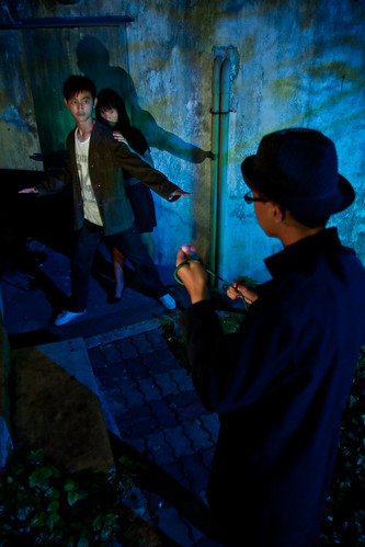

sharing a setup I did for a conceptual shoot with some friends..
SB-800 with CTB gel high up and back, shooting into the tree to give some shadow texture, SB-600 with CTO gel directly below my position to light the subjects, another 430EXII with dark green gel on the right to give that green highlight separation.

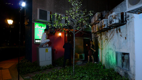

another one from the same shoot..
4 light setup.. Vivitar 285HV at 1/16th power into shoot-thru umbrella held high left, SB-800 at 1/32th power into softbox right, 430EXII on street lamp behind at 1/64th power, SB-600 with lavender gel way back left at 1/32th power. Triggered via Cactus V4, SB-800 on SU-4 mode.
Your fren who is holding the vivitar on the right, has a ggreat funny action in the pic ;p
