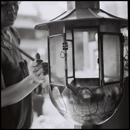

Here's a simple picture from a Rolleiflex 2.8F TLR, and Kodak Tri-X 400 developed in Rodinal Special, the fine-grain version of Rodinal.
- I also used my "x-ray" accessory for the lens, set at level 1 ...... just kidding :-)

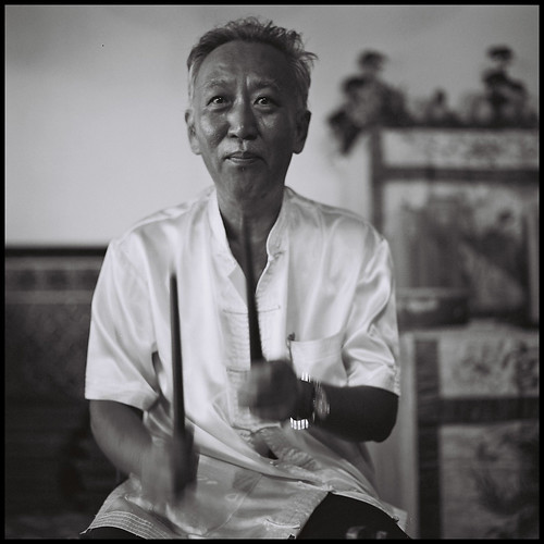

- really no preparation, and no meter even ? On this pic with a Rolleiflex, I just set the exposure to what I thought was right, without metering, quickly focused, and shot. Some burning and dodging helps a bit. Of course, one needs some practice for metering without a meter.
