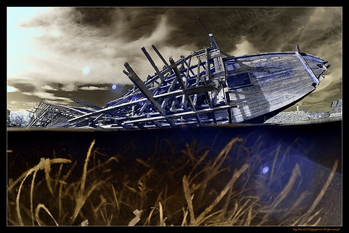

Here's an example of an over-under of a wreck, with the bottom lit with strobes. This looks more traditional IR than the some of the coloring adjustments that were used.
http://www.facebook.com/photo.php?fbid=119049394856773&set=a.119047958190250.23707.100002551391067

I was the one who took that IR over/under wreck shot Antacid posted (with the version I prefer shown below). I am not the first person to attempt underwater IR either and I took my initial inspiration from the very accomplished Imran Ahmad. A good friend of mine and professional photographer. I also had the pleasure of meeting Edo Ang (who took these photos in the original post) in Wakatobi when I shot the wreck in IR for the competition. This photo below was my favorite shot from that shootout. The judges seemed to prefer my other shot that Antacid posted though. Perhaps they did not like my use of "creative flare"

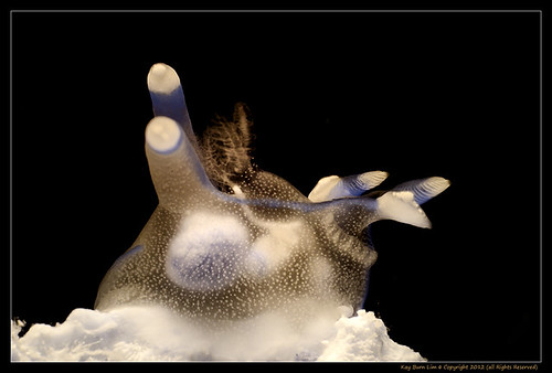

If IR photography as how we know it is to be done underwater, it's thus mostly left to the realm of macro shots. IR that has become fully absorbed means jet black backgrounds anything over 15cm away, even with the most powerful strobes. That is not to say close focus wide angle shots are not possible.... The photo below was taken with a Tokina fisheye lens and a 1.4TC. The fish was almost touching the dome port of my housing. It took a lot of patience to creep up to him to get this. Taken in just 3m of water in VERY bright sunlight. I would have been happy to wear a pair of sunglasses under my mask then. This is where you can see the effect of IR in water.... light may come in but infrared is the FIRST in the color spectrum to get killed off and absorbed...way earlier than the color red.
It's not hard from this to figure out what the creative possibilities are for IR in underwater shots. jet black backgrounds, higher contrasts... think like topside IR and monochrome photography. The shot below was made using the same fisheye and TC combo but with the addition of a handheld snooted strobe with the light fired at full blast downwards.

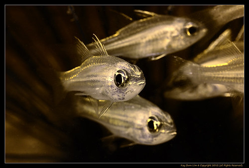

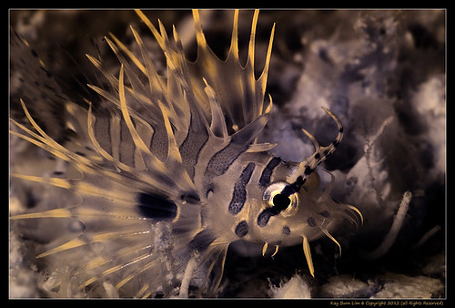

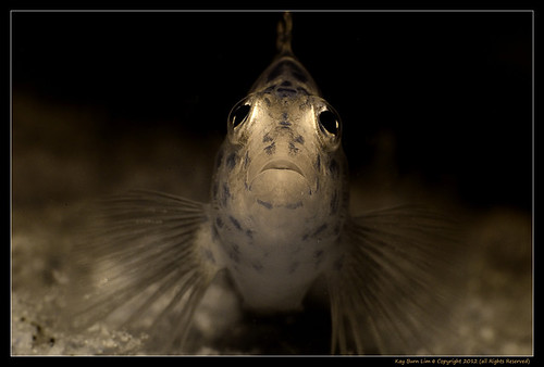

I hope this was useful to those interested in trying IR underwater. I'm glad Edo is testing False color IR underwater and would love to see more results. Any experimentation with UW photography is to be commended. Sadly, I just don't see the results of UWIR being as appealing as it is in land based work to the average viewer. I was even asked before that wreck photography would be awesome if done this way. However, from the false color examples I see, the blues are still evident and not at all absorbed into black as in normal IR. This means you won't get the nice contrast you prefer! it can't be done effectively with normal IR too as you would not be able to see farther than 15cm (Unless you are shooting a toy wreck of course!). In the perfect world, I would love to have every opportunity to study the various filter spectrum options available to me ONLY for wreck photography to give a special look. That would mean blacking out the blues yet having the wreck reflect light... if this can be achieved, I may get myself a special wreck modified camera! I am however doubtful as even throwing all the light in the world at your subject does not mean the light reflected back is strong enough to reach your camera sensor.
Anyway, in the meantime, here are a few other UW IR shots I have taken... enjoy! C&C is always welcome;
