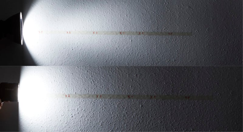

A top and bottom comparison of light falloff

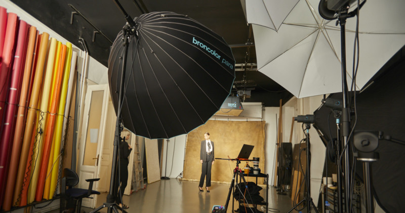

The Light Source Being Too Close
The inverse square law assumes that the light source is a point that has a negligible size. However, with most photographers opting to use big softboxes, this can no longer be a reliable way of telling light output.
If your light source is anything bigger than a bare bulb, it won’t follow the inverse square rule as the light source is bigger and cannot be considered a point. With huge modifiers that are meters in diameter, this law is no longer true for most practical purposes and subjects.
A photo shoot with lighting equipment in the foreground
Nonetheless, there is a certain Five Times Rule, proposed by Anders Hanoola and David Bicho. It states that it is fair to approximate light source as a point source if the subject to light distance is five times greater than the light’s largest dimension. What this means is that if your softbox is 5’, you need to be at least 25’ away for inverse square law to behave how it would with a bare-bulb source.
A 5’ octa is very common to use in photography, but 25’ away it becomes a lot less practical, as it will give a fairly hard and dim light. Large modifiers such as this one are commonly used closer to the subject. When working with such cases, you need to be aware that although light falls off with distance, it won’t be perfect. Hence, following your gut and placing the light in a position where the falloff is what you’re looking for is key.

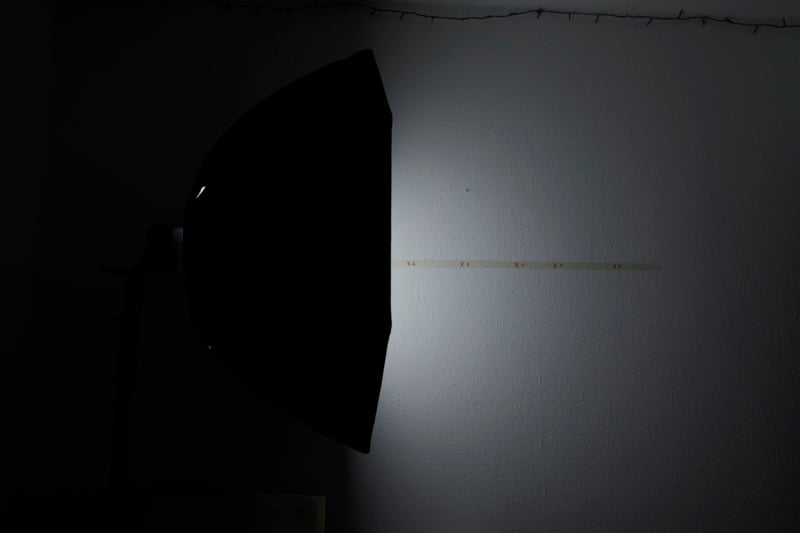

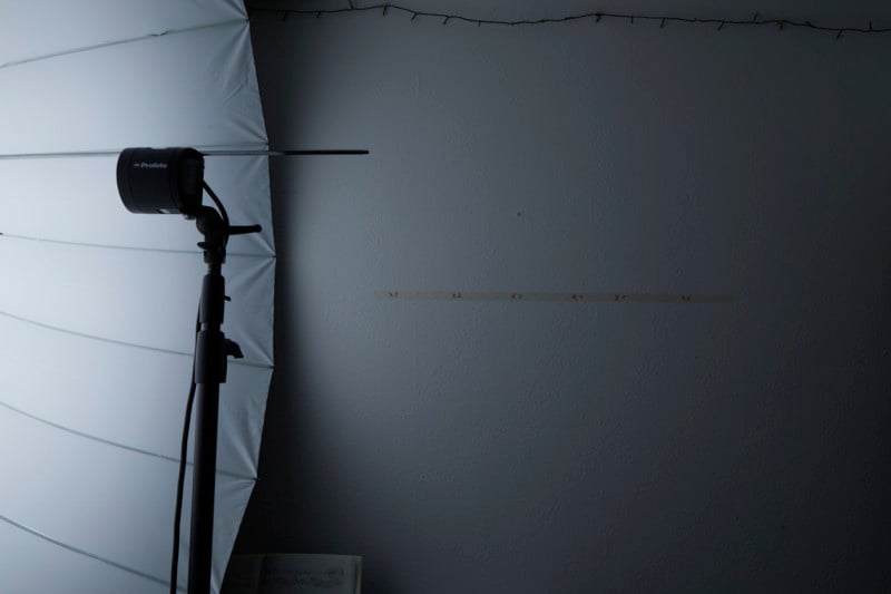

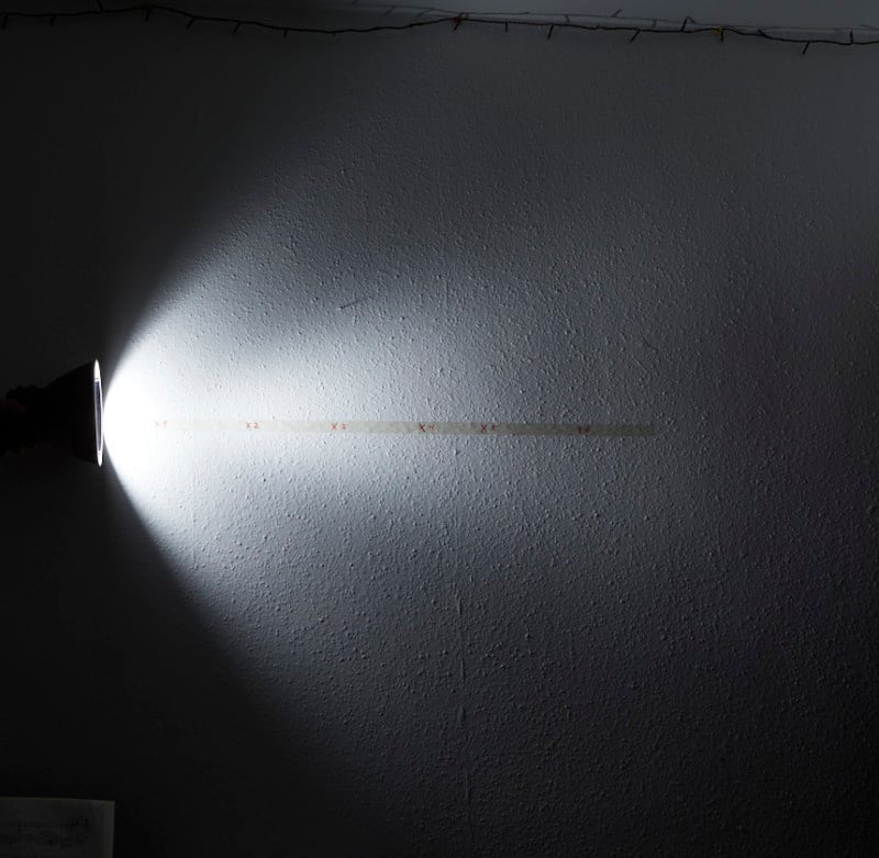

I’ve done a little experiment to show you this. I took a bare-bulb flash, a magnum reflector, a 3’ octa, and a 65″ umbrella. Here is what I got:
An example of light falloff with a 3 foot octabox
3′ Octa
An example of light falloff with a bare flash
Bare Flash

An example of light falloff with a 65-inch umbrella
65″ Umbrella

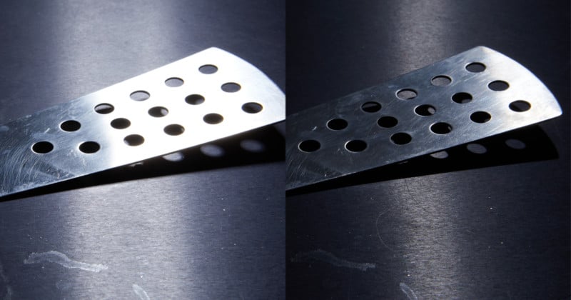

Direct Reflections
A perfect direct reflection will reflect 100% of the light that is cast on it. So, if you take a piece of metal, it will reflect the same intensity as the light source, no matter the distance. That sounds a bit stupid right? How can something reflect light with the same intensity as it leaves the sun? Doesn’t light intensity decrease with distance?
It does, but the reason it does is that the light spread is larger and larger. So, as light travels, it has to cover a larger and larger area. However, with direct reflection, the intensity does not change with distance, only the reflection size does.
A side by side comparison of light hitting metal
The inverse square law is not broken, but it is given a different interpretation with direct reflections.
