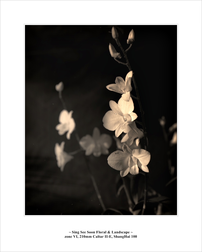

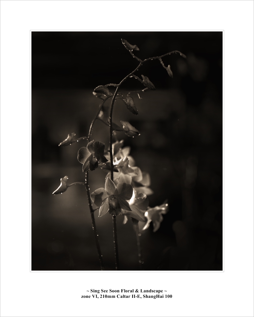

sharing a couple of flower shots with
with my new ( very old ) zone VI 4x5 field camera,
special thanks to Jackson for your light-meter ( it is very accurate ),
Billy

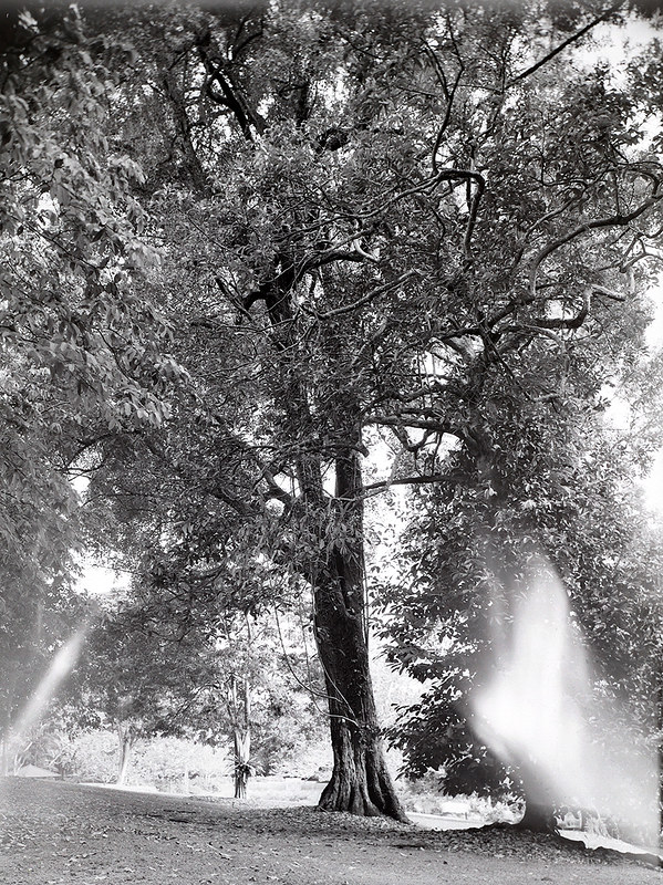

Botanical gardens this afternoon. Sun was really harsh at about 4pm.
Where did the flare came from?
Shanghai 100 F32 1 second
4 film wasted, I pulled open the dark slide facing the bright sky.
Must bring black cloth next time to cover things up in portrait mode.
Orange filter. Lens hood.
Look like pinholes on your bellows, judging on the fact they're on similar location on the film
ummm.... very odd, only occurs when I rotate the back to take portrait.
removed the back and check, no light leak.
Checked the bellows, no light leak too.
I am confused. :confused:
QUESTION:
If I pull out the dark slide with the slot facing very bright source, will there be light leak?
I suppose so?
I heard Vege Birdy said someone flashed next to him, and film got contaminated? Must had seeped into from the slot?
Thanks.
I suppose so?
It shouldn't - or at least the chance of that happening should be very low. There's a strip of felt to guard against light leak. I found out about that strip when I soaked my holders to wash, and found that it took a hell of long time for those felt to dry :-)
Ahhhh.... mine has NO FELT!!
The felt is the light seal, you can probably get some replacement foam from Daiso, I think they have thin strips available.

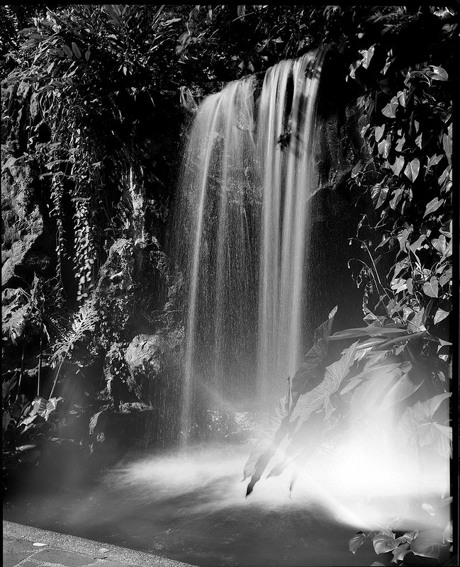

One more shot...
same setup as above.
Ilfosol 3 stand development seems good enough!
