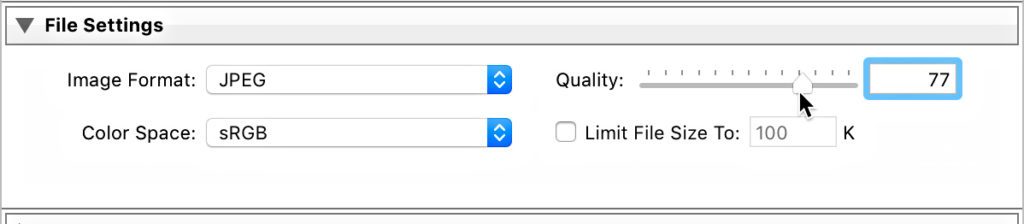

As I perused the various FAQ sections of popular print services, I commonly saw that Level 10 quality from Photoshop as suggested JPG compression amount to be used when saving your photos. If you’ve ever exported a JPG from Lightroom you’ve noticed that Lightroom’s quality slider goes from 0 – 100, and not 0 – 12 as it does in Photoshop. However, what isn’t as obvious is that while Lightroom provides more numbers, it uses the same 12 levels of quality that Photoshop does. A little math shows that Level 10 (83% of 12) is the same as the 83 setting in Lightroom. Actually, because Lightroom’s range is divided into 12 different levels, it is the same as any value from 77 – 84 on the scale (try exporting the same photo at level 77 quality and level 84 quality and you’ll see the file size of the resulting copies is the same). So, that’s a long way of saying you can stick to JPG at level 77 on the Quality slider as your minimum. If you want to go one notch higher because you feel it makes a qualitative difference, use 85 to go to the next level. Higher than that you are just getting a larger file size without any real quality benefit.

Just like with file type, there are ideal file types for capture, ideal for editing in Photoshop, there are also ideal color spaces for exporting for uploading to a print service. Universally, from all the services I checked, they all request or expect Adobe RGB or sRGB. This is one of those things you’ll confirm with whatever service you choose, but sRGB is always your safest choice.
All three of the settings discussed so far can be configured in the File Settings panel of the Export dialog. First, choose JPG, then choose 77 (or 85 if you’re feeling fancy), and then click the Color Space drop-down and choose sRGB (unless your print service says otherwise).

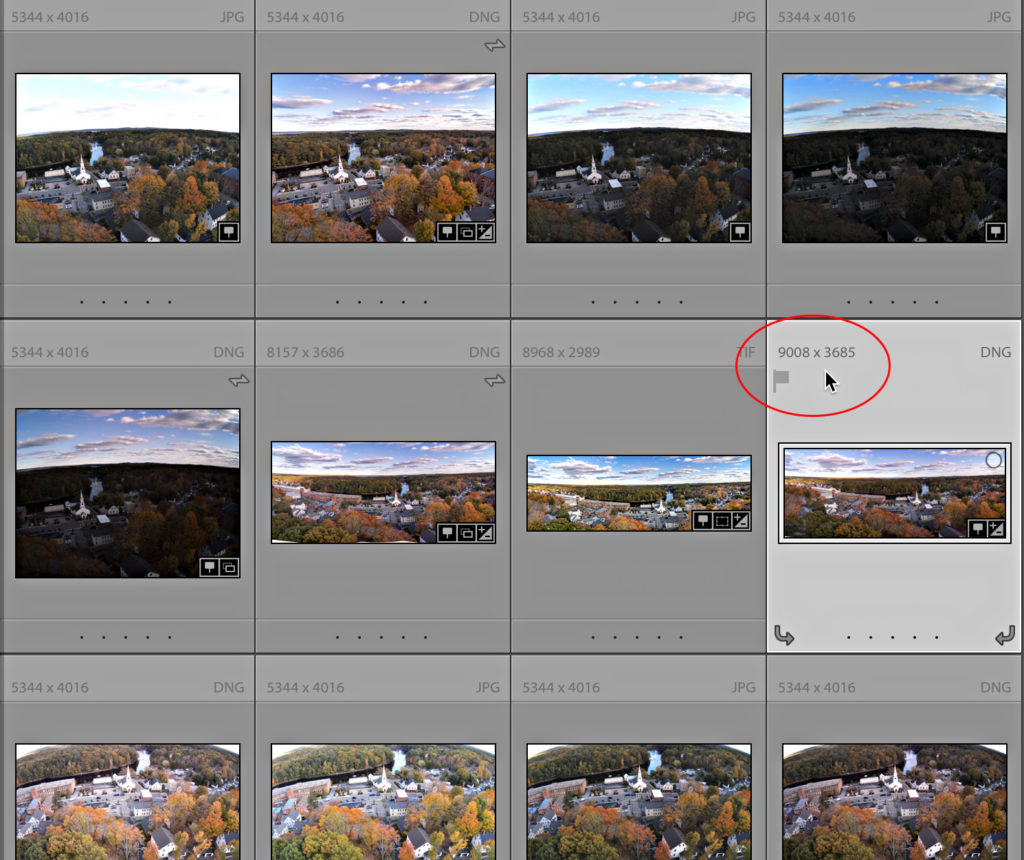

I’m assuming at this point that you’ve done all your post processing in Develop, and you may have even cropped your photo for creative reasons. You now need to look at your photo and determine its pixel dimensions so that you can determine what size print you can make at a good quality and if you need to crop it further to match the aspect ratio of your desired print size. There are a few ways to see pixel dimensions in Lightroom. The first is in Grid view. Just configure the Grid view style to display Cropped Dimensions in the cell border (here’s how). It will look like this:

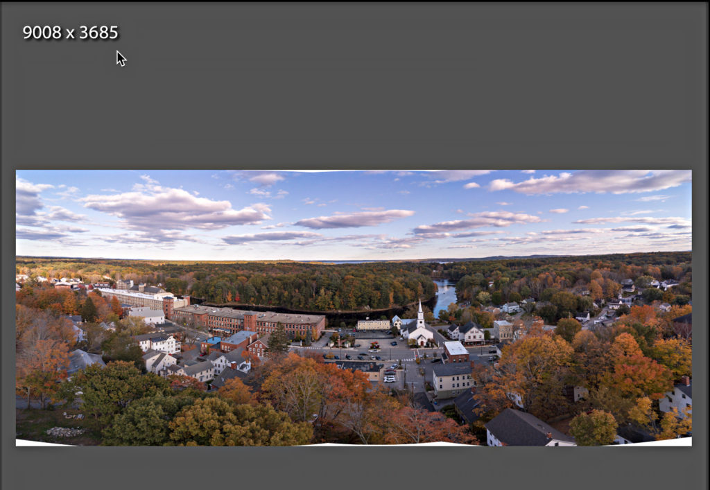

If you are in Loupe view, you can configure the Info Overlay to display Cropped Dimensions (here’s how). That looks like this:
That Loupe overlay even works in Develop’s Loupe view when you have the Crop Tool enabled, so you can see the pixel dimensions before and after you crop. But before we bring down the cropping axe on your photos, let’s talk about resolution (not the New Year’s kind either). The first decision you need to make in order to perform the conversion from pixel dimensions to inches (or centimeters for you metric-minded folks) is how many pixels do you want to print for every inch of photo, which is more commonly referred to as how many pixels per inch, or simply PPI (you might see some places refer to it as DPI, but they mean the same thing in this context). The number that makes people absolutely jubilant when they hear “PPI” is 300. That’s not to say that you can’t print perfectly good-looking images at a PPI (or resolution) value other than 300 PPI, but for the sake of argument let’s target 300.

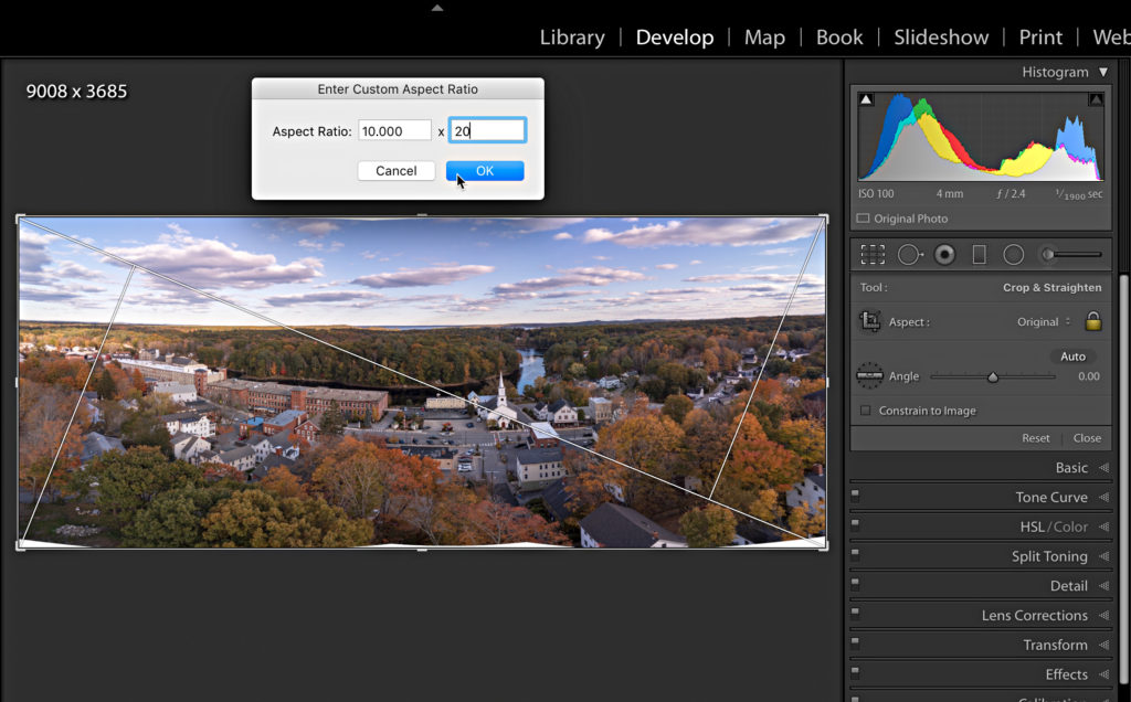

However, there are also common print sizes that are of a different aspect ratio, such as 5×7, 8×10, and 11×14. If we do the same math on the 8 x 10 we get 1.25. Close, but not quite. If you choose a print with a different aspect ratio then you need to crop if you want your photo to match the aspect ratio of the print you are making. To do that, press the R key (for cRop) to jump to the Crop tool, and click the Aspect drop-down menu to pick from one of the common preset aspect ratios in the list or choose Enter Custom and enter your values in the resulting dialog. For example, let’s say I want to print this pano at 10 in x 20 in, which is clearly not the same aspect ratio as the camera or a standard preset aspect ratio.
STEP ONE: Enable Info Overlay by pressing the i key (for Info) to display the cropped dimensions.
STEP TWO: If not already in Crop Tool, press R.
STEP THREE: Choose Enter Custom from Aspect drop-down menu, and enter 10 x 20 in the resulting dialog, and click OK.
STEP FOUR: Adjust resize handles as needed for best composition.
STEP FIVE: Press D or Enter or Esc or R to exit the Crop Tool.

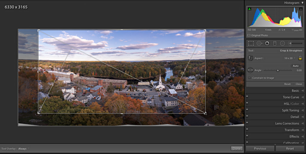

Note, Lightroom saves up to 5 custom preset aspect ratios at the bottom of the drop-down menu, and the oldest in the list will be pushed off when a sixth custom ratio is entered. Also, if you enter a custom ratio that is actually the same aspect ratio as one of the existing presets it switches to showing the preset values instead of what you entered.
My starting pixel dimensions of my pano were 9008 x 3685, and after cropping they were reduced to 6330 x 3165. Do I have enough pixels for a 20 inch print at 300 PPI? 6330 pixels / 300 PPI = 21.1 inches, so yes I do.

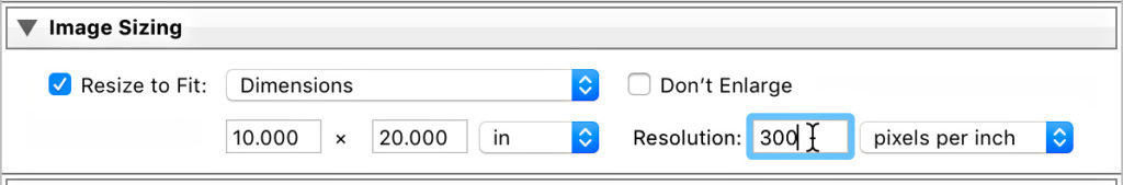

Once we’ve made all those decisions its time to put it all together and export. We looked at the File Settings panel already, but when it comes to image sizing and resolution that is controlled by the options in the Image Sizing panel. In my example above, I would check the Resize to Fit box, then select Dimensions from the drop-down menu and enter 10 x 20 inches, and 300 PPI in the Resolution field. Lightroom would then resize my photo’s pixel dimensions smaller to precisely match my desired size.
That said, you may utilize a print service that simply wants you to upload the “highest resolution” or “largest native file dimensions” and then all cropping and sizing will happen on their end based on the print sizes you choose. There’s nothing wrong with this approach as long as you like the end results. To do this you simply leave Resize to Fit unchecked and the exported copies will have the same pixel dimensions as the source photos. You can still enter in 300 PPI to add that to the exported photo’s metadata.
