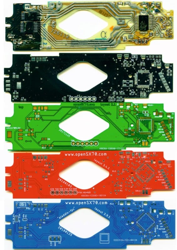

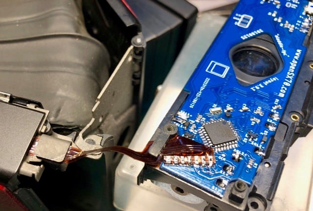

Step 3: Design a PCB to Fit

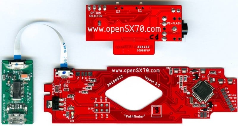

We then worked to design a PCB to fit inside the camera and a control module.
The openSX70 PCB as a work-in-progress in Fritzing.
With AutoCAD’s Eagle, we designed a custom PCB and control module that can:
  • Operate flashbars and electronic flash
  • Control de “manual” options of the camera
  • Fire an external flash via a PC-compatible socket
  • Have a information LED
The openSX70 dongle prototype in September 2017.
Here’s what the latest “downsized” uDongle looks like:
The central part of the project is the main SX70 PCB.
It has gone into several iterations and improvements.

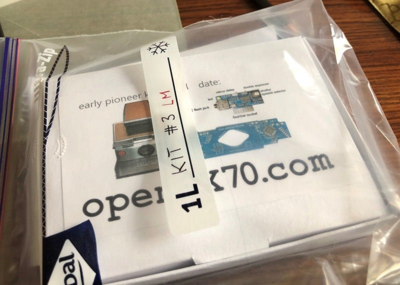

The project is still in the experimental phase. We are implementing auto exposure, and I hope it will soon be a viable kit that folks can install themselves or have professionally installed. We’re also aiming to offer the kit at an affordable price.
You can find out more about the project on its website and find the open source code in its GitHub repository.
