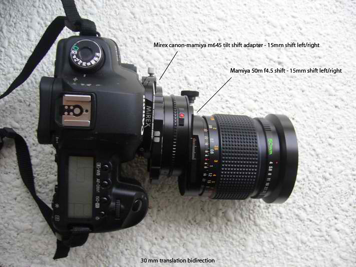

Here is the Mamiya 50mm f4 shift on my Mirex T/S adapter. Even though the lens is pretty heavy, the Mirex adapter holds it quite well
No automatic aperture on the setup which is to be expected really.
Light falloff is extreme at extremes of shift. Double shift with the Mirex to the extreme is not useable. Lens itself shifts 15mm to edge, the Mirex adapter makes another 15 mm shift giving a theoretical 30mm either ways which is huge. But practically speaking, I will only go up to 25mm max in total. I usually centre the lens unshifted and shift to the maximum on Mirex, then extend the shift on the Mamiya to add on if any.
Ok at f4, but shines at f8 +. For tilt at f4, sharpness is satisfactory, the 85mm f2.8 PC is a little better wide open
