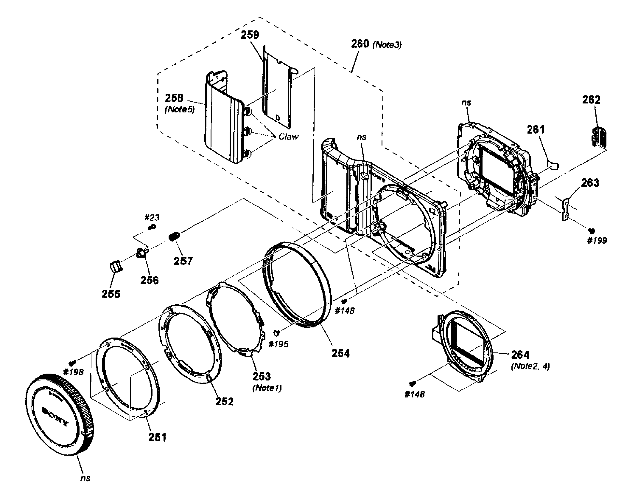

I have the same problem, F-- when zooming in/out, using NEX 5 with 55-210 lens. Sometimes with other lens too, but only like 5% of the time, with 55-210 it happened almost everytime.
After some google-research, looks like the only way to fix is to bring to Sony ... they will replace part of the mount on the camera.
If your camera is still in-warranty, you're lucky.
Mine is out of warranty, so I can only suck thumb :p
Thks Jennzhen, i've called Sony and i will go to have it fix. Will Update soon after :)
I believe the part to replaced is called MB Contact Unit(755).
See part number 264 below (link: http://www.searspartsdirect.com/par...arts/Model-NEX3KS/0996/0500140/50037220/00006).
The original part number was A1773802A, but subsequently has been replaced with A1876371B, maybe because the original component was found to be defective (just a guess).
The price seems to be around US$20-30.
