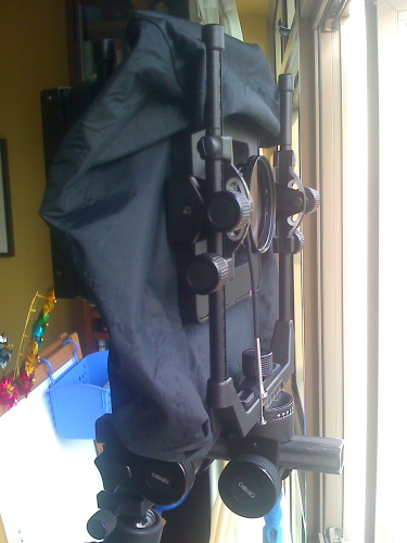

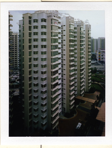

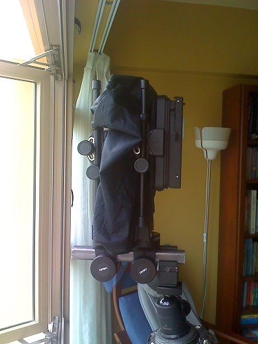

just received my wide bellow and a DIY shorter square rail.
and now, the buildings are straight :)

Is that light falloff at the bottom of the photo? :-) Now you need a center filter - more things to buy! :-))
yes, it looks like light fall off indeed, but I am not so sure... The ground level is really darker then the higher floors.
I need more test to confirm :)

What is the F-stop used to shoot this photo? Cause I mentioned about F22 being the test for most lens if not mentioned. 190mm+ IC is also tested at F22, wider open mostly have smaller image circle while stopping down pass F22 will have much larger IC. Even shifting the rear element can means closer to lens on one side as compared to another. Longer and short bellow also plays a part in the IC size.
thanks "bird" :)
the shot was taken at F32 and 1/8 sec if I remember correctly. I think there is slight fall off, but not too serious....
need more test to confirm...

good work on the DIY rail...i noticed both standards are in front the ball head. No front heavy situation?
I got a strong ball :devil:
