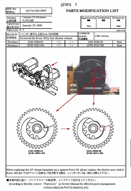

If you see the link I posted, the problem is related to a AF part and not the shutter. Hope SONY did changed the "design fault" part as well.
