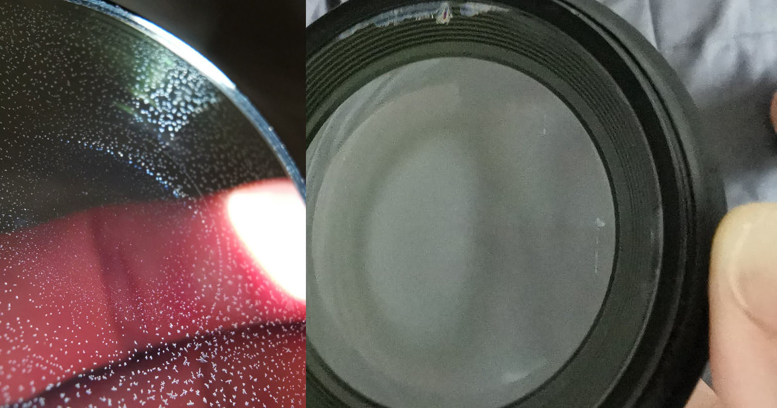

I recently had a bad case of fungus in a Sony kit lens. The fungus was between the two outermost lenses that are assembled together in a glued plastic case.

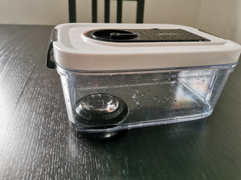

I placed it in a cleaned vacuum box with enough rubbing alcohol to submerge it — I actually had to tilt the box to cover everything, so I should have added more.
I first cleaned everything very thoroughly.

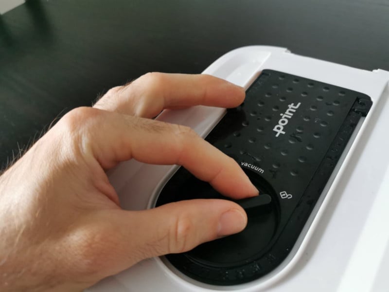

I sucked all the air out of the container and watched small bubbles leave the lens.
I then let air back in. Make sure the lens elements are fully covered with alcohol so that it can seep in.

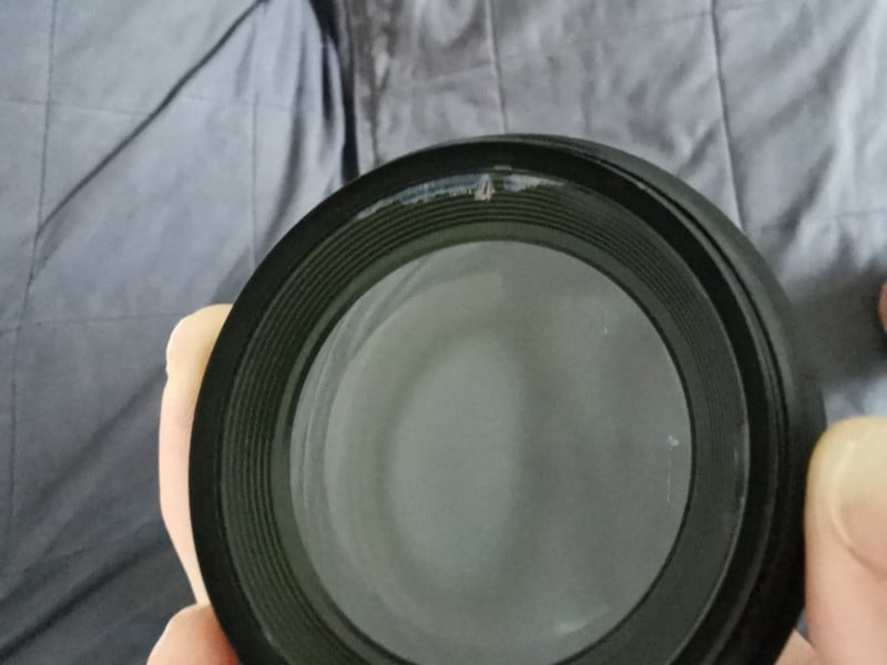

Alcohol between the lenses:
Now empty the box, put the lens back, and suck the air out. It almost all came out in the first go, but you may need to experiment with the orientation of the lens because the leaking hole needs to be below the alcohol.
The last droplet wouldn’t come out with suction.

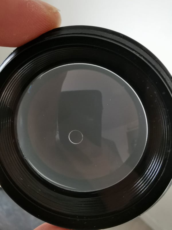

Now, this is a crucial step. If you just let the alcohol evaporate, it can leave a dried-out mark.
So here’s what you can do: swing the lens in your arm so that the alcohol creeps to the edge and then leave the lens to dry upright, standing on the spot where the droplet went so that it stays down there at the lowest point.
Voila! A fixed lens!
The stuff that’s seen on the outer ring is all that was left from the alcohol residue drying by itself. There’s no haze or any remnant at all on the rest of the lens.
After this initial attempt, I repeated the process a second time and ended up with a lens with absolutely no residue at all.
