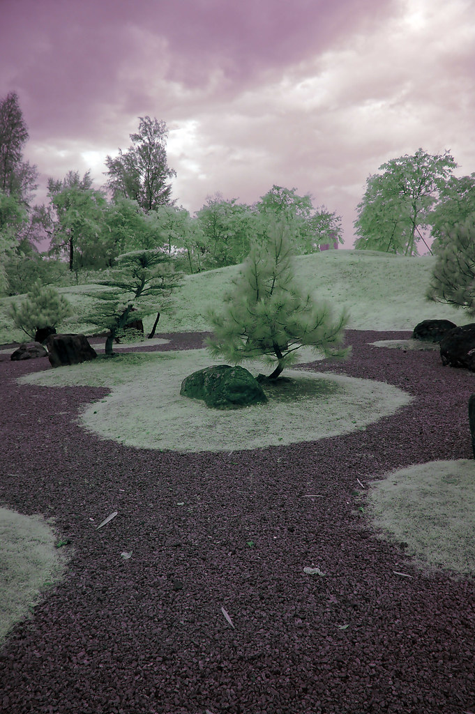

I had try on this IR photo without using the channel swap.
What I done is just use Replace Colour" under Adjustments. After that did a auto level and a surface blur.
The result as fellow...
Brother Lx3ChuA.
Great, man.
Really very good of you to demonstrate to us this Replace Colour method.
Honestly I have not used it before.
Like what JellyBelly has shown in his examples and now yours, I certainly think it's a good method.
And I will go and practise using this.
Thank you, Ah Chua!
