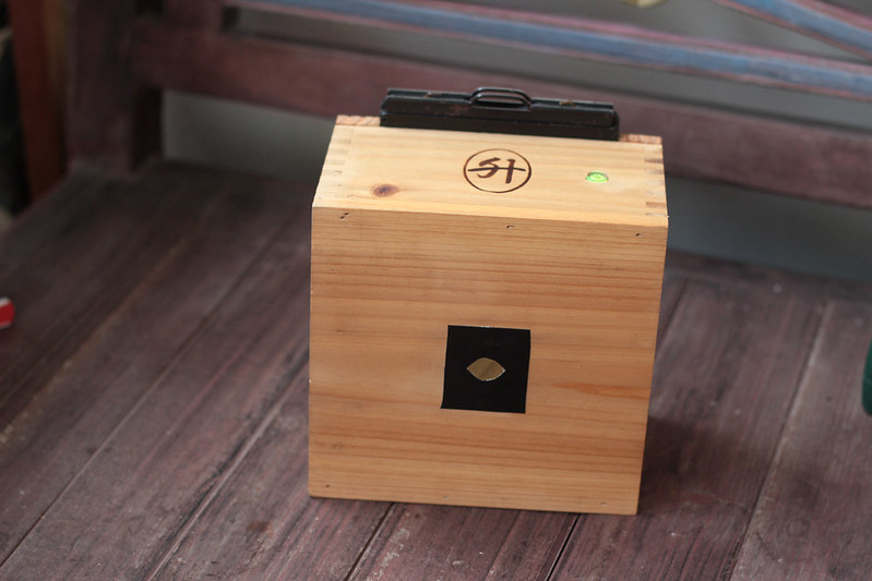

Here is a 4x5 pinhole cam made cheaply from a wooden rice measuring box from Daiso

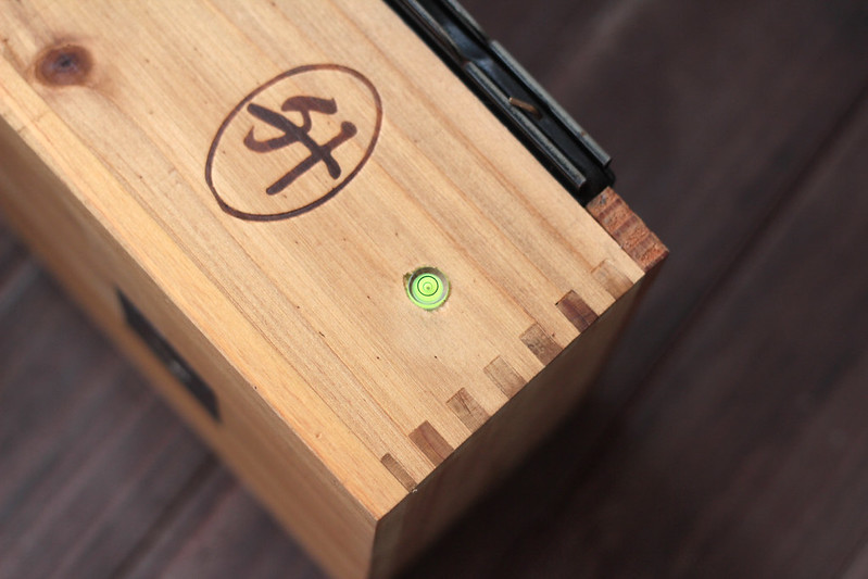

Drill a hole and put in a bubble level

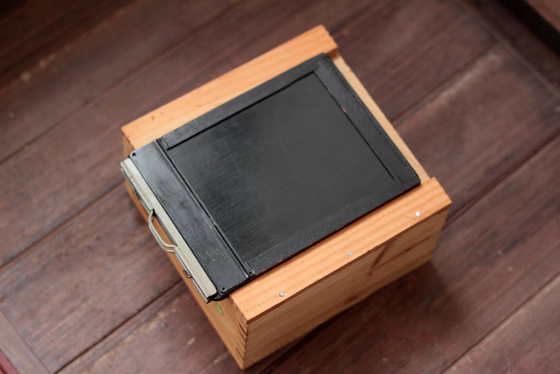

Glue or nailed 2 pieces of wood of appropriate width so that the 4x5 film holder sit in tightly.

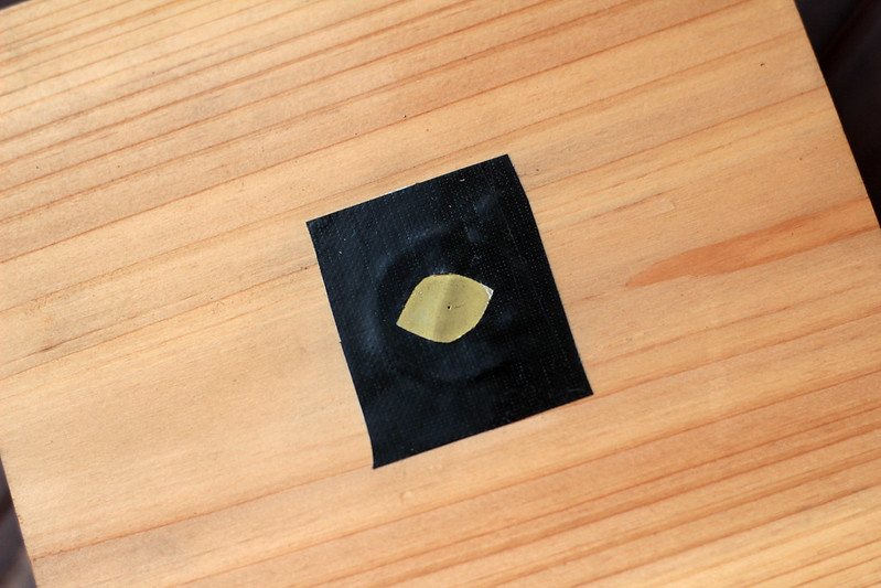

Pinhole is about 0.3mm on a thin brass foil. A hole is drill on the wood and the pinhole pasted over it using .....tape
Focallength is abt 90mm . therefore the aperture is about f300.
