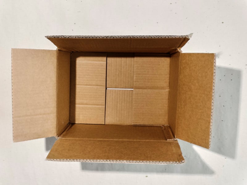

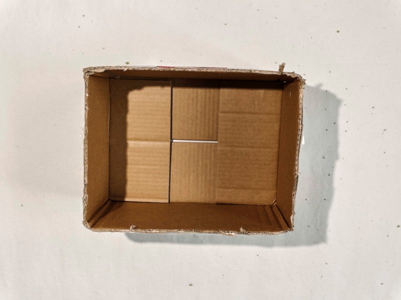

Step #1. Prepare the Cardboard Box
Take your cardboard box and cut off the lid flaps.
An ordinary cardboard box
A cardboard box with its lid flaps cut off

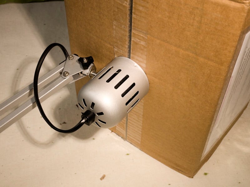

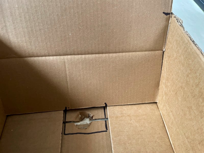

Step #2. Mount a Light to Cardboard

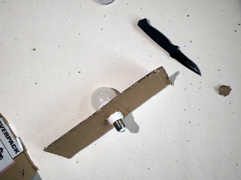

Create a hole in the back of the box so that you can fit your light source through it. In my case, I used a desk lamp and made a hole large enough to fit the base of my light bulb through. There are several ways you can hold your softbox in place. I was able to use the light bulb to hold the softbox in place.
A desk lamp pointed into a cardboard box
An LED light bulb stuck halfway through a piece of cardboard
For extra safety, you may want to use a hot glue gun or tape the light to the softbox. Bear in mind you may find it difficult to remove it afterward. If you choose to use my method, make a hole slightly smaller than the light bulb base, that way you will push through the bulb and it will hold in place fairly well.
It is best to use an LED bulb and not a filament one as they tend to get hot and your setup may catch fire.

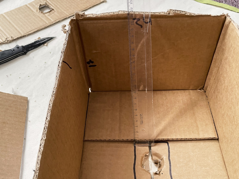

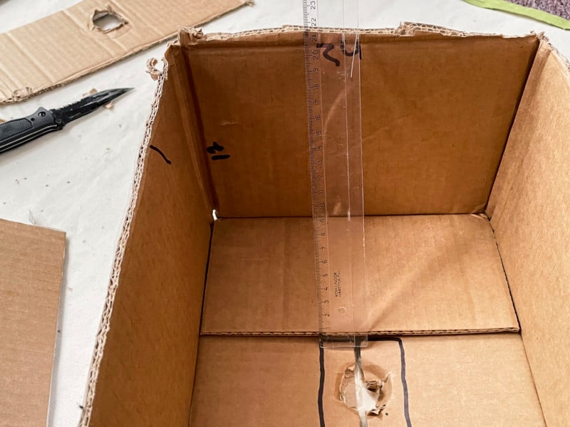

Step #3. Make Measurements on the Box
Now to make the reflector. As this requires measurements, it will likely be the most difficult step of this tutorial. You need to measure the width and length of your box. In my case, the longer edge was 12.5in/32cm and the shorter edge was 9.5in/24cm.
The next thing you need to measure is the part of the box where the bulb will be. I figured that an opening measuring 3in/8cm long and 2in/5cm wide would be sufficient. It is best to base your measurement on the dimensions of your light. Once you have that, measure the length from the corner of your box to the corner of your light source square.
Using a ruler to measure the dimensions of a cardboard box to turn it into a DIY softbox

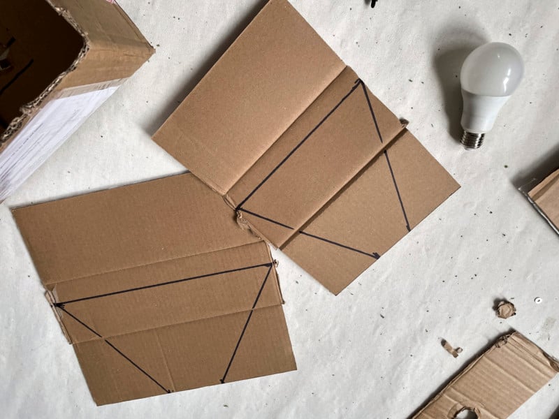

Step #4. Cut out Trapezoids from Cardboard

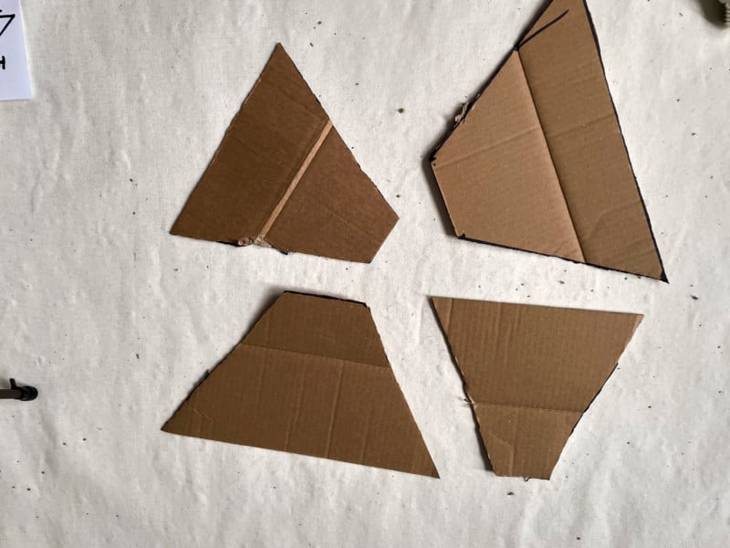

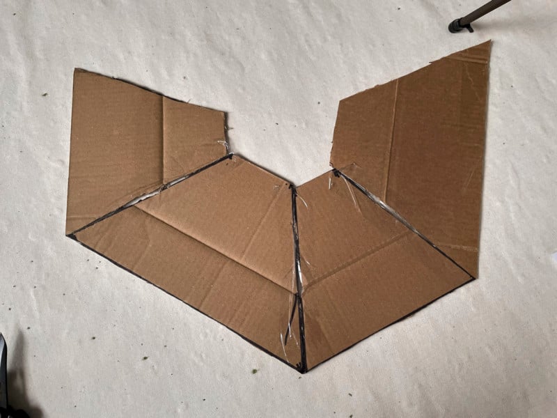

You will need to cut out two different trapezoids: one for the longer edge and one for the shorter edge. Take a piece of cardboard that will measure exactly the same as your longer edge and put it inside the softbox. Make a dot where the cardboard meets the edge of the softbox as well as a dot where it meets the light source square.
Measuring and marking a cardboard box for conversion into a DIY softbox
Then you want to connect the dots and cut out the reflector sides. Make sure that the slanted edges measure the same length.
Pieces of cardboard with lines where cuts need to be made

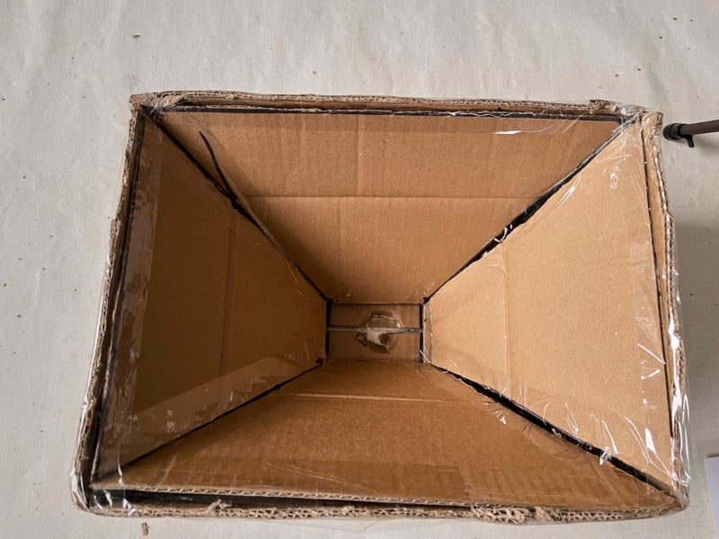

Cut out each side and tape together the four reflector sides and then insert them inside the softbox body. Now make sure to tape together the reflector and the softbox.
Cut pieces of cardboard to create the sides of a softbox
Taping pieces of cardboard together to create the body of a softbox
A softbox body created with cut pieces of cardboard

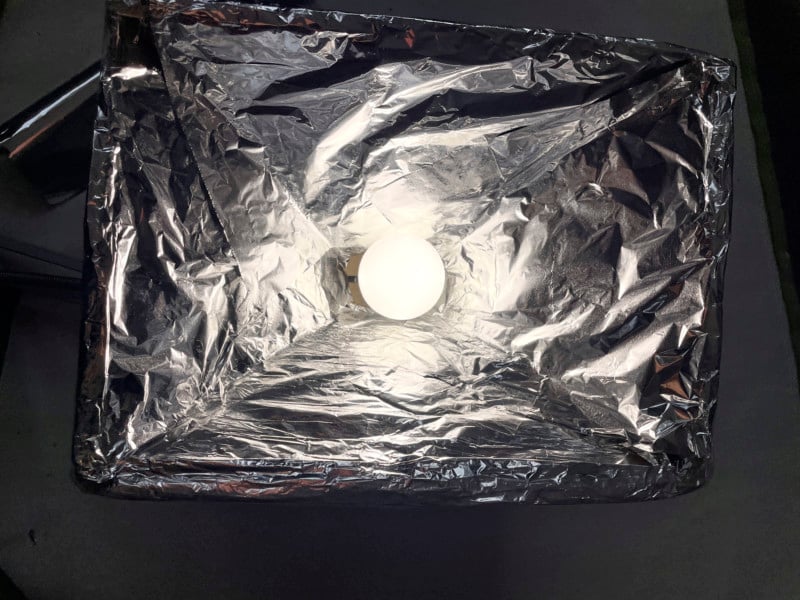

Step #6. Add the Aluminum Foil

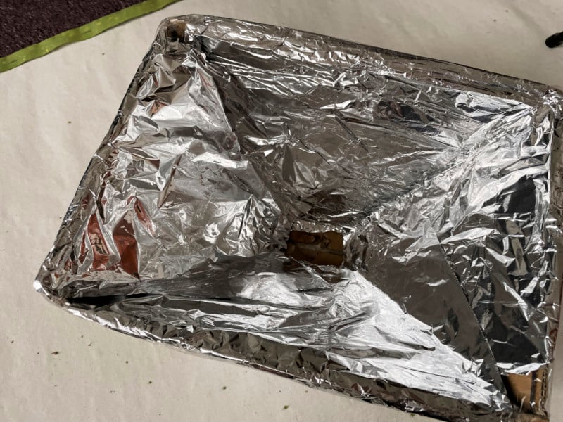

Now you want to put aluminum foil inside. I recommend not cutting it into shapes as it can be difficult. It is also okay to simply cover the inside of the reflector in aluminum foil. The aluminum foil has to be slightly crumpled so that it catches and reflects light in many directions. Make sure to use plenty of tape to hold the aluminum foil in place.
The inside of the DIY softbox lined with foil
A foil-lined DIY softbox with a light bulb inside

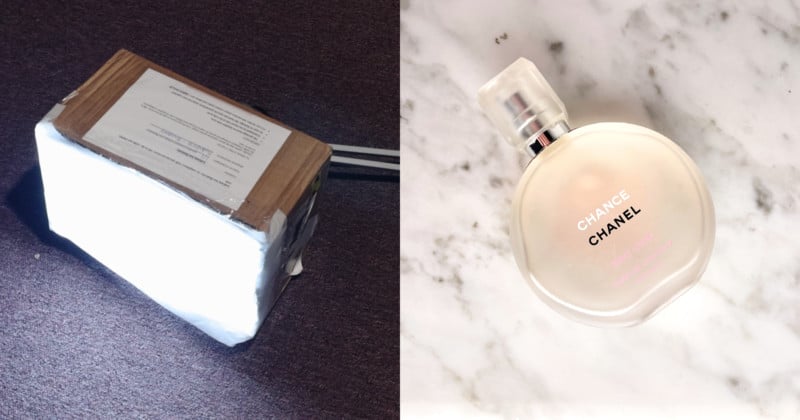

Step #7. Add Diffusion to the Front

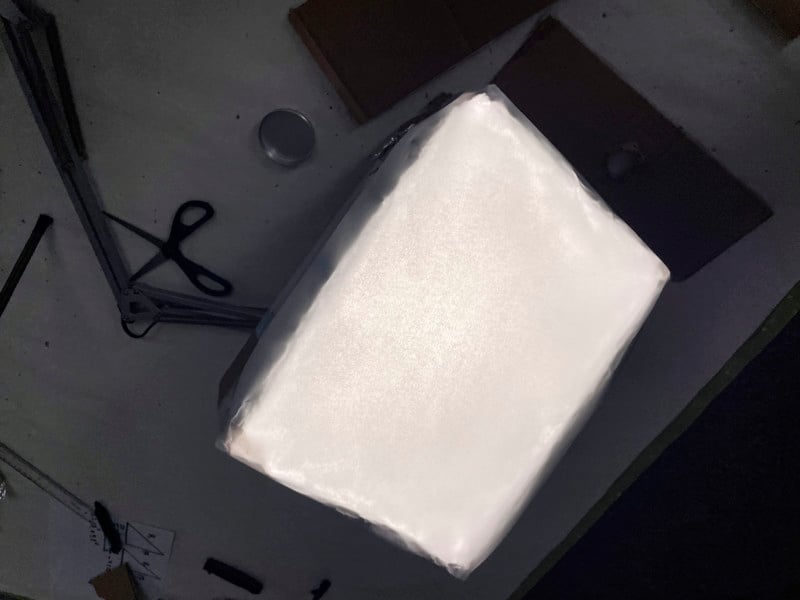

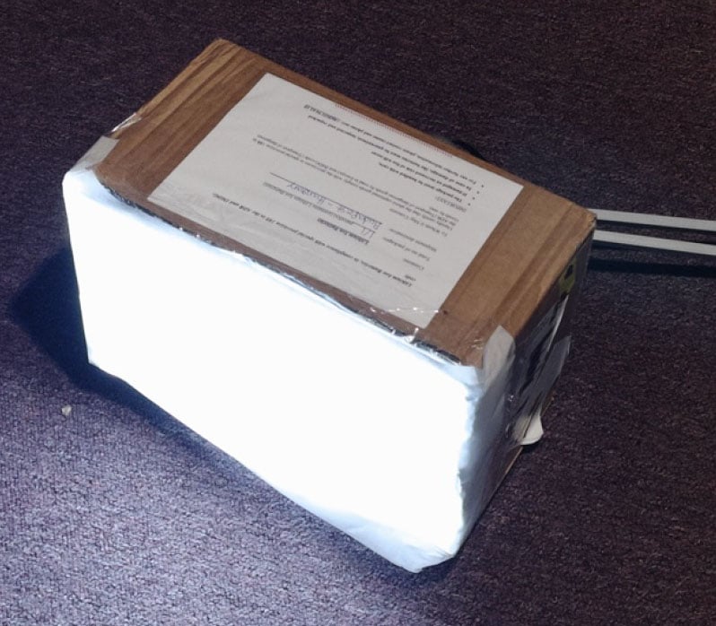

Finally, to diffuse your light source, you can put some baking paper (or any other diffuse material) on top of your softbox. This will even out the light. Remember that diffusion is not the same as soft light.
A DIY softbox with baking paper over the top to diffuse the light
Voila! The DIY softbox is complete!
The DIY cardboard softbox with the light on

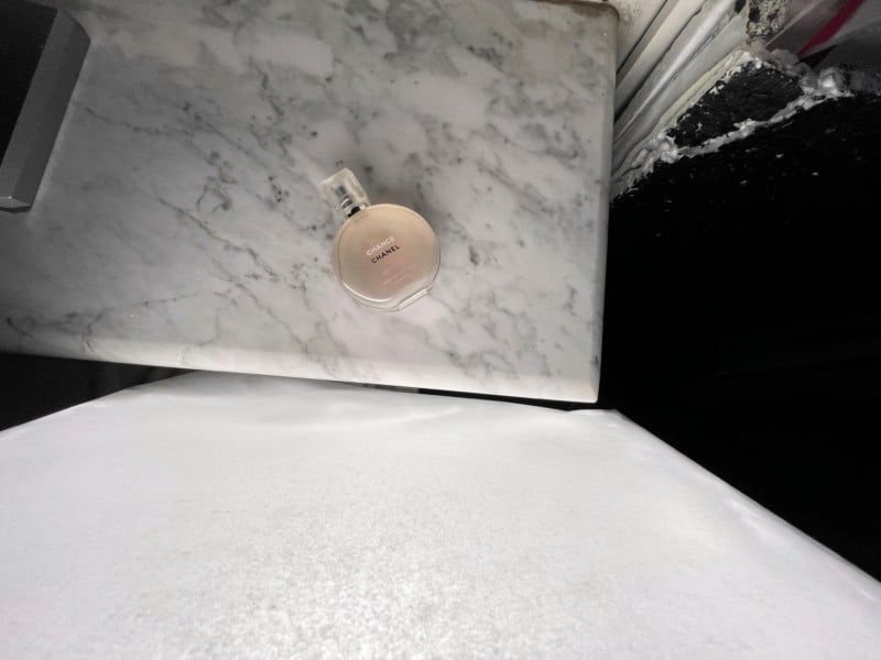

Once I finished building the DIY softbox, I took my iPhone and shot a few simple images with this setup. Here is a product shot I did with my new softbox:
A bottle of perfume on a stone surface
This is a simple perfume image that could be used for e-commerce. I noticed that the bottle lights up in an interesting way when the light comes through it, so I placed my softbox at the bottom of the frame to bring that out.
A product photo of a perfume bottle captured with a DIY softbox
