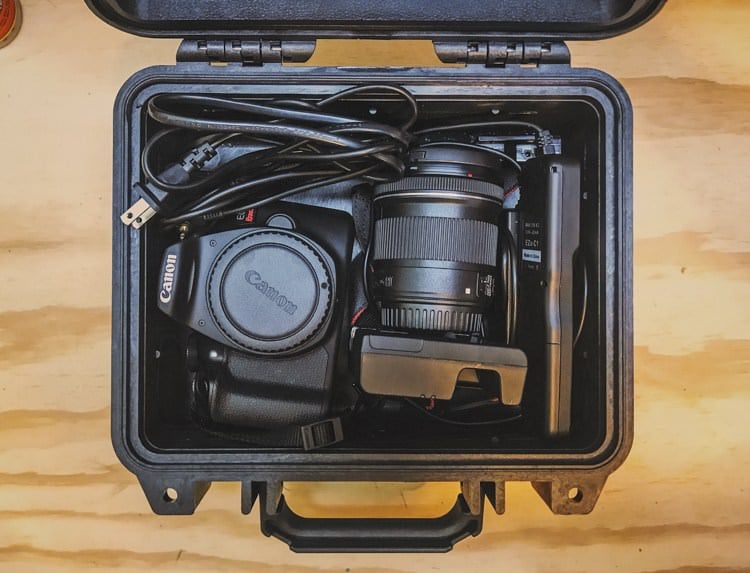

  1. Canon Rebel T6 DSLR
  2. Canon 10-18mm lens
  3. Pelican Case 1200
  4. Dummy battery for Canon T6
  5. Intervalometer
  6. Old heavy tripod
  7. Ball head (more on this later)
  8. 20 lb weight
  9. 3.5″ PVC Pipe
  10. 82mm UV filter
  11. Old lens hood
With the intervalometer and the dummy battery, we could leave the camera on, non-stop, capturing photos at timed intervals. The glacier researchers did one photo per day. We decided to do one photo per hour, with the thought that it would give us more opportunities to use photos to better show the construction process. If we wanted to do one photo per day, we could just use every 24th photo.

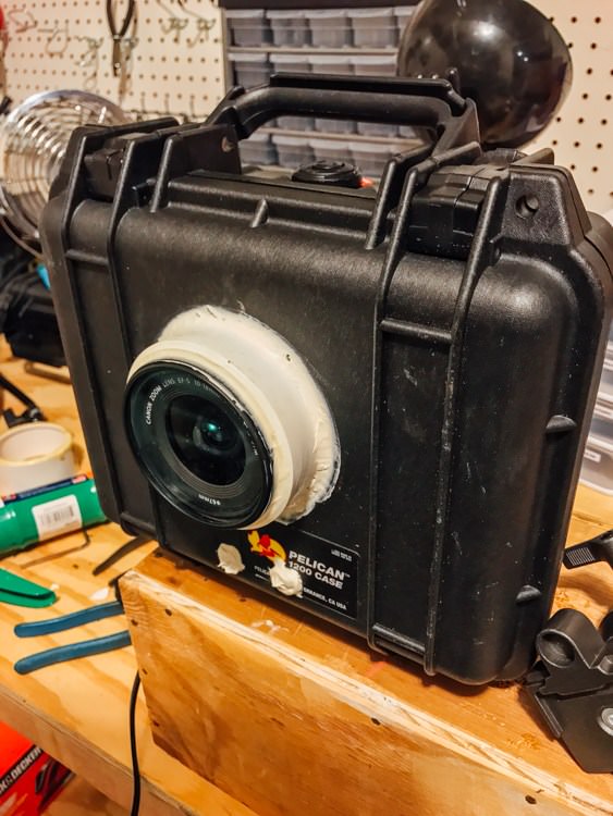

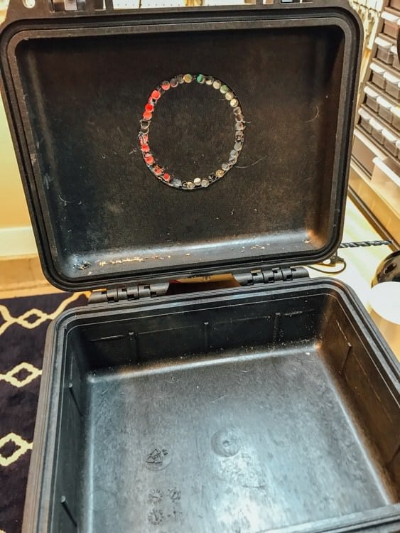

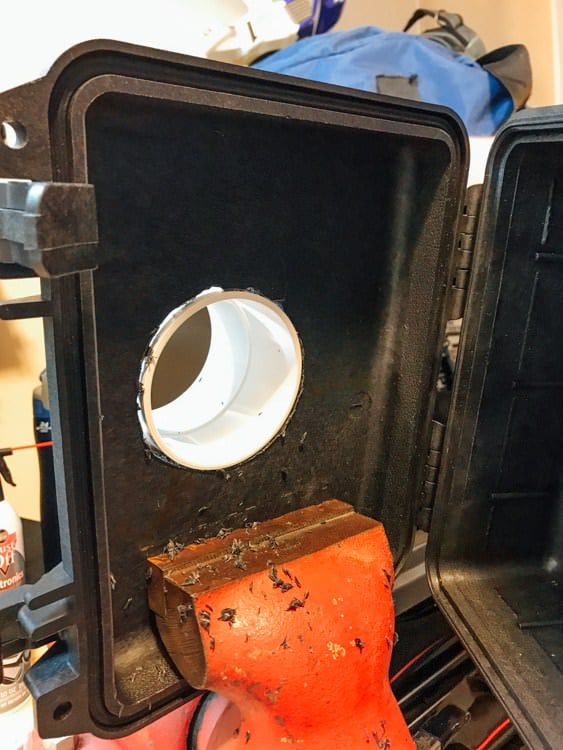

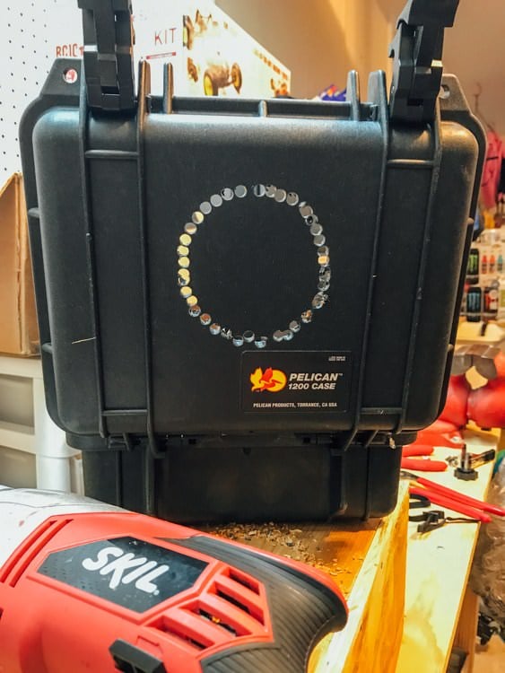

The first step was to install the lens port in the front of the Pelican case. To do this, I used a power drill to make holes in a circle to fit the 3.5″ PVC pipe, after marking where the lens would protrude out of the case. It had to be a tight fit, so this took some time. Pelican cases are not easy to “destroy”!
We were making progress!

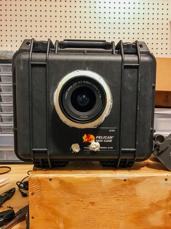

The next task was to seal the PVC pipe to the pelican case. I used Gorilla Glue to make a solid connection between the two. Caulk was then added to the seam on the outside, and hot glue was applied to the inside to strengthen the seal. The UV filter was added to the front and sealed with more glue and caulk.
Helpful tip: Getting glue on the lens of the filter will be hard to remove later. I covered the glass with masking tape until construction was complete.

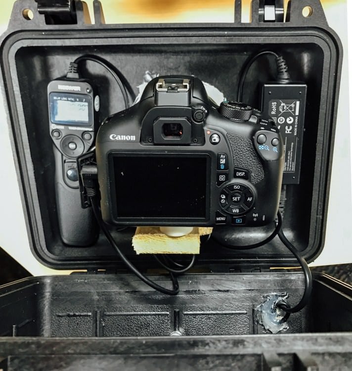

After the port was completely dry, we began working on the mount that would hold the camera in place when the case was closed.

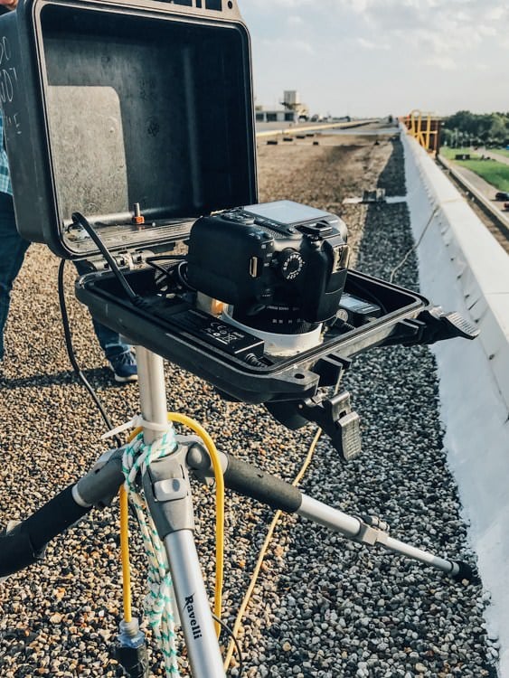

We used two steel L-brackets to hold a wooden platform in place. Both the wood and the brackets were just laying around in my shop, but they worked great. The two L-brackets were bolted to the front of the case through pre-drilled holes. These were then covered with calk to seal the holes.
In the center of the wood platform, we drilled a hole to insert a 1/4″ screw that held the camera securely to it. At this point, the camera was connected directly to the front of the case and was secure when we closed the case. We did a light shake test to make sure everything was nice and tight.
To connect the case to the tripod, we pre-drilled a hole to insert another 1/4″ screw down to a tripod baseplate. The ball head we used was one we had on-hand, but if I were to do this in the future I’d pick a more secure head. Again… more on this later.
The lens port was installed, the camera was bolted to the inside of the case, and the case was successfully attached to the tripod. The only thing left to do was drill a hole in the bottom of the case for the dummy battery cord. Again, glue and caulk were applied to seal the hole.
All of this took a few days, as we had to wait for different parts to dry before we could continue.
The intervalometer and the AC adapter for the dummy battery were both attached inside the rig via double-sided tape. Because of the heat that the rig would eventually endure, the tape’s stickiness would melt and by the end, they were both sitting at the bottom of the inside of the case, but it did not change the images.

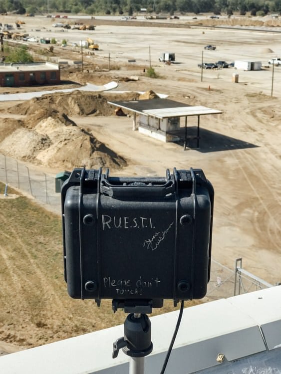

With the rig build complete, we set it up on the roof of the hangar, plugged it into a nearby outlet, and weighed the tripod with a weight to prevent movement from wind. The intervalometer was set for 1 hr increments, we closed up the case and … left it there for a month.
Processed with VSCO with a1 preset

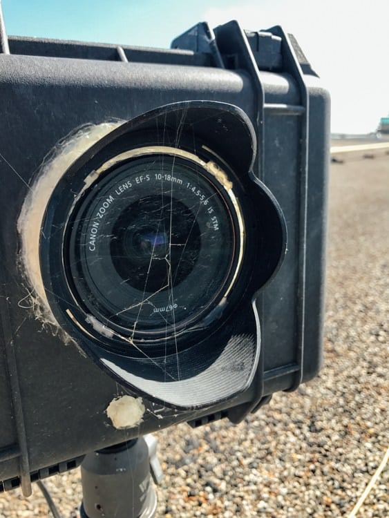

The first time we checked on it there was virtually no wear on the case and the camera was still working, but after a few more months we encountered cobwebs, bird activity, a scrap piece of paper that somehow found its way into the lens hood, and more. But… for the most part, the lens was clear of debris and we were getting good results.

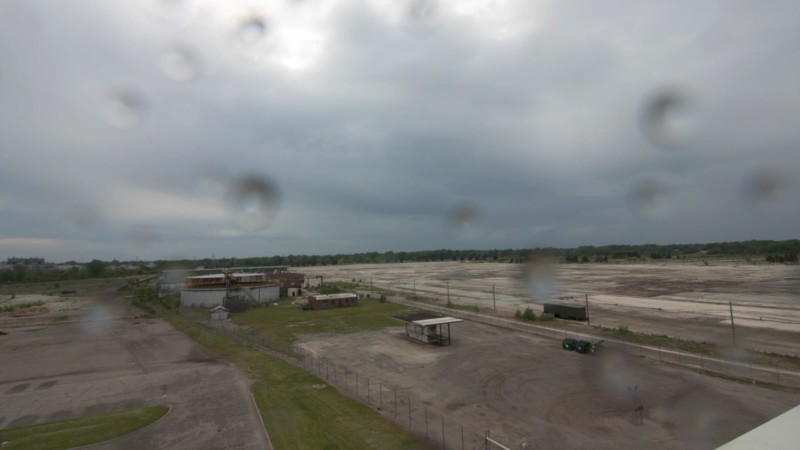

We had a lot of great photos, but also a lot of bad ones. Some with rain on the lens…

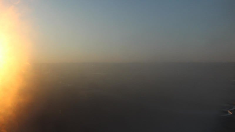

… and some with really bad visibility.
You can see by these preliminary results that the timelapse isn’t very good simply by stringing the photos together. This was going to take some careful processing.

One thing I would change is the ball head. Either wind or human tampering caused the camera to move a little bit. I would use a more heavy duty head to prevent this.
