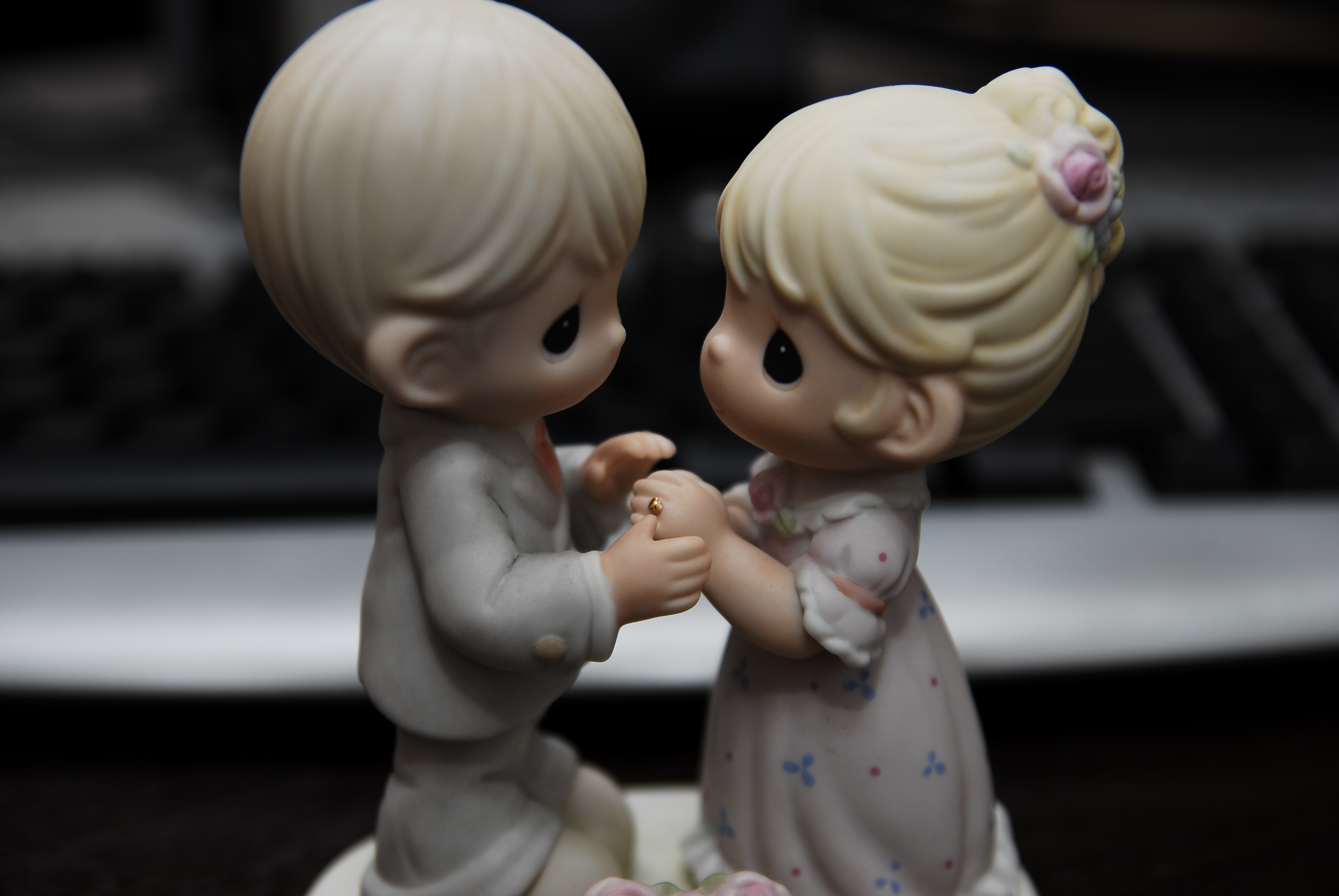

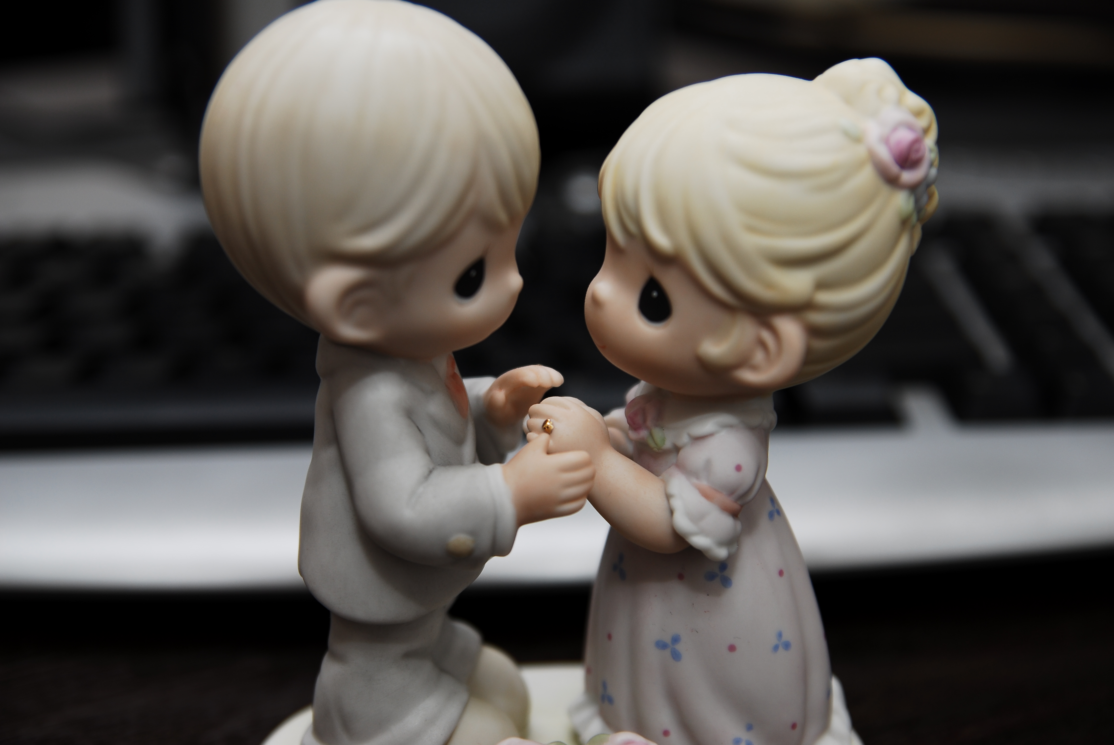

Hi Humble Only CSers,
I also came across this website claiming that the Tamron A16 lens report the wrong focal distance to the camera in TTL-BL mode therefore causes over-exposed issue.
I did a small test to confirm it's claim and would like to share with all humble-only CSers here :bsmilie: I have also used the same ExifTool tools to ensure consistancy with it's claim.
Test equipment:
Camera: Nikon D200
Lens: Tamron 17-50mm SP f2.8
Flash: Nikon SB-600
Focal length: 50mm
Focal distance: 45mm
Aperture: f3.5
Exposure: 1/60s
ISO: 100
Flash mode: 1 shot using TTL and 1 shot using TTL-BL
Shot using TTL - download image
Shot using TTL-BL - download image
Here is the link to both images with full EXif.
Both files reported similiar focal distance at 45mm from ExifTool and I dun see any over-exposed issue. If you really wants to verify, you can copy this 2 image and download the ExifTool to check for yourself.
Again not all Tamron has this issue :nono: If any bros or sista really encountered over-exposed issue, I really feel sorry for that. I suggest you may want to do a test to confirm if it's wrong focal distance causes it. I would have turn to the agent to insist a swap to a good working lens else full refund if this had happens to me. Just me 2 cents.
I'm still supportive to Tamron and this A16 really serve my needs other that focal length limited to 50mm. I'm also keen in their 28-300mm VC, can't wait for the release for Nikon.
As said, I'm just here to share and not to justify for anything. Just that I cannot tahan one bamboo beat one boat of people (in chinese la) hahaha........
Please do not ask me to verify anything further as I'm not keen to do so. It's all up to your own judgement and believe. I'm only doing a little test hope to benefit your guys here.
Thanks and take care.

hmmm... you shot at 50mm, focal distance 45mm? is that the MFD (minimum focussing distance) of the tamron?
Oh yeah. you shot the SB-600 bounced is it? Could you try direct flash? (I dun need exif lah.. I believe you. Anyway your pics here have been metascrubbed, aka wiped clean of exif info :bsmilie:)

I know focal length and distance are different thing otherwise I would not stated there.:bsmilie: I indicated the focal distance because there are reports claims that the len report wrong focal distance to the camera therefore causes over-exposed issue when using TTL-BL flash mode. If you download the images and the EXifTools, you are able to view both images report similiar focal distance. You can read from the link I posted above.
Please la, dun ask me to test again since both the images proven there's is no issue with the lens. By using direct or bounce does not resulted in the lens reporting wrong focal distance so I dun see a need in that. If it really does, then it is cause by the flash :bsmilie:
BTW, I have added the link to download the images with full EXif, you can download them and use EXifTools to view them if you like to. Cheers.....
There is a difference. When you use TTL-BL with direct flash, then the distance reporting is of paramount importance. It is with TTL-BL and direct flash where the erratic behaviour appears.
Yah. he explained what I was lazy to say.
You know how to check image-focal plane difference? You have to use another lens to get the 1st accurate reading. Then, you use the Tamron to get a 2nd reading.
If both readings show a difference in subject-camera focal plane difference, that is the true, and correct test. If both readings show roiughly the same result (give or take a few mm) then I have to say your Tamron is correct.
Right now your test.. I have no idea how you conducted it. Seems like it was with the same lens all the time. TTL and TTL-BL will not affect subject distance-focal plane readings. The only way you will know the CORRECT subject-focal plane distance is with another lens. Then you can compare with your present Tamron. The other lens, in science, is called a "constant".
Anyway if you are happy with your lens good for you.

At first was claimed that this lens has problem when using TTL-BL, so the test was to compare both TTL against TTL-BL and both reported identical. Now becomes comparing with another lens and I think it is never going to end. Even if 2 different lens reported different focal distance so which is correct? To me, as long as I don't have over-exposed issue be it using whatsoever flash mode, I'm fine. I'm going to stop here and will not be doing any further test as mentioned earlier. I think it only fair that individual to select their own preference. Cheers....
