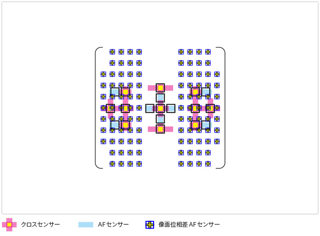

If im not wrong. According to the introduction A99 video. A99's PDAF green box is smaller than this? Seems to be even more centralize at the center than this.
Indeed, like the NEX-5R and NEX-6. But unless those two the A99 doesn't have any on-sensor PDAF points vertically in the center. Here you go:
Btw the on-sensor AF points will only work with 6 lenses (SAL2470Z, SAL2875, SAL50F14, SAL300F28GII, SAL70400G and SAL50050F4G) for the time being and I guess they will never work with any 3rd party lenses.
