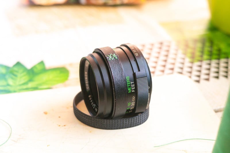

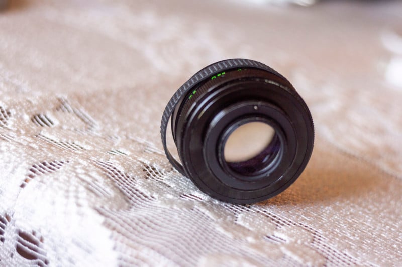

I just recently purchased the dirt-cheap Cosinon 50mm f/1.7 lens (shown above). The lens works flawlessly, but the rubber ring was loose when I purchased it.
I think a lot of you know the above sight all too well because it’s a problem that literally every lens with this type of ring meets sooner or later: with time, the rubber stretches, gets loose, and sometimes turns gray-white due to micro-cracks and dirt. Sometimes it loses its strength and splits in two or simply falls off.

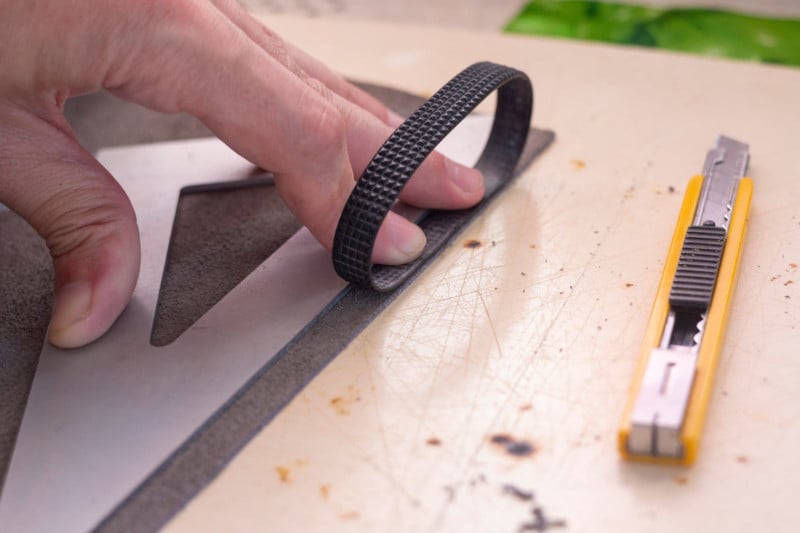

First, cut a strip that’s the same width as the rubber:

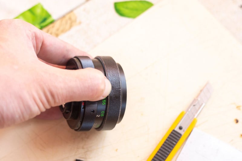

Next, carefully cut it to length. If you want it to sit as tight on the lens as possible, cut it 1 mm shorter. The leather can stretch a bit, so you’ll be able to put it on the lens without any problem.
Either glue it like this (I have no idea what kind of glue to use, though) or get a needle and strong thread and sew it.
It’s best to make holes first (takes a bit of force to push the needle through) and put the thread through them later. The type of the seam and the color of the thread is up to you.
If you have the skills or know someone who works with leather, you can easily achieve a better result. For example, you can make the stitches flat, stamp a pattern for better grip, round the edges, make some embroidery (e.g. your name), etc.
