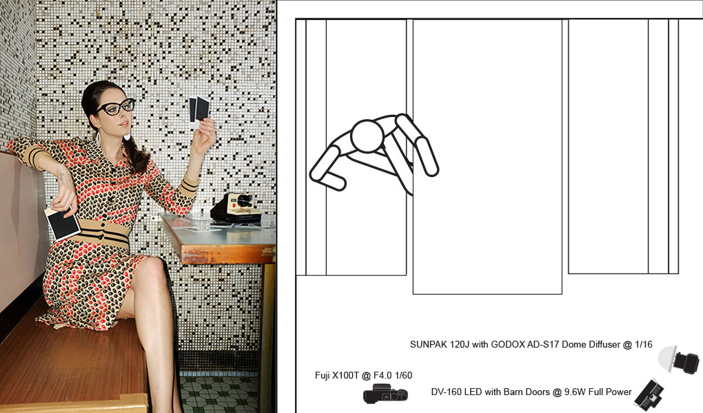

Hi all,

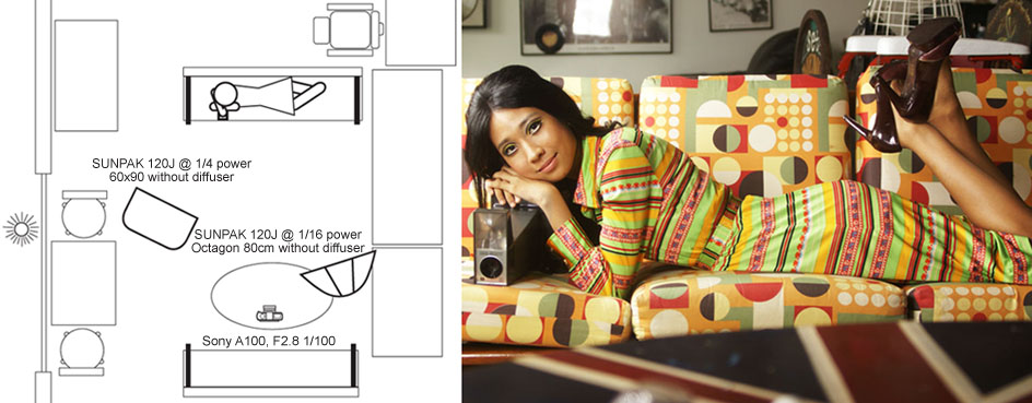

Below is one of the light setups from Polaroid Gals #5.
Simple 2 lights - main left fill right. You can actually see the 60x90 softbox catch light at one of the background photo frame. And if you look carefully at the sneak peek pic, you can also spot the 80cm Octagon. Technically, I can PS away the catch lights. I choose not to do so, as I am okay with imperfections in my photos. Model is CoCo, an affable and brainy model who has an unique "universal?" face that makes her almost a perfect fit for all types of shoot.

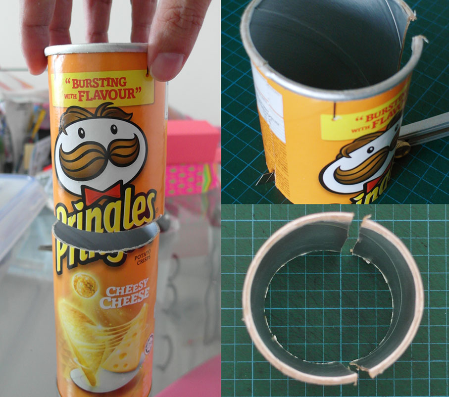

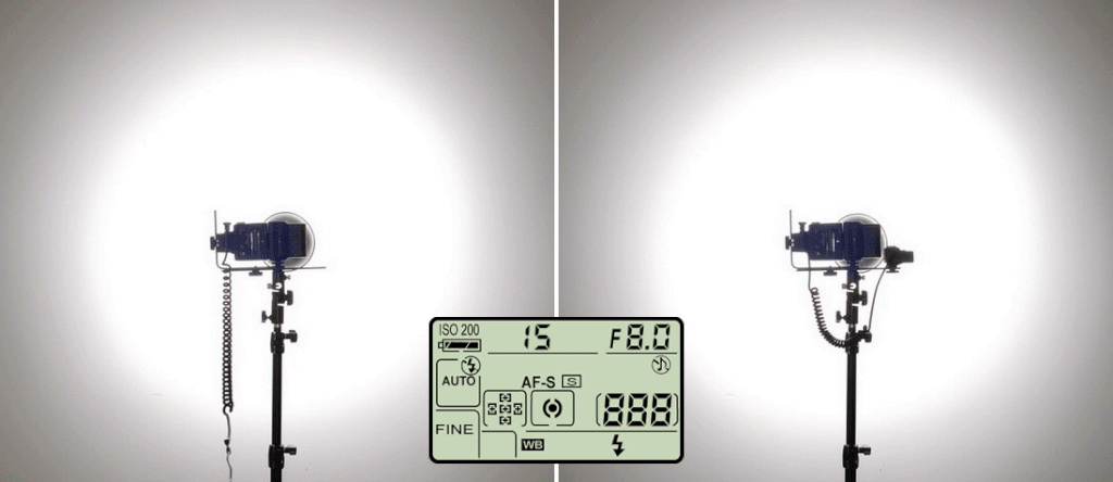

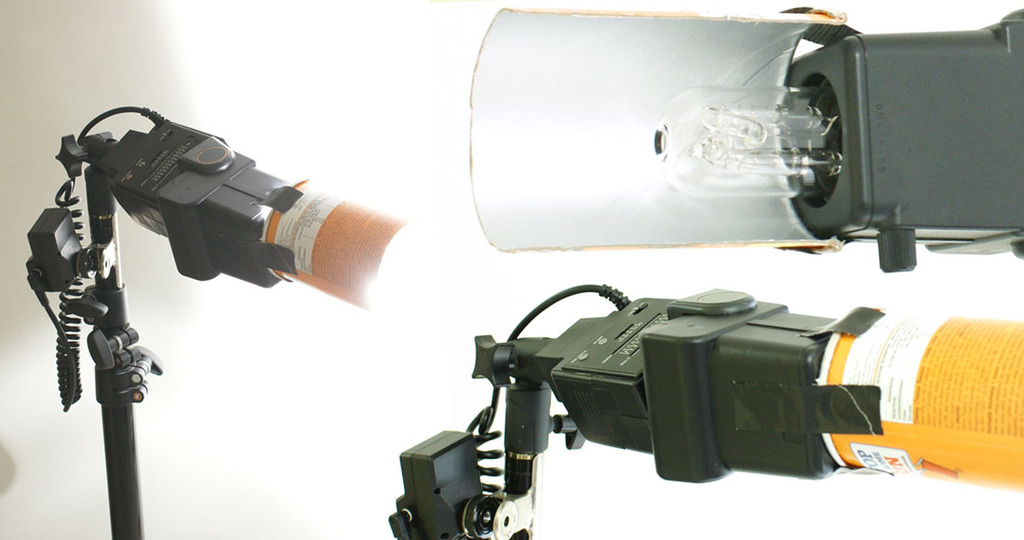

Hi all, it's been a while I share another mini tip. This is a cheap DIY modifier project that is fun and tasty to do. It took me less than 15mins, excluding the time spent eating up the whole can of chips.
As mentioned before SUNPAK 120J has very few accessories or modifiers. 120J owners however can solve this problem which I had shared as a mini tip here. One of the very interesting light modifier I talked about is the Quantum QF-62 Bare Bulb Light enhancer. It enhances the light by 1 or 2 stop and it's great for doing high key background. The problem with the QF-62 is that it is a bit tight fit for the 120J and a new one with shipping cost about S$84-95. So I decided to DIY a cheapo light enhancer and see whether it works.
Spoiler alert! It did work. And I called it “The Potato Chips Light Booster aka The PC Booster”.
Minor note: Most of the images was shot with Sony A100, WB at Cloudy so the images a bit warmth. The Potato Can DIY images shot with Samsung EX-2F WB auto.

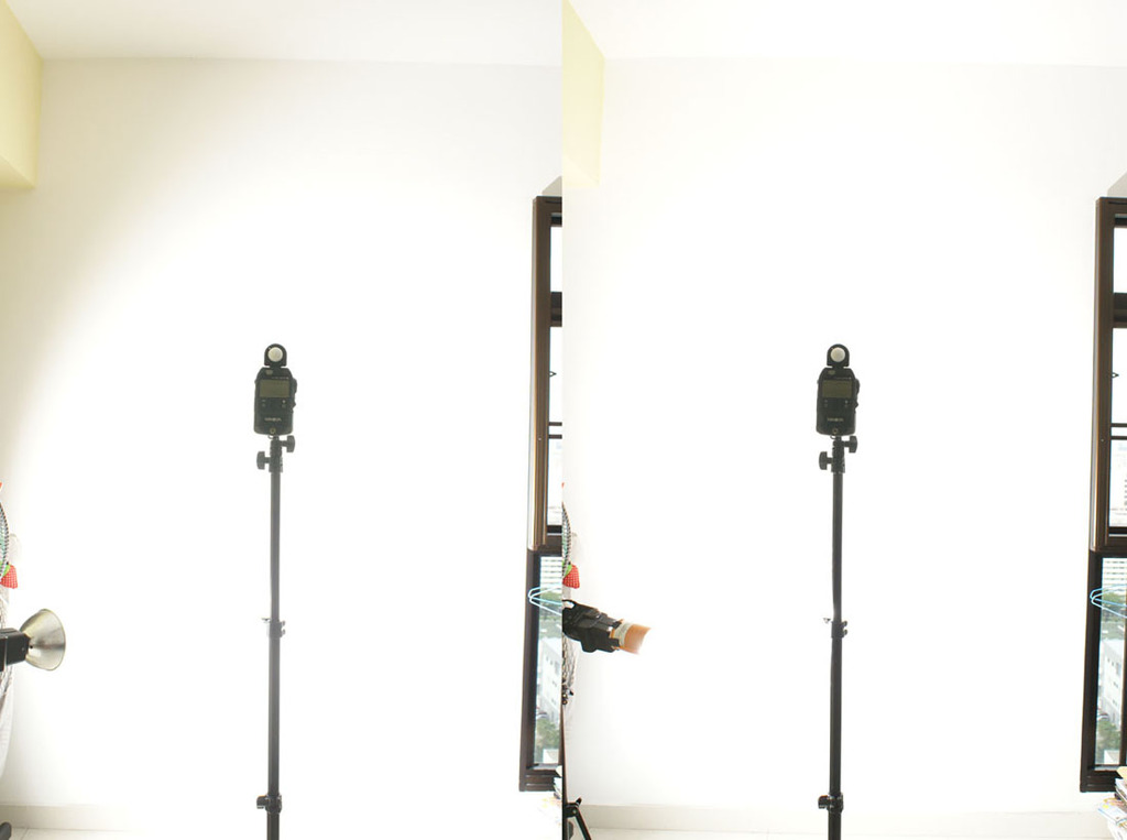

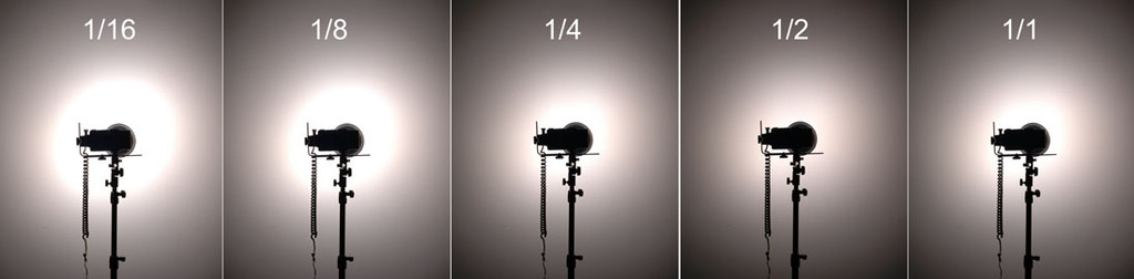

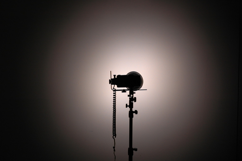

First image ¼ power 120J bare bulb aiming forward. Distance from the bare bulb to the wall is about 80cm ish. Got very close to a F8 reading. Second image bare bulb facing upward and I got a exact F8 reading...hmmm interesting. Third image 120J with the PC booster. Oh mine, one more stop of light at F11. Last image, 120J with original hood @ wide position give the most light boost at 2 2/3 to 3 stop more compare to just bare bulb alone.
The DIY process is fairly simple, by just using a pen knife to cut out the desired reflector shape. I am not sure about the optimal angle or height. Maybe there is, but it will take some time experimenting. The one that I did seem to work just fine. The height of the booster is about 9.3cm and the cut is made @ 4.5cm from the edge of the circle.
It's definitely not a looker as I just use gaffer tape to secure the PC booster to the 120J. Now to get 1 more stop of light from the booster, the gap between the bare bulb is quite important. The reflective surface must be very close - about 2-3mm. Anything further it will just produce at most 1/3 more stop. I am not sure what is the exact science physics behind this? I will try to do some research and ask around. Science is definitely fun and cool to learn.
Now, did I try using the “lesser half” booster? Yes I did, surprisingly it only produced a meter reading of F8.04. I also tried wrapping aluminum foil to the booster, first smooth foil surface and than crumpled foil. Surprising both foil surfaces produced a F8.08 reading... Strange? I think I need to do more testing to double confirm. Technically speaking the reflective/crumpled foil should do better than the matte silver surface of the booster.
Side by Side comparison. On the left we have a 120J with hood, distance from the light to the wall is 1.5m ish. The 120J with hood which produced 2 ½ stop more light even manage to blow up the ivory - colored wall tile skirting. However the background light distribution is not as even and the strong back light have started to bleach out the light stand. We can solve this by pulling the 120J away from the wall to give a more even coverage and the light stand a bit further away from the background to reduce the light bleaching/bleeding. On the right we have the the PC booster, with a distance from the wall is also 1.5m. The PC booster gives a more pleasing and even background light coverage and the light bleed is not so bad compared to the 120J with hood.
So what is the benefit of using the PC booster? I think the DIY PC booster work much better in tight spaces like home studio environment doing ½ or ¾ portrait. That's about it, hope you guys and gals find it useful. Lastly, Thanks for the kind comment from tory_felicia.

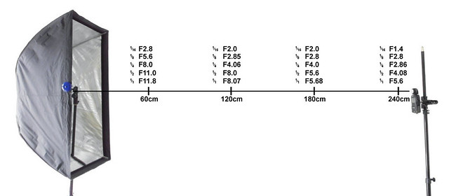

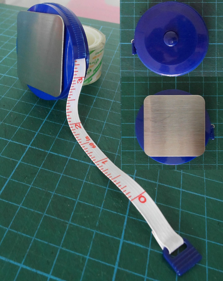

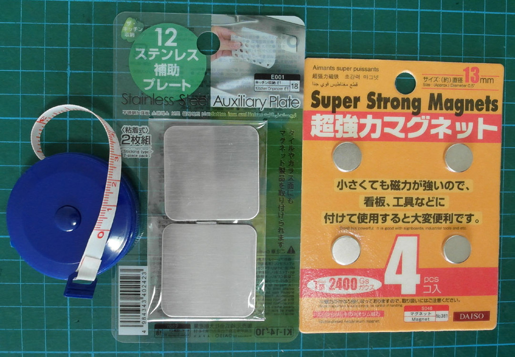

LMT2.0: A 1.5 meter fabric tape measure, a piece of stainless steel metal piece (ferritic) and some strong magnets. I bought the fabric tape measure at a Pasar Malam for S$0.70 each. And the metal piece thingy and strong magnets at Dasio (Plaza Sing). I prefer the fabric tape over the metal tape because I can easily write on it and it is almost feather light. The negative part is that the fabric tape is 1.5m max.
Putting all together is a no brainer. The stainless steel plate already has adhesive pad stick to it. Stick the plate to the tape measure and we are done. Simple.
Now this step is more complex, and you will need a flash meter! Wait, but I don't have a flash meter? Well, go borrow one from a friend or go rent one. Now if you have a good buddy who is wiling to help, it will be easier and faster. If you are doing solo, you will need 2 light stand, the light modifier with the flash you always used for your shoot. For strobist who used multiple kinds of modifier, my advise is to take each modifier with its own reading. You will be surprised that a Softbox and a reflect umbrella will differ greatly especially when you pulled it further away from the subject.​
How to use LMT2.0: ask your model to hold the tape front @ nose level while you pulled away your light modifier from your model until the distance and the coverage/Fstop you want to shoot. Pressed the retract button and tape will slip back cleanly. No rope laying around. If you are shooting at the right ISO you should be spot on or very close to the exposure you are looking for. Now on a side note, this does not work well for group photos or you are using more than 1 light.

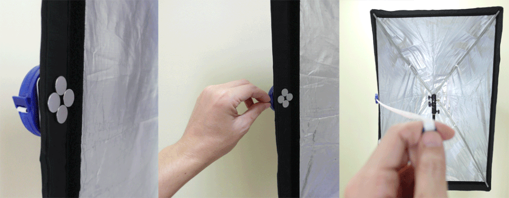

MiniTip #4 Cheap DIY Reflector and Reflector Holder

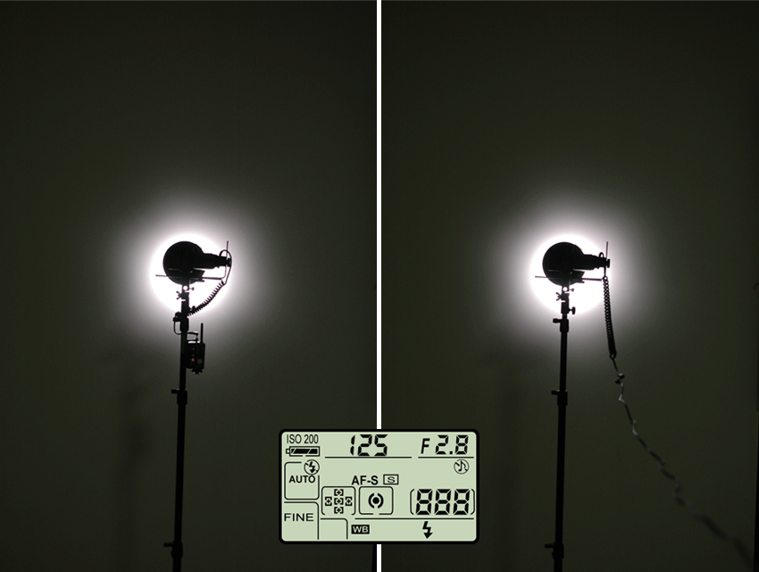

Is there anything that can surpass the Pocket Wizard in flash/X sync speed?
So far I have tried the Cheap PT-04 which was a draw @ 1/1250; the 433mhz Aperture got knocked out black by PW @ 1/800 sec. Instead of trying another radio trigger, I am trying something different - PC sync cable. And it is going to go against the PT-04 which is also a very cheap option and sort of an old radio trigger.
PW triggered hot shoe camera flash by transmitting radio-frequency from a transmitter to a receiver. PC (Prontor-Compur connection) sync cable triggered flash by short electric pulse/flash traveling through a cable/cord from one end to the other end. It is very old tech since the 40s? that have S, M, F mode which I am not going into. The X Sync started to appear on cameras like the gorgeous Nikon S2 in 1954 so it is more than half an century old tech.
Instead of using one very long PC male to household single cord, I used a 5m PC sync extension cord - one end attached to a cheap hot shoe with a PC sync port and the other end link to the SUNPAK sync cable.
The result is surprising, I know that it will most likely surpass the 1/1250 speed as David Hobby already did it. What surprised me is that it went way way above @ 1/8000. Of course as you notice when it went passed 1/4000 the color shifted but it still managed to capture the flash with no black strip.
Impressed by what I get, I proceeded to test the insane 1/8000 sec at all power setting. The Nikon D70 captured it without any black strip. However when I looked at the images on my monitor, I noticed something strange and it made me wonder why? I am going to do more further testing next month and try to figure out what it is. I will also be testing the 1/8000 at real world scene and see if the color shift will greatly affect the image in a negative way? So stay tuned for coming update.
If you want to verify the image by checking the EXIF data, feel free to save the image above and see for yourself. I only did a 50% re-sized; nothing else. The flash is @ ½ power. No black strip. It's simply super impressive. (minor note: the black line on photo right is a gap between a wall and a cabinet. It is not the off sync black strip)

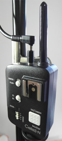

Why Godox Cells II? If I was looking for another more powerful flash to replace the 120J, Godox AD-360 most likely will be no 1 on my shortlist. To trigger AD-360, I will need to buy FT-16 which includes a trigger and a small USB receiver. The FT-16 trigger has the ability to adjust power setting which makes it so so convenient when on location. However FT-16 does have its downside, it is made to work exclusively with the AD180/360 and AR400 (ring flash). So what if I want to add a 120J into the picture? The FT-16 does not have any hot shoe/PC sync/3.5 port. To make it happen, I can use Cells II (transmitter mode) to trigger the FT-16 receiver (with no access to flash power setting though). Strangely, I cannot find any confirmation that the FT-16 transmitter will fire the Cells II in receiver mode. I think I will only find it out in the future...
So do I like the Cells II? A few small yes and a BIG NO... I will post a personal mini review below and share what I thought if you are interested to find out more. When I first took the Cells II out of the box, the first feeling I got is “awesome!!! this is going to rock with my SUNPAK 120J”. Sadly, that awesome feeling was gone when I did a sync speed test.
The Cells II blacked out at 1/500 when in manual mode? :o WTH!
Not sure what happened? Maybe the GCII was designed to work perfectly with Nikon HSS. If it is set to plain simple camera manual mode, the GCII complex/smart circuitry get confused (maybe?) and limit the sync speed to 1/500? I tried switching between the 3 sets, different channels, mount the GCII onto an external single pin hot shoe then mount onto camera. All with the same result.
Any ways to overcome the 1/500 sync speed? My guess is I can try FT-16 transmitter as it is only single pin so no TTL no talking to the camera stuff. But as mentioned before above, I cannot confirm that the FT-16 transmitter can trigger the receiver mode Cells II?

1. Big bummer as it blacks out at 1/500, my Aputure Trigmaster best it @ 1/800 and my old and cheap PT-04 @ 1/1250
2. Sometime the GCII will not fire on my Nikon D70? I have to switch off the GCII, remove it from the camera, reinsert back, on it and it will work? I suspect the TTL/HSS communication is causing this.
3. If using the original SUNPAK sync cable, you have to buy a PC Female to Miniphone Adapter or a Pocketwizard MPCF/ MPCF-L.

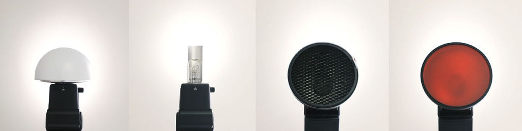

from left to right: Godox AD-S17, Godox AD-S18, Godox AD-S11 Grid and Color Gel (update to mini tip #6)
I bought these last year in Hong Kong. Godox AD-S17. Not sure if I will ever use this but I think it can be a good modifier acting as a diffused omni light to background. Godox AD-S18, this is the same as the Quantum QF-62 light enhancer I talk about from #7 The PC booster. This one fits perfectly with 120J. Godox AD-S11. At first I thought I it comes with a hood as a set. Apparently it just consists of a grid and 4 color gels.

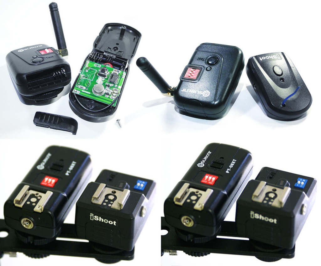

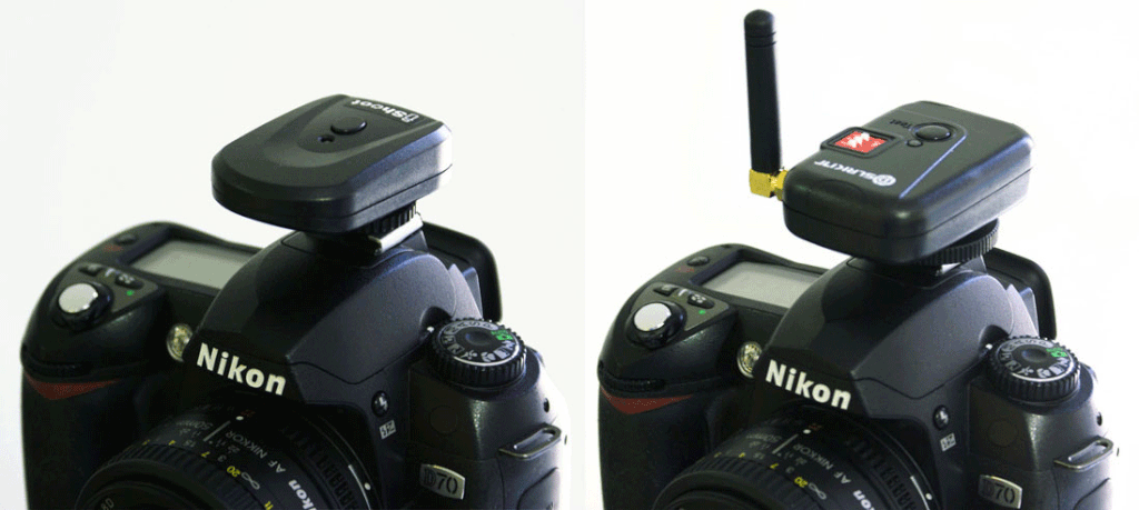

Hi all, as mentioned before on thread #133, I was a bit disappointed with the Godox Cells II. It is a good and feature packed radio trigger but the max flash manual sync of 1/500 is a bit lacking for me. So I went about looking for another trigger which will replace my old PT-04. After surfing through the interweb for days. I found something interesting - DSLRKIT PT-08XT, a sort of PT-04 upgrade version in looks and range(?). I ordered it, and it reached me about 2 weeks. Did it impress me? Oh YES it did, and here is my review.
The 08XT trigger excluding the antenna is roughly 10% bit bigger than my old 04. A plus for strobist shooter who used smaller cameras like micro 4/3 or compacts like the Sony RX100 II. In term of build quality, nothing to shout about. Its plasticky all round just like the 04. However in term of user design, it has one major improvement over its predecessor. It has a battery compartment that an user can access it easily. No more screwing with the trigger and open it up to gain access. The 08 also now has a tilty antenna on its side. Will it increase it's reliability and range? I am not sure as I have not tested it. But It does give a bit more “pro” look to it. The 08 also offers more channels option due to it's 3 channel switch design.
The PT-08 receiver has some minor improvements like bigger on/off switch, better battery door design. It is also 10-15% longer but slightly narrower and shorter in terms of width and height. The PC-sync port also has shifted from the side to the back which I kinda like. Lastly the PT-08XT has one more pleasing selling point in its sleeve. The 08 trigger is compatible with the PT-04 receivers.
Now comes the important part - does it sync at 1/1250 like the Pocket Wizards? The answer is YES, it matches the PT-04 at 1/1250. I am impressed, and the PT-08XT will now be my main flash radio trigger in my kit.

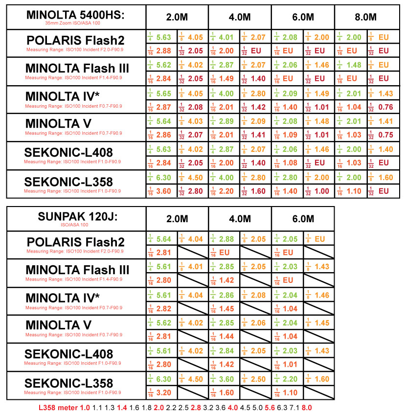

Hi all, sorry for the longer-than-expected break from this thread. I decided to reembark and complete a few overdue projects that have been on and off for the past 1-2 years. One of them is that I finally finished building a custom PC desktop all by myself. Anyway back to the point, this topic I actually did and completed during April. I wanted to share during July but then decided to put it on hold as I'm trying to get a Sekonic L478D and hopefully a Gossen Digipro into the myth test so as to get a better conclusion. After months of asking around, that seemed no luck in finding and borrow either one. I decided that I will just proceed to post it today. I will update this topic in the future if I can borrow one.
First, I would like to make things clear:
Why?
It all started many months back when I met a person (claimed to be a Professional Photographer) said that his light meters (supposedly a Minolta IV and a Sekonic L308, based on his description) can read a flash exposure from his Nikon SB flash @ 1/64 power from 10-15meters distance. He sort of implied my own Sekonic L408 and Minolta V are both defective since it can't detect his SB flash from a distance about 11-12 meters away.
During that time I was baffled by his claim, and it sort of put me in a serious doubt thinking whether my own meter's light sensor might be deteriorating and losing sensitivity. I have never came across this situation before as I have never taken a flash reading this far and @ such low flash output. My Sunpak 120J lowest is 1/16, Minolta 5400HS is 1/32. And normally if I am at this far a distance, I just chimp from my camera.

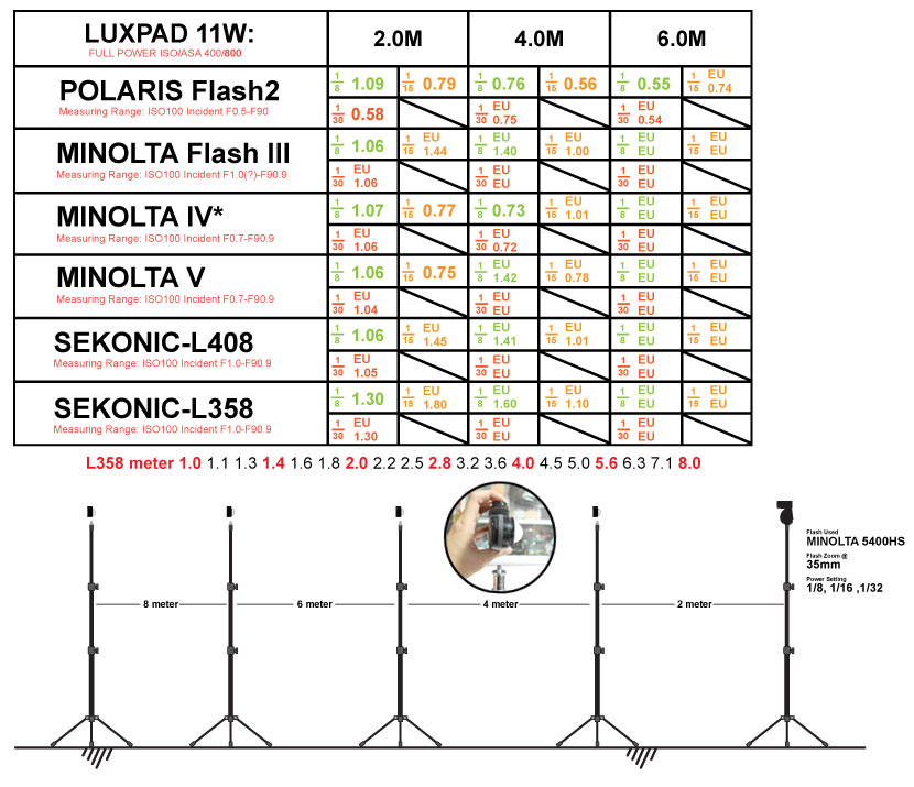

After pondering about this for a few days, I decided I will find out myself with a test. On hand I have a few flash meters and I got permission from the owners to use it for testing. I also went ahead borrowing a Sekonic L358 to add into the test as it is fairly new as compared to the other meters. Surprisingly it cleared away my worrying doubt and made me learn and know more about light meters.
Disclaimer:
Please note that this is not a Scientific Test. I try to be as accurate as possible and I only did the test once. It took me 4 hours and 30+ mins when I did it outside my long narrow corridor @ 1am. This is to ensure that the test setup will not be disturbed as everybody is sleeping except me.
4 measuring points @ 2m, 4m, 6m and 8m. Flash output from 1/4-1/32 for Minolta 5400HS and 1/4-1/16 for 120J. At each exposure reading, I will take a reading 5 times to ensure the exposure is accurate and constant. The Sekonic L408 and Polaris don't have rotatable dome heads thus I need to tilt the meters backward so I could see and record the reading. From time to time both meters may have 1-2 reading with 0.01-0.02+- differences. I will than average out to get a reading from the 5 exposures. All flash meters have been reset to default factory setting. If a EU (Under Exposure) is recorded I will pump up the ISO to 400 to read again. If 3 EU readings is shown. The test will end at that record point.
(FYI, Sekonic L358 is a light meter created during the DSLR era. It's reading @ 1/3 stop is cater to DSLR user. I have put the 1/3 increment down so you have an easier time comparing to other meters which are analogue film camera based.)
Besides Flash Exposures, I also mounted a LED panel to test ambient reading. It show something interesting as compared to flash exposure reading. Once a EU reading is recorded I will increase the ISO from 400 to 800. If EU reading still show at ISO800. The test will stop at that point. Also attached a simple diagram on how the setup is been done. Now for Minolta III, according to manual, its flash exposure range is F1.4-F90.9. However when it comes to ambient it show EV1-EV18.2 instead of Fstop. So based on result, I guessed it's ambient reading range is F1.0 to F90.9?
What I gathered based on the data collected:
Lets put the minor 0.03 – 0.01 (1/3 stop) difference between the meters aside. As I mentioned before, this is not a scientific test and some margin of human error and different factory calibration in each meter may contribute to the 1/3 stop difference. The main purpose is to find out - “Is it possible that a Flash Light Meter can read a flash exposure from a Hot Shoe Camera Flash @ 1/64 power and @ a distance of 10 meters or more?”
Now based on testing with a hot shoe flash zoom @ 35mm, 120J @ wide spread. I am confident to say that the statement from that photographer is absolutely bogus.
Now you might think - hey! how about if that pro photographer zoomed his hot shoe flash @ 105mm or even longer? It might increase the flash output and register a read on his meters? Yes, maybe? But frankly speaking who will shoot like this in most situation? I know I don't, thus I am not interested to find out. I wanted to do a test that is more commonsense, tuned with more logical setting that can be applied to what most photographers may use in most portrait shoot situations.
My conclusions and final thoughts,
1. Know your light meter well, read the manual! Really! Read your light meter manual thoroughly. Each light meter has its exposure range limit. Some have the same reflected/incident ambient/flash range and some have a total different set of range limit. A good example is the Polaris Flash 2. Its flash limit is F2.0 to F90.9 but when come to ambient incident it can measured a surprising low F0.5-F90?
2. Once it went under its flash exposure limit range, increasing ISO would yield the same EU result. However for ambient exposure it does work (1 stop max). Not sure about this... maybe the constant light has a bit more room for the light sensor to detect as compared to the super fast flash burst of light?
3. There is nothing wrong with my Sekonic L408 and Minolta V. Both are functioning properly.

Continuing from the previous thread, I will explain why the LED video light became the main light. Since I was working alone and overseas, I had to downsize my gear dramatically. For lights, these are the ones I brought along:

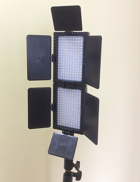

Yongnuo YN465 (as a standby) with a 40cm Flash Disc Diffuser - Original idea was to use it for 1/2 body portrait or a punch light. Due to time limitation, I never used it.
SUNPAK 120J with GODOX AD-S17 dome diffuser - good for lighting up a huge area. I also brought along the AD-S18. Tested on location, it was too bright and the shadow was very harsh compared to the S17.
DV-160V 9.6W Video Lights - I bought these LEDs 2 yrs ago from a shop in Mong Kok HK (one of the IT mall) about S$38-39 each with a bit of discount since I bought 4 pieces. It is small, simple design, nothing to shout about... However it has 2 features that I like. It has cold shoes on 4 sides which allowed me to play with different light formation and it has barn doors which I could control light spread (pretty neat). Last year, I went back HK and wanted to buy 2 more. However I can't find it in any of the shops? (Please don't ask me where to buy locally or Hong Kong I have no idea, please go search online or eBay.)

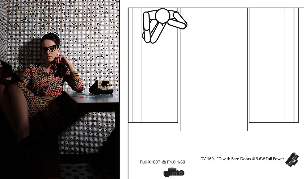

Below is the light setups with and without 120J.​
We shot the 3rd wardrobe on 2nd floor which has no windows except ceiling lights. It was pretty dim even if I switched on all the lights (remember this part). I was using two DV-160 9.6W arrange in a strip light shape. The LEDs was placed slightly above the model's head and on its side. Constant light has one big advantage. You can see the light on the fly and you can tweak the light to the desired effects. I wanted a low key rembrant feel. When comes to rembrant, it depends on where the model faces. The photo above, Alex turned her head a bit and became a broad light (a bit like split also), quite dramatic. I shortlisted the photo where Alex was facing the camera (refer #139) as her tilted head shadow aligned with the table cast shadow.
This shot is taken with the 120J, The dome diffuser is a interesting modifer. It is omni directional, and the light is not as harsh. I like the feel but It has one problem in this situation. Redeyes! Remember when I mentioned 2nd floor was pretty dim. I found out when I was shooting the 1st wardrobe.
