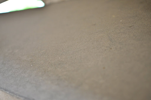

An example in a photo I took at f1.4... this may not be a good example, but if I put a 5c coin somewhere in the middle of that pix, and then focus on it, the "line" of focus should run through the 5c.
If it consistently focuses nearer or further away from the 5c, then the 5c is OOF and may appear soft. If the line of focus runs through the 5c and you think the 5c is soft then maybe need to bring back.
One thing to note is that the technician I talked to, took a picture directly straight on, which is difficult to judge whether is sharp or soft (it looked sharp enough, but I know it wasn't). I find this method just too difficult to tell that a picture is sharp; go angled, it's much easier to see that a slightly nearer or further point that what you aimed at, is truly in focus.
