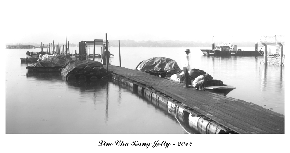

Lim Chu Kang Jetty,
8x10 Tachihara,
Shanghai 100

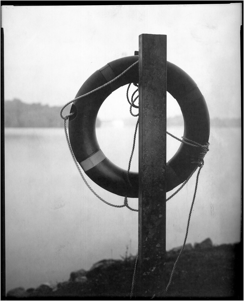

Lower pierce reservoir 11.05.2014
Lugging along my 810 Tachihara, Fujinon 300mm f5.6 lens to expose some darkroom papers as negatives. With the ISO of 3. The exposure is awfully long. Range from 1/4s to 8mins.
The papers were later process in darkroom as negative papers and once it is dry. It is direct contact print on a similar paper to become positive images and develop as normal.
Final product were scan just to put online to share. Preparing paper negatives can be very tricky at times. Just look at this print, lot of my finger prints and marks. Got be be a lot more careful when loading papers into film holders.
bro, you might need to trim away about 3mm from the longer side in order to slot into the holder nicely.
I already trim both side. Maybe need to trim a little at the side at an angle so that it will be easier to push into the holder... Will try the next batch...

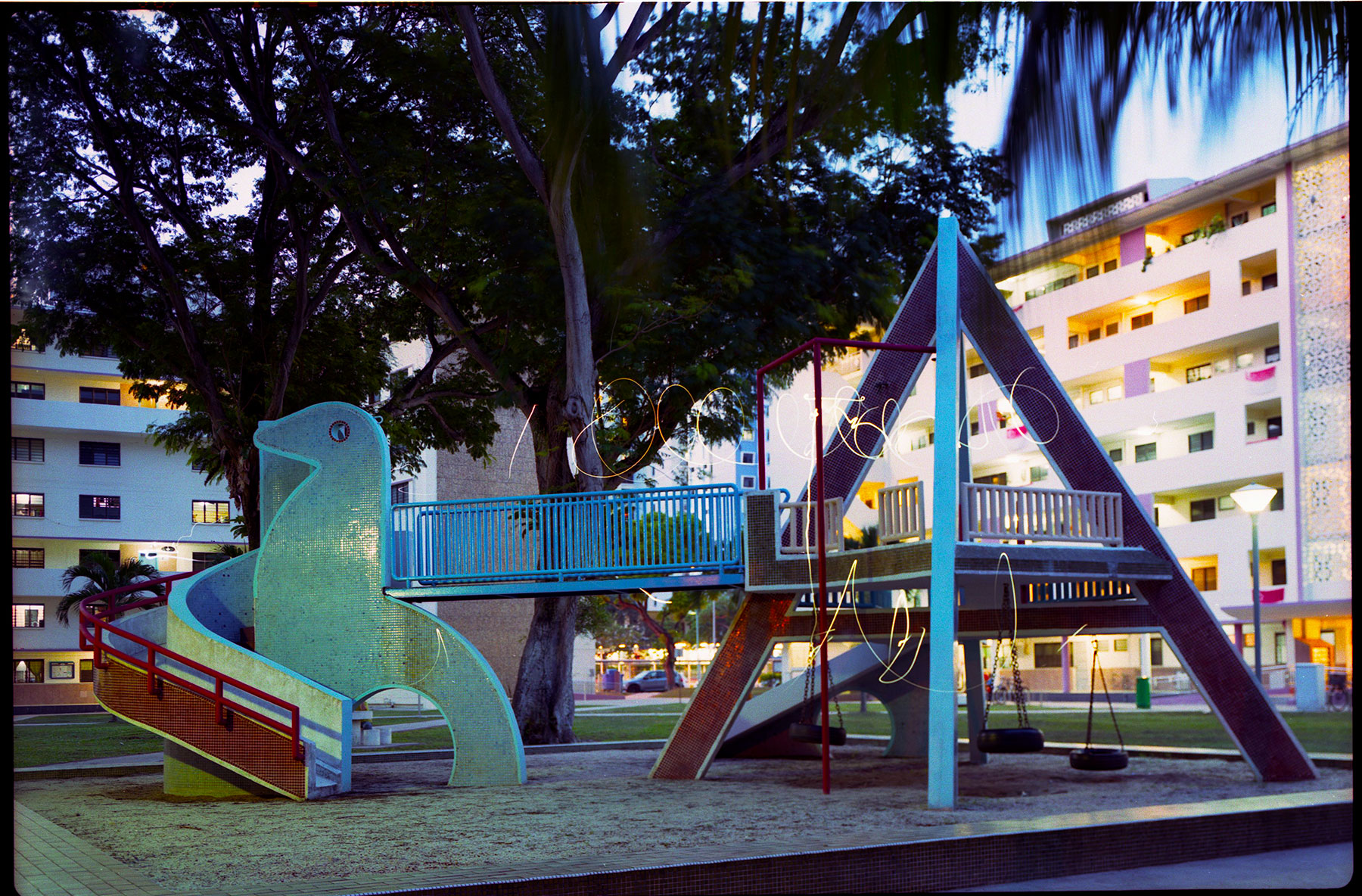

Dakota Cresent playground
Camera: Wista field 4x5
Lens: Schneider 180mm Apo Symmar
Film: Efke IR820 Aura
Developer: D76 stock @ EI 3

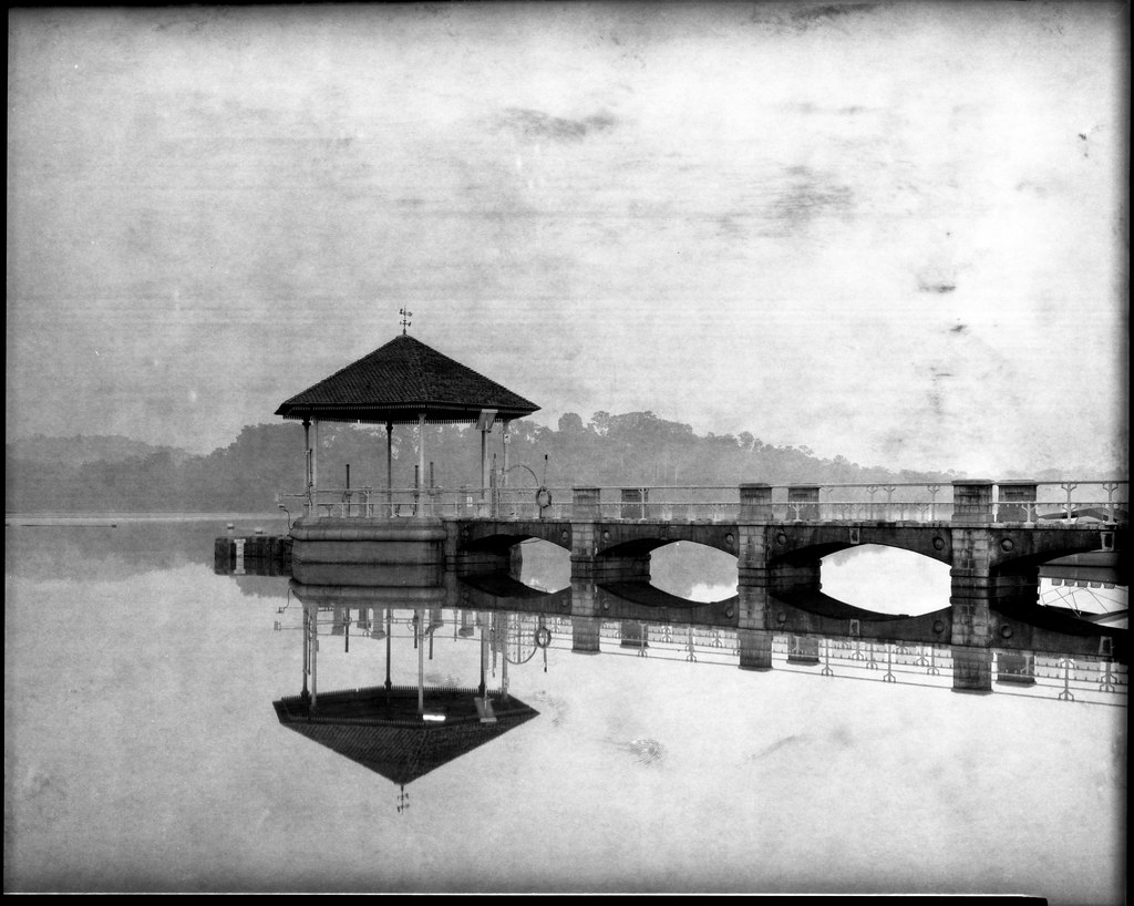

Ilford MGIV paper exposed as negative in Tachihara 810 on Fujinon 300mm f5.6 lens.
8x10 Tachihara
8x10 ShangHai 100

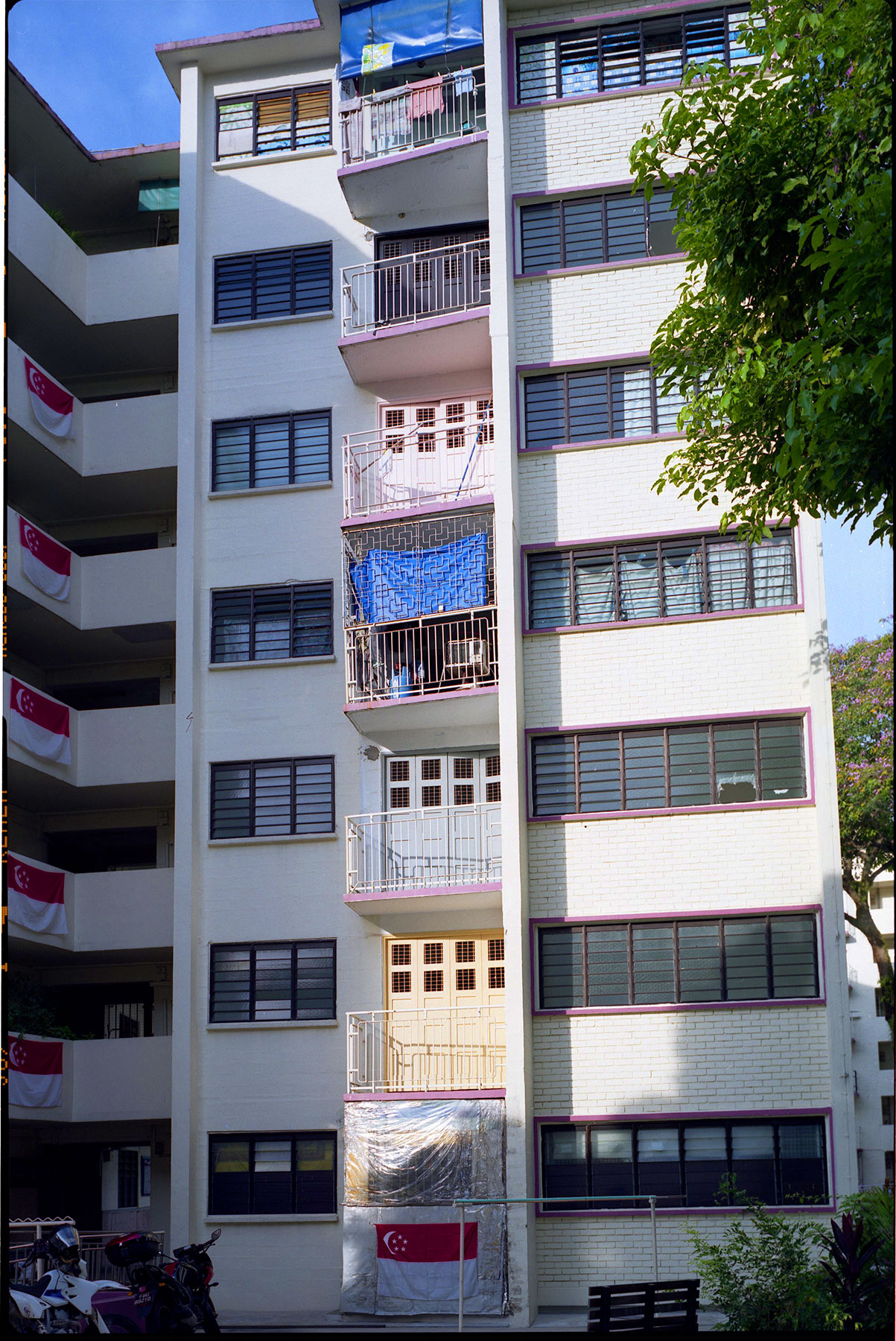

From the Dakota Crescent outing on National Day.
Flying the Flag
Block 18
Block 14
Chamonix 045F1
Komura Commercial 210mm f6.3 & Nikkor SW 75mm f4.5
Shanghai 100
Barry Thornton's 2 Bath Developer
From the Dakota Crescent outing on National Day. Flying the Flag Block 18 Block 14 Chamonix 045F1 Komura Commercial 210mm f6.3 & Nikkor SW 75mm f4.5 Shanghai 100 Barry Thornton's 2 Bath Developer
