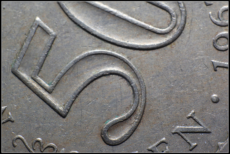

yeap, there is vignetting at the corners. i think this is the problem with reversed macro. the filed-of-view is limited and focussing is difficult, unless the object is under bright light. if we stop down the aperture to increase the DOF, we get serious vignetting, because the focal blades have become closer. but we do it wide-open, we lose a lot of DOF.
i took a similar shot of the eye of a $2 note and got vignetting also.
i think i would prefer to stick with using raynox clipped to a zoom.
the prime 50mm can be reserved for bokeh shot. ha ha... :)

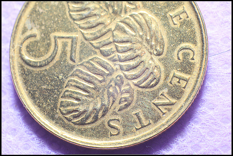

hi sorry for the late reply bro... ok this 10 dollar shot was done with a 100mm f22 and reversed 50mm f4. both are MF primes. for raynox i think i did a test shot with my diy reverse ring. i see if i can find it and post up here.

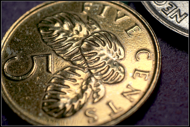

anyway, here are a few test shots i did with my 28-80mm kit lens coupled to a prime 50mm f/1.4.
the aperture ring of the 50mm prime had to be wide open to minimise vignettes. the kit lens was set to 80mm focal length, again to reduce vignettes.
all functions on manual, i.e. aperture, shutter speed and focussing. i did the pics under a single flourescent bulb, so i could not get very sharp pictures under slow shutter speed. the focussing distance most of the time was as little as 20mm, so i did not think using the on-board flash would be of any help, as there would shadows created by the barrels of the coupled lenses.
as you would see in the following pictures, the depth of field is very thin, and the area in focus is also very restrictive.
i would most welcome suggestions on how to increase the area-in-focus, although nothing much could be done about the DOF, since i had to maintain wide-open setting for the aperture.
