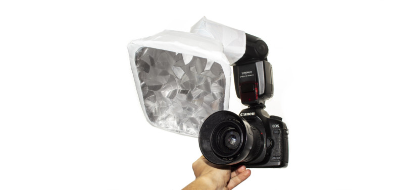

To get up close and fill the frame with the composition, I used a reversed Canon 28mm FD lens on a 36mm extension tube. You can learn more about reverse-mounting lenses here.
The light was supplied by a Yongnuo YN560EX III and softened by my DIY modifier:
A diffuser helps avoid harsh shadows or, like in this case, specular highlights that distract from your composition. Without it, the perfectly spherical water beads would reflect a direct light source very harshly.
Besides that, the light diffuser enables me to use an on-camera speedlight in the first place, as it not only softens, but also redirects the light to the front of the lens. Otherwise the lens would inevitably cast a shadow onto our subject and make the flash pointless.
