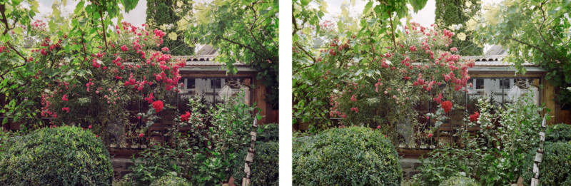

The conversion straight out of Negmaster (right) is quite close to the analog contact print made from the Fuji Reala 100 negative on Fuji Crystal Archive glossy paper in the darkroom on the left. Just like the contact print is by no means a finished image, the result delivered by Negmaster isn’t finished either, but a very good starting point to any further edit.

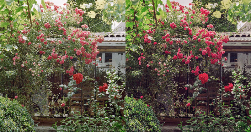

Side by side comparison of conversion results of Kodak Gold 200 from Negmaster (left) and NLP (right)
Straight conversions of Gold 200 in both Negmaster (left) and NLP (right). Again both results are pleasant conversions, with slightly more color fidelity in the Negmaster file.
Carefully comparing Negmaster with Negative Lab Pro, the differences in most images converted with both tools are subtle in the beginning, but of course, can be amplified during further editing. While both tools provide pleasant color, with many images and especially those with much green and yellow in them, Negmaster has in most cases delivered incrementally better and more accurate color straight out of the plugin, that would otherwise require a further adjustment of either Hue or Saturation of individual colors in Lightroom if NLP was used.
