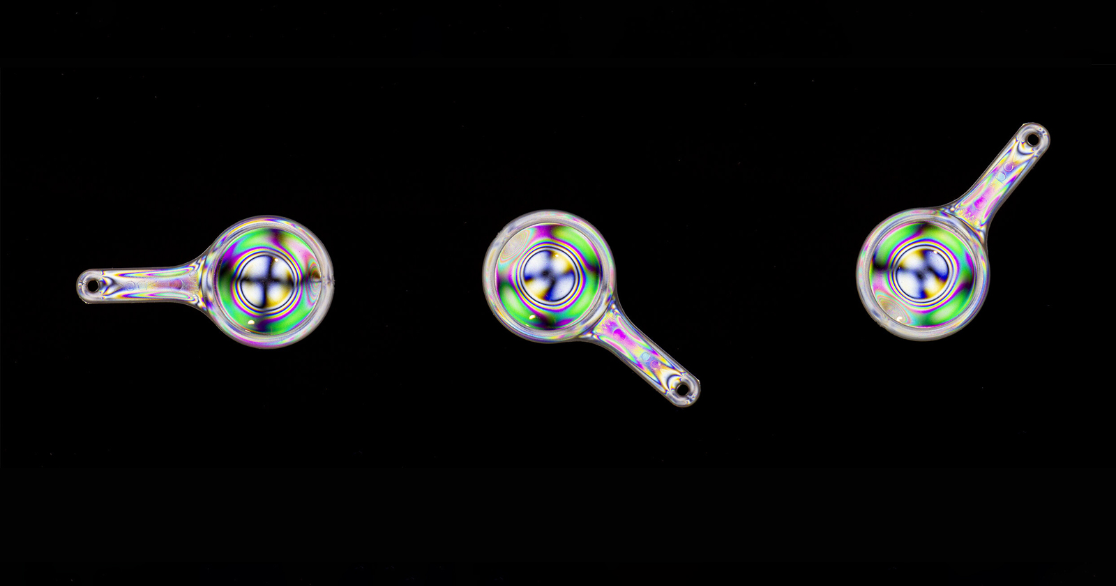

In some industries, this technique is used to locate areas of stress in plastic, but it also holds a lot of potential for interesting macro images:

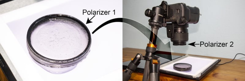

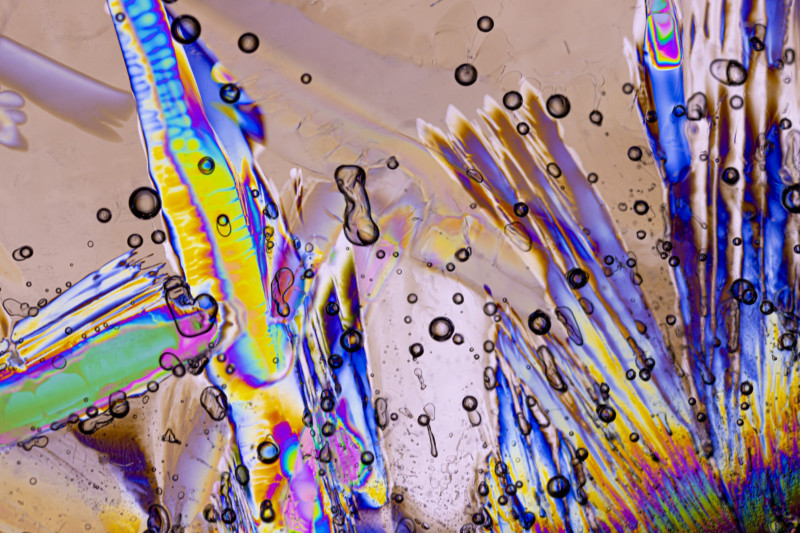

The image illustrates the molecular structure of some thin ice. Which colors these structures take on depends on the orientation of the polarizer in front of your lens. The photo was created by freezing water on a polarizing filter, which I then placed on a flat and even light source (in this case a repurposed notebook).
The two polarizing filters in the set-up above are oriented in opposing directions. This would cancel out all light as the CPL filter under the ice polarizes the entering light.
As the light enters the ice it gets doubly refracted which causes the original light ray to split into two rays that travel in different directions according to the refractive index. Both rays are still polarized. As one wave gets retarded with respect to the other, interference occurs between the waves as they pass through the second polarizer.
This phenomenon is called birefringence and it is responsible for the gradients of color in the images above.
Which colors these gradients take on depends on the orientation of the polarizers in relation to each other:
Also noteworthy: the best results will be achieved with linear polarizers.

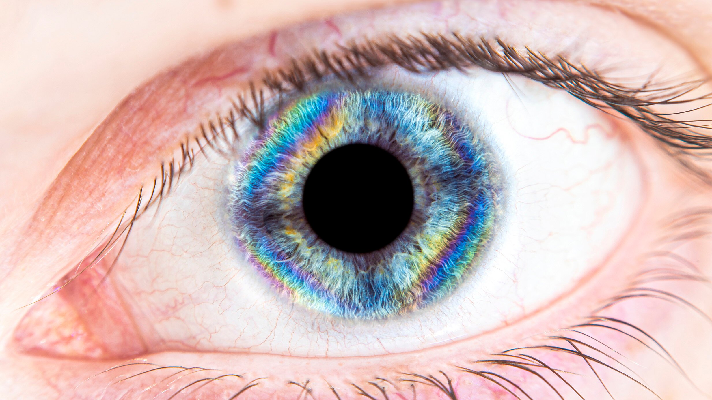

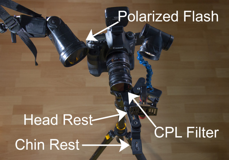

But not only translucent subjects such as plastics, ice, or crystals are capable of producing fascinating colors under cross-polarization: even the human iris will create interesting gradients of color when illuminated with polarized light and viewed with a second polarizer.
To have a look at my set-up that I used to capture the iris image above, please have a look here:
I had previously noticed some rainbow-colored highlights in my own (brown) eyes, but not really quite enough to leave me just as stumped or fascinated as I was upon discovering such colorful gradients on my camera screen:
When I saw some rainbow coloured highlights in my own eye I didn’t really think too much of it at first.
A bit more research and some further testing with two sets of brown and two sets of blue eyes revealed that this effect related to the color of blue eyes. Brown eyes have an additional layer of melanin which sits on top of the iris. The darker the color of the iris, the more of the pigment is present. This additional layer is the reason why such gradients won’t show up in brown eyes.
Even though I have a basic idea as to the reason for this phenomenon, I am admittedly not quite certain of the physical process that causes these colors to show, so if you can explain the science please share your knowledge!
