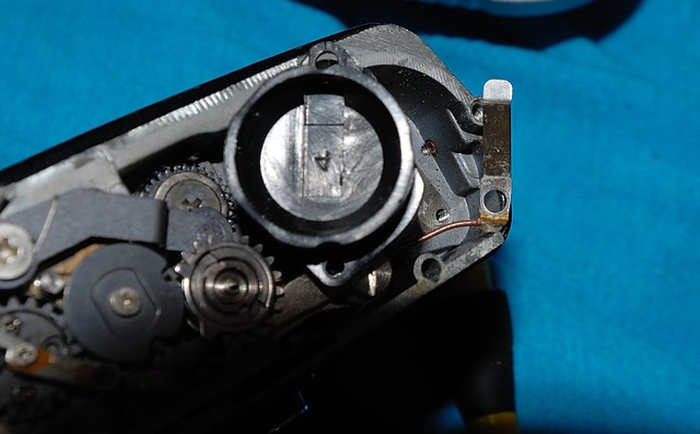

to add on:
i ve checked my om-1, and the variable resistor is only accessible thru the top plate which might be abit more difficult if yr new to this. however, the battery compartment is very easily accessible and there is more than enough space (alot actually) for you to put in the schottky diode to reduce the input voltage from 1.5v to about 1.35v.
have a good read of this first. i ve posted it before but just incase any of u guys missed it. http://www.rokkorfiles.com/conversion.htm
you ll need the diode (1N5711 Schottky Diode. about 30c from simlim tower, not square), a + screw driver and a soldering iron.
remove the 4 screws holding the base plate on, and you will see this:
the brown wire at the bottom right hand corner is the one we're interested in (under the batt compartment)
now unscrew the 2 screws holding the batt compartment in. they re at the 10 and 5 o clock position.
you can then take the compartment out and remove the (-) battery contact. you ll get something like this :
the diode goes in between the brown wire and the battery contact. there is alot of space (compared to other cameras) so its not a difficult job to do. MAKE SURE YOU GET THE POLARITY right. if not yr meter wont work at all and you gotta do it all over again. i would post examples of the completed product, but i dont have the stuff i need with me now.
please be aware that the battery casing is used to hold the film take up spool. make sure it is properly lined up before putting it back in.
if this is too much for you to do, just remove the bottom plate and battery contact, then bring the camera to one of the vendors in simlim tower and ask them to help you solder. it shouldnt cost more than $5 or so. i ll try to draw up a diagram and post it up soon so it ll be easier to understand.
this wills ave you ALOT of $. cos usually the shops will charge you the full CLA even if u want just this mod.
hope it helps =)
