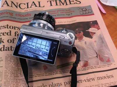

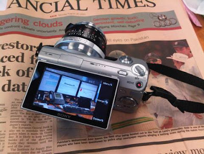

Test picture of my office desk
Zoom in showing weird green colour shift
if power on quickly -> go to Review and zoom in this displays instead
Reset all settings to factory default should do the trick...
all sorted out by chiff. thanks a lot.

still getting the above reported colour shift errors when reviewing pics on the NEX5. Narrowed it down..
It only affects if you shoot RAW only. In JPEG mode and RAW+J, the colour information is captured in the jpeg and the camera displays enlargement correctly, no problem.
Choosing RAW only and auto white balance will cause the error.
if you then manually set the colour balance to say Daylight, going back to the earlier file and enlarging it will make it display in 'Daylight' colour balance...
