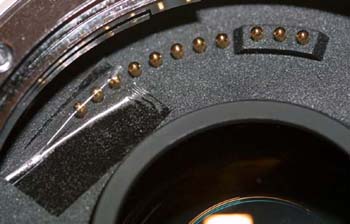

finally after long decision, i file out the sigma 2X and manage to stack it together with EF 1.4X II, good news is the result is sharpness is very good, bad news is AF going crazy to try to focus, but it can be solved with taped the last 3 pin on the 1.4X II, but another bad news is TC doesn't report the correct F number, so need to do it manually to set at f/8.

Wa! V brave of you. Can u show which pins u tape on the 1.4? Maybe similar taping will let me af properly with both sigmas stacked

ok i found the reference on line. and it seems that for the sigma lens, just taping one pin on the most left is sufficient. will try that this evening.
source for the 1pin taping trick for sigma 1.4 tc http://photography-on-the.net/forum/showthread.php?t=23667
yes you're correct, this is the one. once you tape it, the AF performance is way much better. and yes the previous version of this 120-300 OS is good lens at bargain price.
ooo... i just tested and yes, after taping 3 pins on the sigma 1.4 convertor, AF now seems to work reliably. looks like another round of assessment to be made before deciding which to sell hehe..... its too dark now to make proper judgement on sharpness of the TCs. taping 1 pin did nothing, so all 3 pins needed to be covered.
did the f number still shows 5.6?
Without taping it shows F4. After taping it shows 5.6, so the 1.4 is effectively invisible
