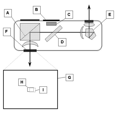

it would be easier for the TS to understand thru an illustration.
SLR principle is TTL (through the lens) both for metering and viewing.
sectional view of slr camera
Whilst RF is via a rangefinder mechanism
top view of a rangefinder camera
A.Beam splitter (semitransparent mirror)
B.Light-gathering window
C.Framelines projection/parallax compensation unit
D.Framelines projection semitransparent mirror
E.Rotating mirror/pentaprism
F.Viewfinder
G.Viewfinder frame
H.Static Image
I.Secondary Image
