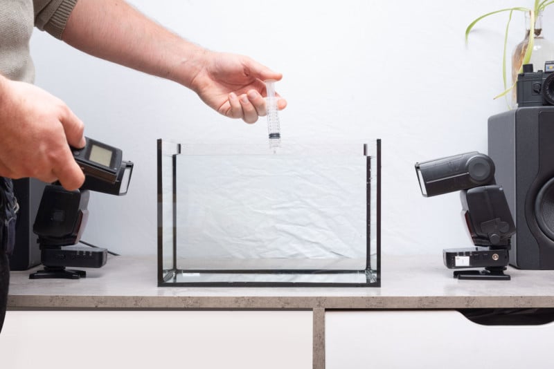

1) Setting Up the Tank
Fish tank filled with water and person removing bubbles from sides

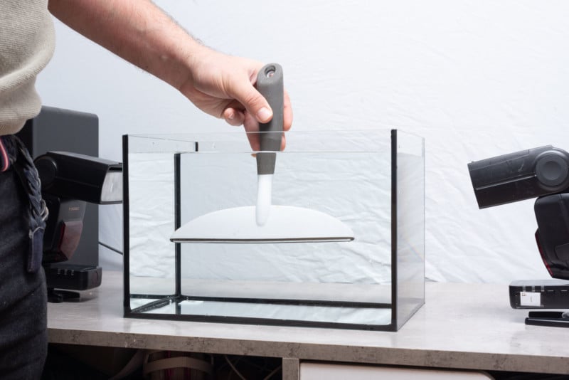

A squeegee is perfect for removing air bubbles from the sides of the tank quickly
The most crucial stage is choosing the right tank and setting it up properly. The best tank to use is one made of glass with flat panes because the flat panes will distort the image less and reduce the likelihood of chromatic aberration and softness in the image. Also, glass generally has better clarity than plastic which will result in photos that appear more cloudy. Also, plastic discolors over time (though I’m sure there are some plastic tanks out there that work suitably well, in my experience the glass ones have always been better).
Once filled with water, you’ll want to use something like a squeegee to knock off the air bubbles that accumulate on the side of the glass. Make sure you set up in an area that you don’t mind getting wet, preferably near a sink or hose. Also, place a white sheet of card or have a similar clear, plain backdrop behind the tank. It could be any color, but I prefer white to help reflect light into the frame.

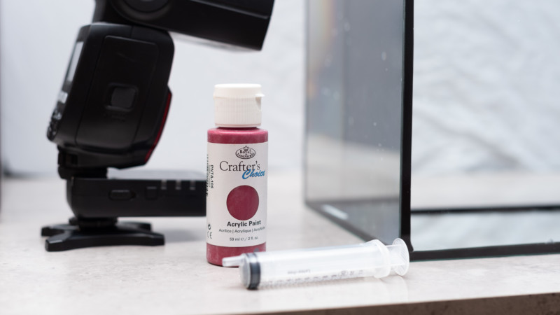

Often referred to as ink flows, there’s actually a variety of media that work well for this kind of photography. Ink, as well as paint or even food coloring mixed with glycerin, can produce evocative effects. The crux of mastering the flows, though, is in the viscosity of the ink you’re using. You can make ink more viscous by mixing in a thickening agent like glycerin if you want flows to hold together better, but add water to the mix if you want more blending between ink and water.

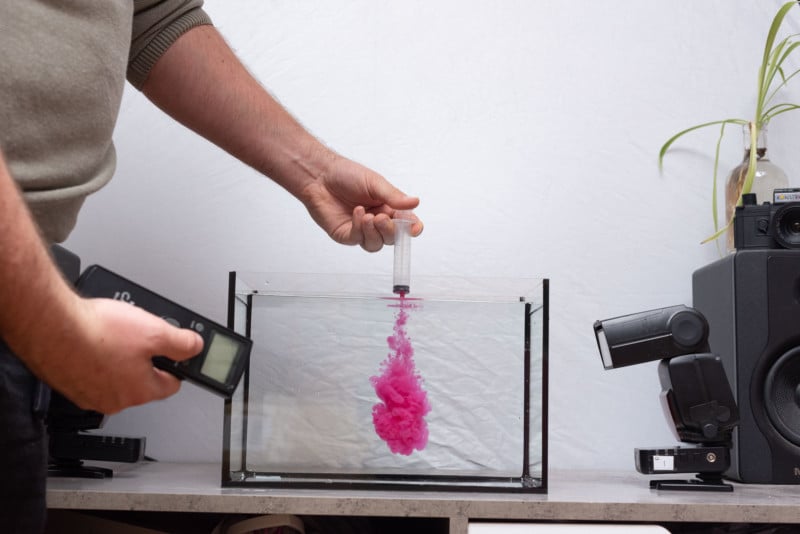

A pot of paint and a syringe for pouring next to the tank
Ink and paint both work equally well to make ink flow photos
I like to use a syringe to inject the ink into the water just beneath the surface for a cleaner flow. If I inject it above the water, the surface seems to spread the ink out too wide before it sinks down and shapes become amorphous. I usually tape the syringe to a piece of wood that rests across the top of the tank. If you don’t have a syringe then cut the top off a bottle, flip it upside down and suspend it with tape or string in the same way, with the opening resting just below the surface.

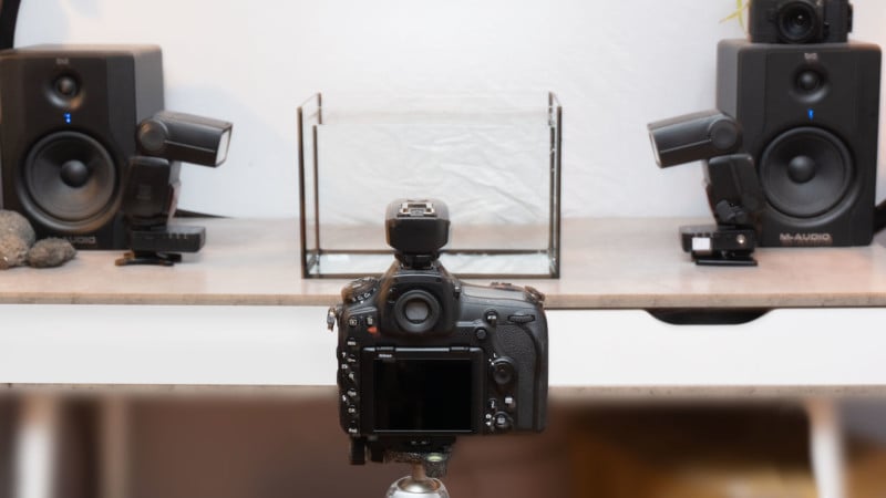

Place the camera on a tripod and use a standard 50mm lens or similar to shoot with – you probably won’t need a macro lens as the ink flows are usually quite big by comparison to macro subjects. Never shoot too close to your tank, especially if you have a small one. While filling the frame with the subject is normally a good idea to maximize image detail, it’s actually better to include most of the tank, if not the whole thing, in the frame.
A Nikon D850 sits in front of the water tank and two speedlight flashguns
That’s because as you pour the ink in the water it will start to billow outwards, filling the tank to the sides, and eventually completely coloring the water inside. By shooting wider than required you can choose from many more photos later when editing, cropping down where needed for the perfect composition.

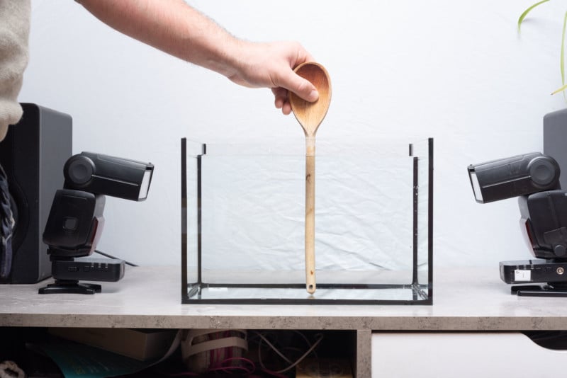

Now that the camera is in place and the pouring location is decided, I like to place a wooden spoon or chopstick where the end of the syringe or bottle top enters the water. I use Live View on the back of my camera and manually focus on the spoon and then disengage autofocus to maintain sharp shots throughout.
Person holding a wooden spoon in the middle of the water tank
Holding a wooden spoon in the middle of the tank gives the camera something to focus on

To create that familiar ink flow look, there are some key settings you must dial in. Depth of field has to be just long enough that the entire ink flow is sharp, so an aperture of around f/5.6 to f/8 is ideal on a 50mm lens. Synchronize the shutter speed with your speedlights if using them; this is usually 1/250 sec. I set ISO as low as possible (usually around ISO100) and then adjust flash power to get a balanced exposure.
Turn the camera to continuous burst mode to rattle off multiple images in one pouring. If you find the speedlights haven’t had time to recycle to complete the burst then turn down the power and increase the camera’s ISO sensitivity to compensate.
7) Use an External Shutter Release
Pouring and shooting the camera at the same time will be difficult if you’re on your own. In this case, it’s worth investing in an external shutter release. They’re relatively inexpensive for a basic model and will allow you to trigger the camera at a distance while pouring the ink in. I find this better than a self-timer or exposure delay mode because I can decide precisely when and how long the shutter fires.
Person with external shutter release
Use an external shutter release to remotely fire the camera while simultaneously pouring the paint

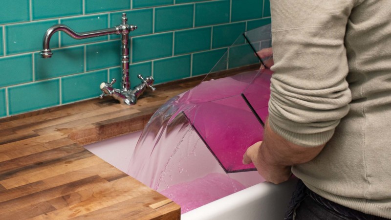

8) Empty and Clean the Tank
This is the most time-consuming part of the whole shoot, especially when you’re all set up with the camera and lighting. Once filled with ink, the tank will become obscured and you’ll have to clean it out before shooting again. Tanks are heavy when full of water so take care when emptying (this is why it’s helpful to set up near a sink). Clean the inside too, as some paint may remain on the glass and will seep into the shot again when refilling.
Person emptying and cleaning a water tank

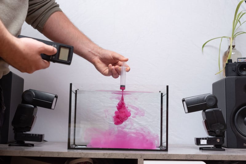

9) Shoot Early and Keep Shooting to Reveal Unravelling Shapes
Start shooting just as the ink starts to fall in the water and keep the shutter release depressed as it unfurls. You’ll get loads of photos that each look different as the flow changes shape in the water. However, you might find that your camera’s buffer or memory card write speed is low and shots get hung up while waiting for this to clear — that means you’ll get lots of initial shots and miss all the later ones. If you’re experiencing this issue, shoot in small bursts instead of holding the release down continuously.
Person photographing and pouring paint simultaneously
As the paint or ink flows into the water it will continue to unfurl into various shapes, sometimes two or three attempts can be made before the water is too cloudy
