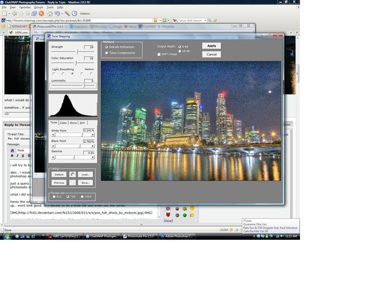

need to sharpen all your hdr images.. photomatix degrades the picture visibly , making it soft.
go to filter --> sharpen --> unsharp mask
for hdr most of the time i do it quite aggressively - 70-90, 2.8 pixels, treshhold 10
