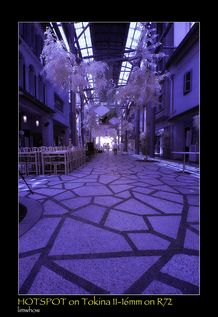

These are some shots taken on my R72 with Tokina 11-16mm on the 2nd October at Far East Square.
A.
Here is the first one.
The sun is behind me, ad it was a very very hot and bright afternoon.
I was using aperture f/5.0.
A hint of the hot spot. But because the sun is behind, it was not so obvious.
B.
Then after that I went inside.
Using f/5.6 I shot this.
Here the central hot spot was Blue, exactly the same Hue as its surrounding, thus like your case at Hill Street - no extra Hue but just increased amount of brightness.

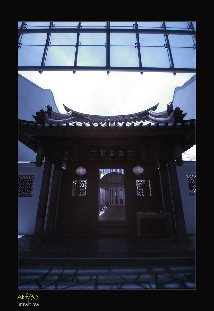

Edit: Sorry, Gentlemen. Add in one last one.
D.
I thought I'd try with f/3.5.
