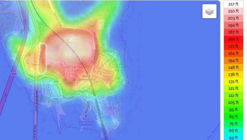

North end of the bridge:
South end (note that the color coded scale has changed):
The south end is maybe high enough, but frankly it’s quite flat. The picture at least suggests a hillier area.

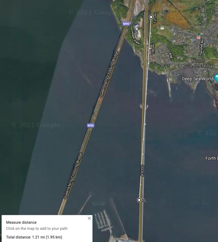

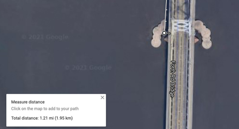

Let us assume that the north end is the right end. Vindication awaits. Using the measuring tool in Google Maps (on the satellite view,) we can draw this line, sighting along the edge of the near tower. Starting with an overview:

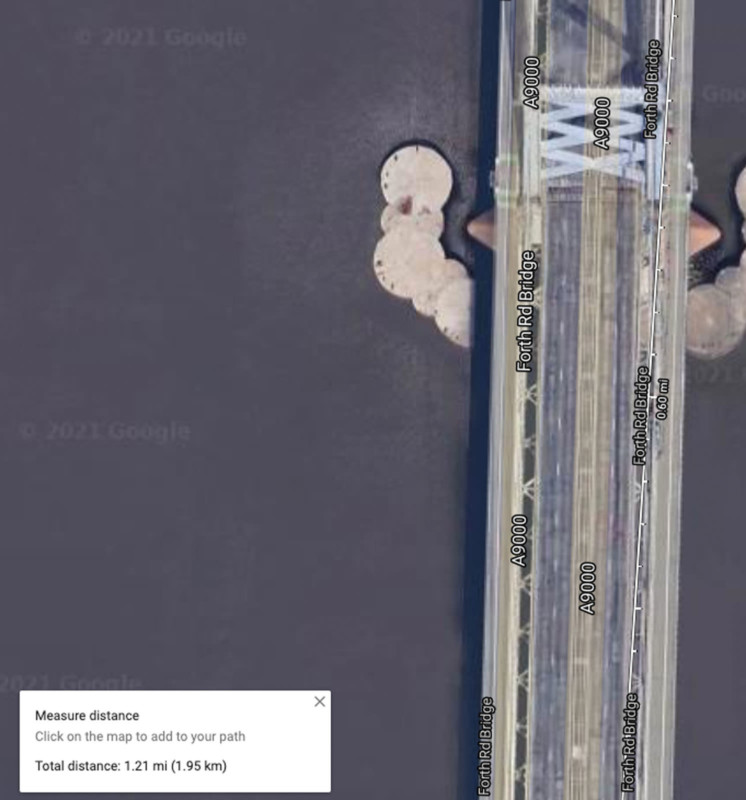

Here is the south (far) tower showing how our imaginary sightline lands 50 feet or so west of the tower:
Same sightline skimming the north (near) tower:

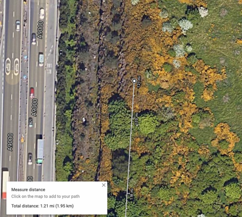

And finally our hypothesized photographer location. Note the markings for 1.20 and 1.21 miles, to give a sense of the range of possibility:
Now look toward the highway from our photographer’s location! To the photographer’s right, there are three separate cuts to get down to road level, where just north and south of this location, there are but two. This spot is in fact a high point. This is borne out by the topo maps, albeit approximately, and also by the street view from the highway. Distortion makes this hard to interpret, but you can see two cuts, and then three cuts, in the hillside:

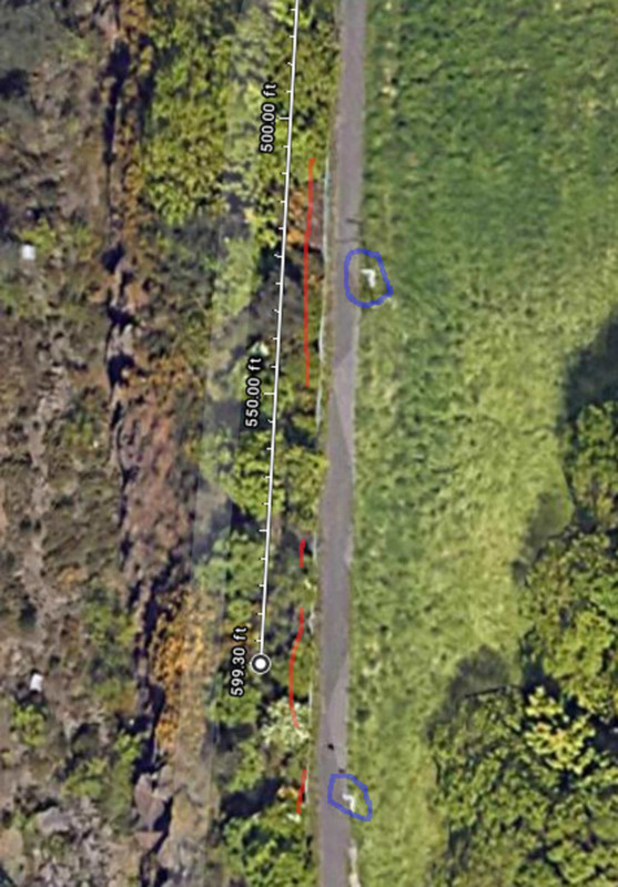

So we have located a spot where, as far as we can tell, this perspective could be accomplished. What else can we see? What about those guys in the foreground? What’s going on there? There’s a fence, and some streetlights, right? The people standing there look, roughly, 3 times as tall as the people on the bridge at the point where the suspension cables vanish under the deck:
That is to say, these foreground people are very roughly one-third of the distance away from the photographer than the spot where the cables vanish below the deck of the bridge. After doing more measuring on Google Maps, let’s say they are about 600 feet away from the photographer. Let us look at today’s satellite imagery about there:
We’re looking at a path around the perimeter of some sort of park. Indicated in red is what might be a fence (the white line on the path’s edge,) the blue circles indicate what appear to be lighting over the path. It is entirely consistent with the same objects we see in the original photo from 60 years ago, although we should suppose the lighting and fence have been updated. A little further south, there are steps on the path, consistent with what looks like the abrupt drop-off beyond the foreground figures. We might even see a little bit of railing, as for stairs, in the photo.
This spot is slightly north and a little west of the North Queensferry Community Center.
