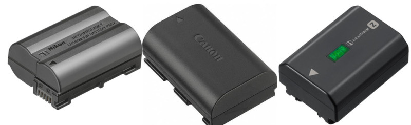

Let’s move to lithium-ion. Lithium-ion batteries are in just about everything that we use and this is where the restrictions start to be a little strange. First off, any batteries that go in cameras and are in cameras can be left in the cameras and they are considered no problem whatsoever. So Canon batteries, Sony batteries, even the large one for my C200 is still under 98 watts. They can go in the camera and be left in the camera, and they can be carried on inside the camera or it can be put into the luggage.
If you want to check it you can check it as long as it’s in the camera. Those do not count as batteries that are loose. So you can set those in the camera. Definitely put those in the camera.

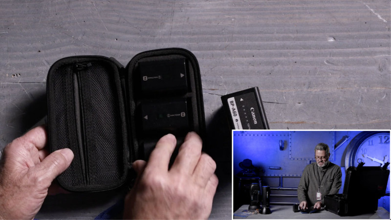

I put all of my batteries in a small zipper case. In the zipper case I will have my Sony or Canon batteries all lined up and all zipped together. I put a label on it that says, “Sony batteries”. I’m not making any secret about what it is. I’ve never been stopped or asked about this at all because it is an enclosed container. It’s zipped. I’ve never had an issue with it.

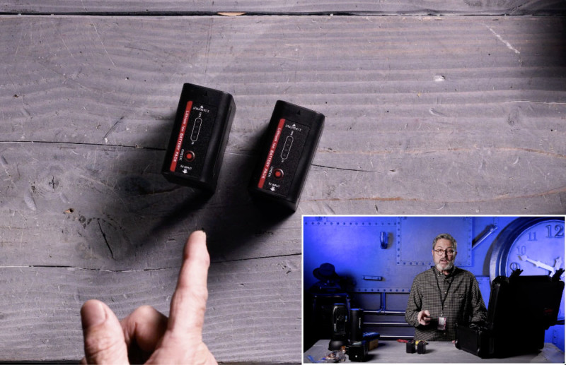

For production, we carry larger 99-watt batteries. They are super small V-mount batteries and super lightweight. They are an excellent battery because of their size. These are pretty revolutionary because they’re so small. How many of these can I carry on the airplane? TSA says four, and some airlines say, four to six or eight. So that is a little unclear.
I did some checking with some companies. They say that four to six of the 99 watt batteries are never going to cause a problem for you. If you have eight or ten of them, it’s probably going to start to cause a problem for you. So you definitely can carry four of these without any concern whatsoever.
For batteries that are 99 watt or under 100 watts each you can carry four. You can carry up to 160-watt batteries. And you are allowed up to two 160 watt batteries, not more than two. And you may only carry them on, you may not check them. If you have two 160 watt batteries, and then you start stacking on 99-watt batteries, you’re going to start to have a problem. They’re going to start saying you’re carrying way too much.

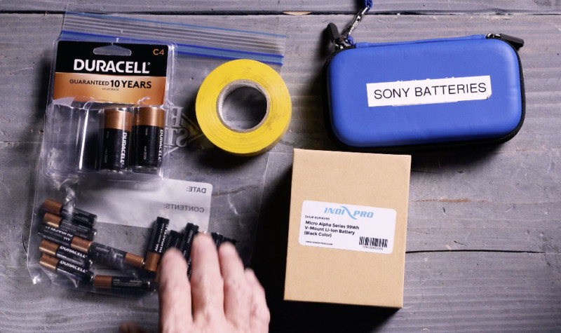

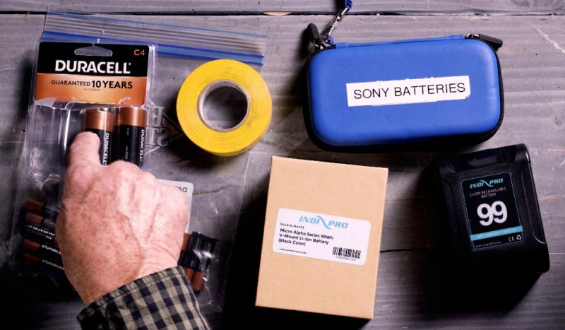

1. So the number one way is to just simply put them in their original box. If you bring batteries in their original packages, AA, AAA, Cs, etc. in their original packages, you’re never going to have a problem. If you put these 99-watt batteries in the original box and close that box up. It says right on it what it is. When they open it, it is what it says it is. And there’s not going to be any question about that. And it doesn’t look as scary as a big row of batteries in your carry-on case.
2. If you can’t put them in their original packaging, then what I do is I just do something to secure them. Put them in a Ziploc bag. That means that they’re all together and they’re less likely to touch a piece of metal or something and create a short. I do this for my batteries.
3. If you’re going to travel with the battery, you just simply take your battery, take a little piece of electrical tape and tape over the contacts. I use yellow electrical tape because I want them to see it and know that I have taken the time to make sure that battery is not going to have any kind of electrical short.
The mounting bracket is not your contacts on a gold mount battery, these are not electrical contacts. So on a gold mount battery, where would I put that tape, I’d put it right there across that little section there. Now when they open up and look at your bags, your batteries all have tape on them. They’re secured and there’s not a problem.
