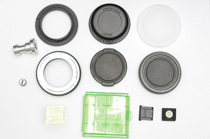

Selling a 49mm-Pk adapter,
turn any 49mm front thread lens into super macro lens, (like Pentax SMC K/M/A/F/FA 28mm, 35mm, 50mm lens with aperture ring.)
this technique enable you to have super macro lens beyond 1:1, and still maintain fixed 4.5cm lens to subject distance. (which is flange focal distance of pentax camera)

28mm revered onto my kx,
how 49mm-pk mount adapter looks, the 1st black ring on top left
enough said, compared to

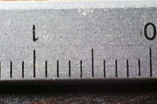

fomular to experiment how much macro you achieved,
1. take photo of a ruler, get reading of length left-to-right in the image, if it is 1.2cm length in photo.
2. pentax aps-c sensor size is roughly 2.4cm in length,
3. so your macro rate achieved is 2.4/ 1.2 = 2x, so called 2:1 macro rate

some my photo for your reference.
