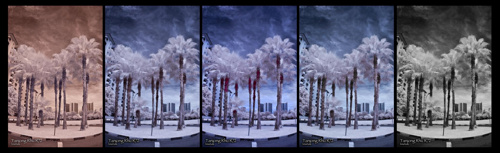

Palm trees
A revisit of Tanjong Rhu today. It was a bright, sunny morning. Beautiful and ideal condition for IR.
Hoya R72
EXIF: Focal length 17mm f/6.3 1/400 sec ISO 200
Sequence of photos:
  1. Straight out of camera
  2. With channel swapping
  3. After channel swapping and enhancement of Red, Blue and Cyan in Hue & Saturation.
  4. Further tuning of sky's Blue to a little greenish hue, and Red and Magenta to a little greenish.
  5. Desaturation to Black and White and increase Contrast to 40%.

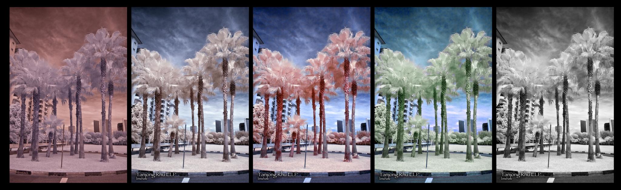

ELP
EXIF: Focal length 17mm f/6.3 1/500 sec ISO 200
Sequence of photos:

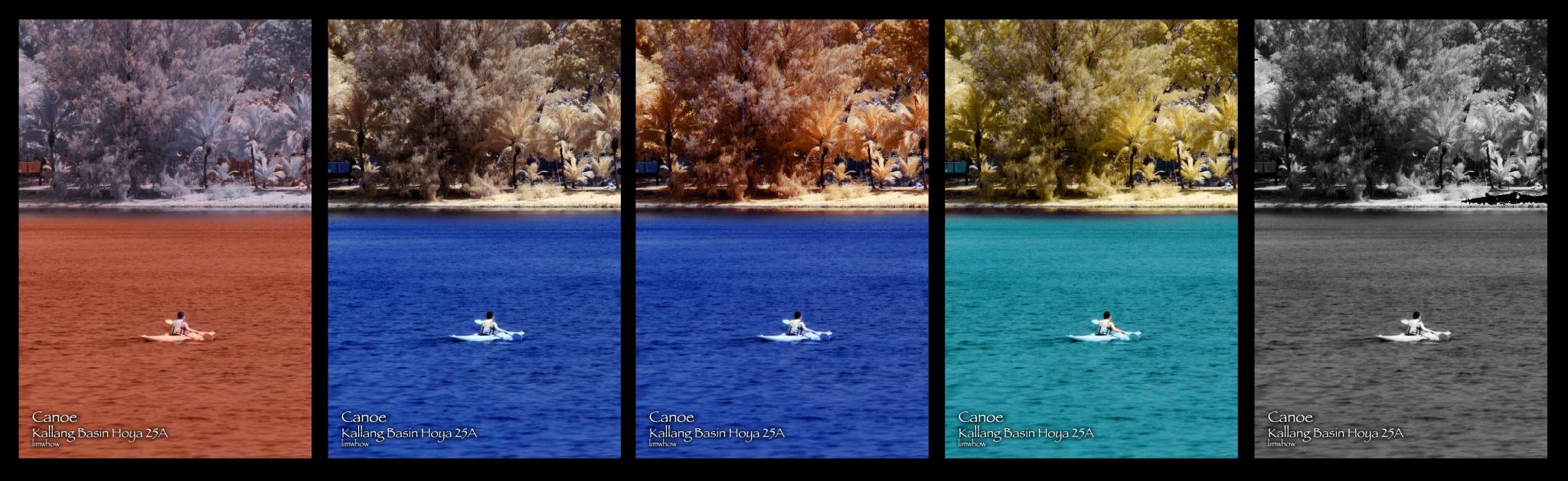

The Colour of Water
Hoya R72
Lens used 70-300mm
Sequence of photos:
  4. Further tuning of water's Blue to a little greenish hue, and desaturated Red and Magenta a little. Did masking to give a slightly normal skin tone.

Hoya 25A
Lens used 70-300mm
Sequence of photos:
  3. After channel swapping and enhancement of Red, Blue and Cyan in Hue & Saturation, and Magenta to a orangey tint.
  4. Further tuning of water's Blue to a little greenish hue, and tuning the Red and Magenta to a Golden yellow. Did masking to give a little bit of normal skin tone.

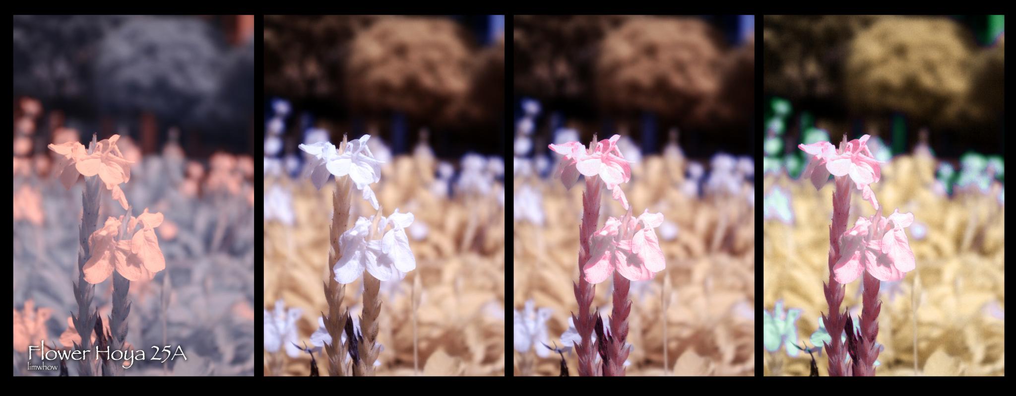

Flowers
The issue with Flowers in IR is, they always turn out white (or pale golden yellow), exactly like the leaves surrounding them.
Thus no matter how colourful they are, the end result is always a vastly paled version of their real-life look.
So if we need to liven them up, we would always have to mask their surrounding and colour the flowers.

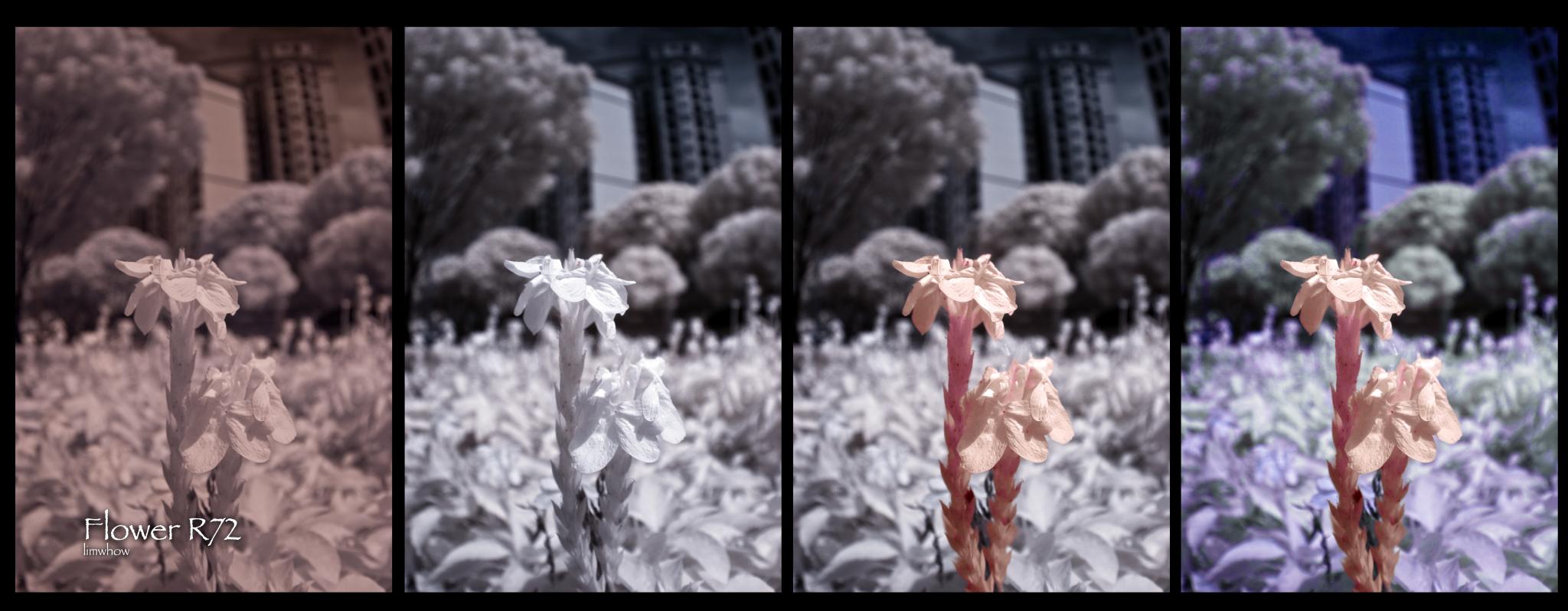

Hoya R72
Again, the masking (or rather unmasking) of the flowers and addition of colours is very subjective. One has to paint it to one's liking.
And as always, not everyone would concur with the way you've coloured your subjects.
It's really really very subjective.
Sequence of photos:
  2. With channel swapping.
  3. After channel swapping, masking done to adjust Blue and Magenta to give the flower some colours.
  4. Here unmasking of the background done to allow Hue and Saturation to bring out some colours on the background folliage.

Hoya 25A
Sequence of photos:
  3. After channel swapping, masking done again to adjust Blue and Magenta to give the flower some colours.
  4. Similarly unmasking of the background done here to allow Hue and Saturation to bring out some colours on the background folliage. This one has the most clours. But honestly, I am not sure how to deal with so much hue. I sometimes prefer to have lesser, such as with the ELP.

tot I'd put up this comparison I did of ELP, R72 and P007, for reference..
shot with the same settings, roughly within a 15min timespan..
apologies for rather underexposed shots..
Thanks..
