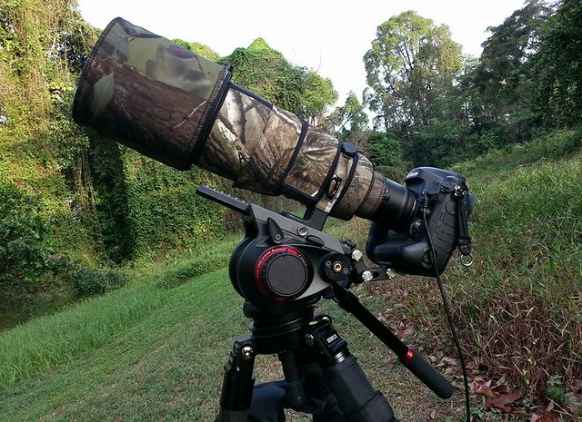

This is my initial support setup. The tripod is not a small one (M-3204) and a Jobu Jr Gimbal head. Even with this setup, I was getting vibrations like no tomorrow when my mirror is flapping. it was so bad that the subject in my viewfinder looks as though it was bouncing up and down constantly. I missed many shots due to this, due to the AF point moving around due to my viewfinder bouncing all over.
Picture of the entire setup deployed.

Anyway this is my current setup, and even with the 2XTC, I can get great birding pictures. Note the size of the tripod, as well as the additional lockdown to prevent vibrations. No more vibrations like before, Zero. I think I went overboard, but then again, if and when I get a bigger/longer lens, I can use the same setup.
