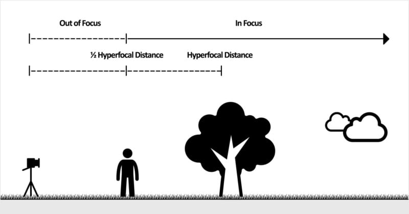

Let’s consider a pretty common scenario: You are taking a landscape photograph of a field on a sunny day, and you have a person in the foreground, a tree in the middle ground, and then some awesome swirly clouds in the deep background. Here’s your problem: What lens do you use, at what aperture, set to what focal point, so that all three major elements — the person, the tree, and the clouds — are in focus and sharp enough?
If you focus on the person, the tree is out of focus. If you focus on the clouds, the person is blurry. If you focus on the tree — well, maybe that could work, or maybe the tree will be nice and sharp but the person and the clouds will both be out of focus. But let’s say you fiddle around a bit with your focus and find a “sweet spot” at 55 feet away, with your 85mm lens set to f/16, that puts all the important elements of the shot in focus. That “sweet spot” is your hyperfocal distance. Just write down your lens settings in your photography notebook — 85mm, f/16, 55’ — and now you know what your hyperfocal distance is!
Simple, right? Except that that’s only the hyperfocal distance for that field, with that person and that tree and those clouds. If the person isn’t exactly the same distance away the next time, you can’t use 55’ as your hyperfocal distance. Surely there must be a better way to calculate hyperfocal distance other than just guessing and checking for every element in every shot?

The “objective” method is sometimes called the “double distance” method because your focal point is going to be about double the distance from you to the closest foreground element. In our example of person, tree, and clouds, if the person is roughly 30 feet away from you, then your hyperfocal distance is going to be roughly 60 feet away. If you’re really good at estimating distances (or you have a laser rangefinder), you can use this shortcut to save yourself a lot of time by focusing at 60 feet, to begin with, and adjusting aperture from there.
