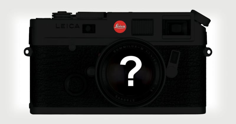

In the eyes of many, 35mm film photography was snuffed out in the early 2000s. But a small, dedicated fan base has continued to smolder. For all intents and purposes, Leica launched the 35mm camera. And it seems that nearly a century later, they are still committed to fanning the flames that they themselves ignited.
Word on the street is that Leica may offer a budget-friendly 35mm rangefinder camera to join their current MP and M-A 35mm models sometime in 2021.
This got me wondering; what form might the new hypothetical camera take?
It will surely be an all-metal and manual M-mount rangefinder camera that looks and feels true to the Leica legacy. But how will Leica provide this for the rumored $2,000 to $3,000?
Let’s take into account that Leica has always built the most expensive 35mm cameras in the world. But now they’re taking aim at a demographic who have grown accustomed to buying sub-$300 Japanese antiques, albeit of very high quality, courtesy of rapid market devaluation.
The new 35mm Leica will have to be appreciably different from the MP and M-A in order to squash the price without destroying the surprisingly strong market for those cameras. But the new Leica will also have to be appreciably similar to the MP and M-A, or perhaps the still-popular M6, in order to inspire sales to begin with.
