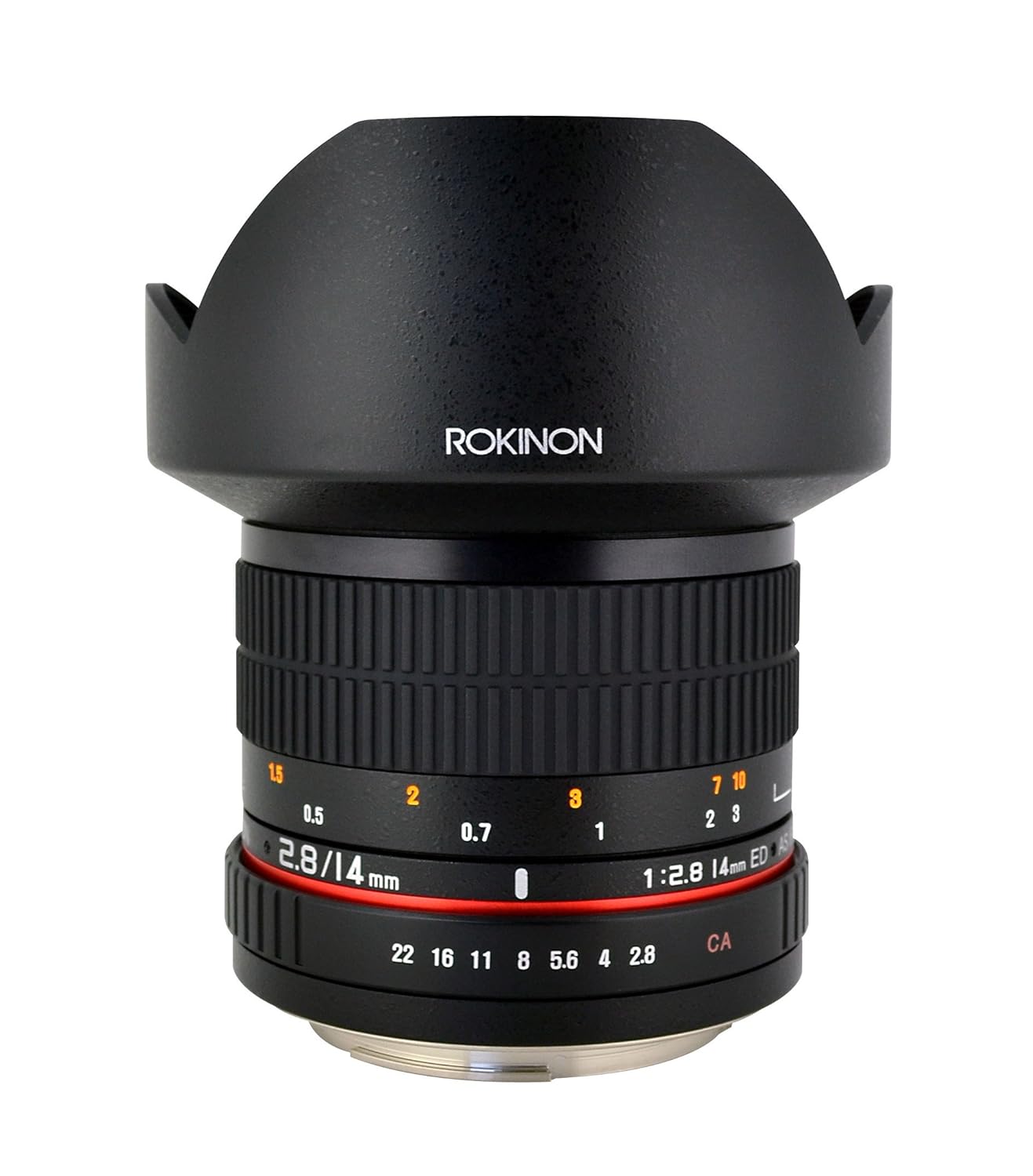

rokinon 14 2.8 going for US$329 on amazon if anyone is interested.
seems to be an updated design/look matching that of the T3.1 Cine lens
