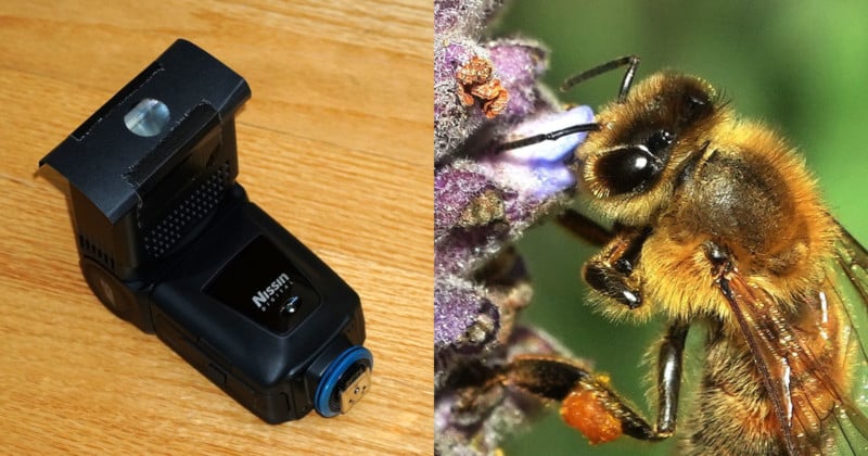

Further research led me to discover the Nissin MG80 Pro, with a metal foot – YAY! The Nissin distributor sent me one to review.
![A Nissin camera flash A Nissin camera flash](/proxy.php?image=https%3A%2F%2Fpetapixel.com%2Fassets%2Fuploads%2F2021%2F11%2FNissin3-800x710.jpg&hash=0222e39f0980b902b89792da0721293b)
Here are some comparisons of the MG80 with the Godox flashes I’ve owned.
Foot. MG80 Pro has metal foot. Having lost two Godox flashes to broken feet, I like this a lot.
Guide number The MG80 and Godox 860 have equal guide numbers (max brightness). The Godox V1s is not rated with a guide number but is probably slightly lower. At my close range, the guide number is not very important, but a high guide number suggests that I’ll be using it at a small fraction of its power and will enjoy a short recycle time.
Battery. The MG80 Pro battery capacity of 360 full power flashes is about half of the Godoxes. This is not an issue for me. My close-up flashes consume a fraction of full power. So I get over 1,000 closeup flashes on a charge. The MG80 can use four conventional AA batteries or four 14500 lithium cells. Users might appreciate this if they run out of juice while away from their home base. They could buy some AAs and keep going until they could charge their depleted lithium cells.
Flexibility. A unique feature of the MG80 is that the concentrating Fresnel lens head can be slid off, revealing the quartz flash tube. This looks like it would allow flash with extremely wide-angle lenses.
![The head of a Nissin flash The head of a Nissin flash](/proxy.php?image=https%3A%2F%2Fpetapixel.com%2Fassets%2Fuploads%2F2021%2F11%2FNissin-bare-510-800x674.jpg&hash=025a4130969e72c10d7b090880d32449)
I’m buying the MG80. I want that metal foot and the price is less than half of the only other metal-footed Sony flash I know of, the Profoto.

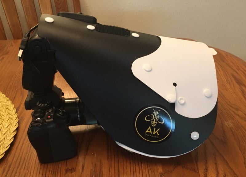

Many skilled insect photographers construct their own diffusers that they carry out to the field. They primarily shoot at 2x to 3x magnification and are so close to the insect that their diffuser hangs over it, surrounding it with diffuse light and blocking the Sun. They achieve beautiful results under these close conditions.
![A flash with a custom diffuser attached A flash with a custom diffuser attached](/proxy.php?image=https%3A%2F%2Fpetapixel.com%2Fassets%2Fuploads%2F2021%2F11%2FAK-Diffuser-800x577.jpg&hash=0dc5d8458b846797c5659fc285654ef2)
A custom-made AK Diffuser

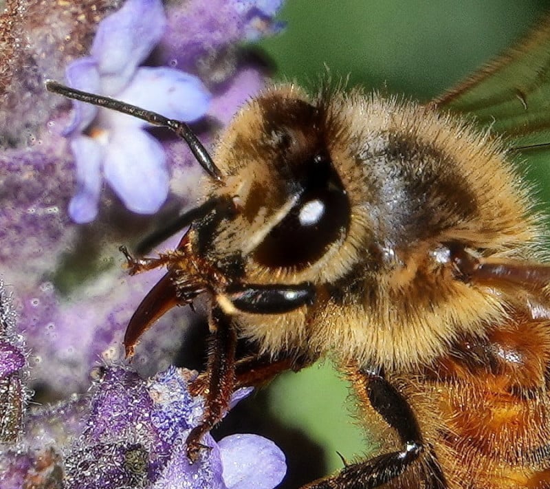

I’ve opted for a much greater distance because the bees are so fast. They stop off a few seconds, drink, and move on. There’s rarely enough time to get close, so I shoot from several feet away at about 0.3x magnification. I’ve not found a diffuser that is beneficial at that distance. So I currently shoot with undiffused flash to minimize the size of the reflection on the bee’s eyes. (Diffusers enlarge the diameter of the flash light source and thus the diameter of the reflection on the insect’s eyes).
![A bee on a flower with a large light spot A bee on a flower with a large light spot](/proxy.php?image=https%3A%2F%2Fpetapixel.com%2Fassets%2Fuploads%2F2021%2F11%2F4091CC-800x711.jpg&hash=ec693b24f068484b37abe9872e499bfc)
The bright spot on the eye is a reflection of my flash. If I shoot in sunlight there will be two spots, one from my flash and one from the Sun.

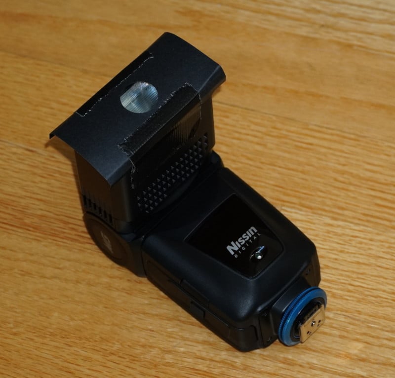

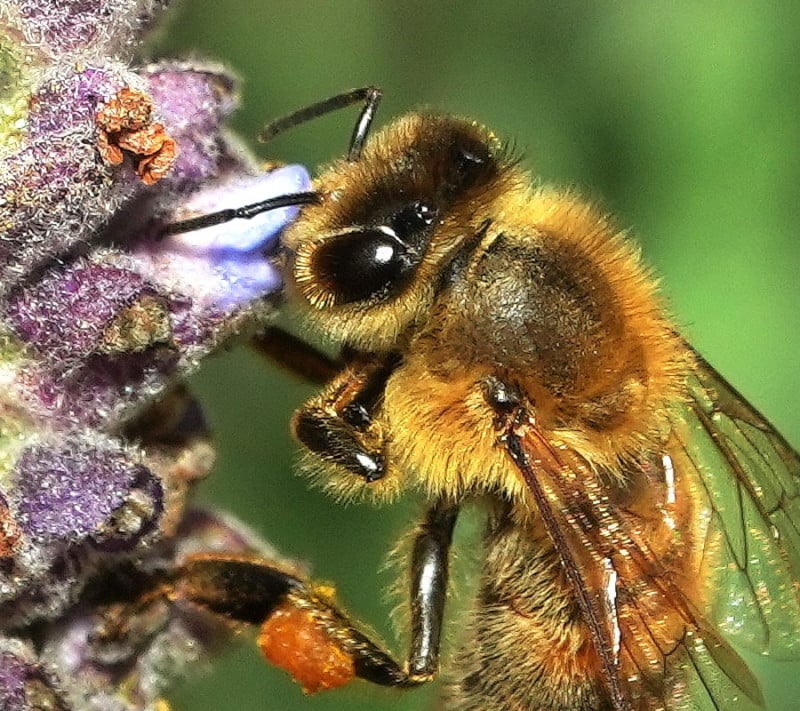

I’m also experimenting with a mask over the flash head to reduce the diameter of the reflection.
![A bee on a flower with a smaller light spot A bee on a flower with a smaller light spot](/proxy.php?image=https%3A%2F%2Fpetapixel.com%2Fassets%2Fuploads%2F2021%2F11%2FMasked-flash-4956-800x711.jpg&hash=1eb7cf6f98a0692f9a42120122e21467)
The masked flash head results in smaller spot on the eye.
![A camera flash with a mask to limit the size of light spots on bees eyes A camera flash with a mask to limit the size of light spots on bees eyes](/proxy.php?image=https%3A%2F%2Fpetapixel.com%2Fassets%2Fuploads%2F2021%2F11%2FNissin-Masked-516-800x766.jpg&hash=5dc69437a10d366b2bf44d0c40c3884a)
Mask on flash head
