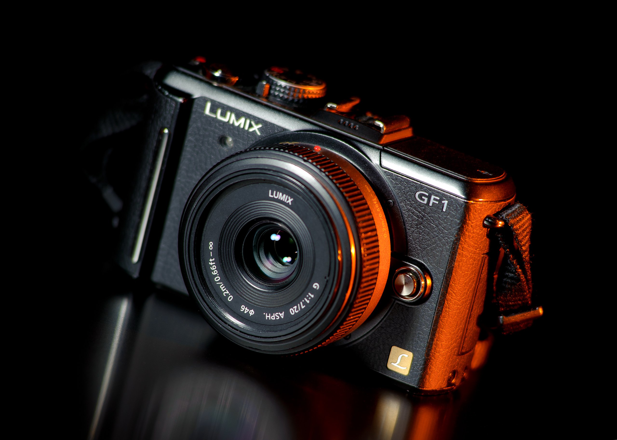

The Panasonic LUMIX GF1 that now belongs to my son.

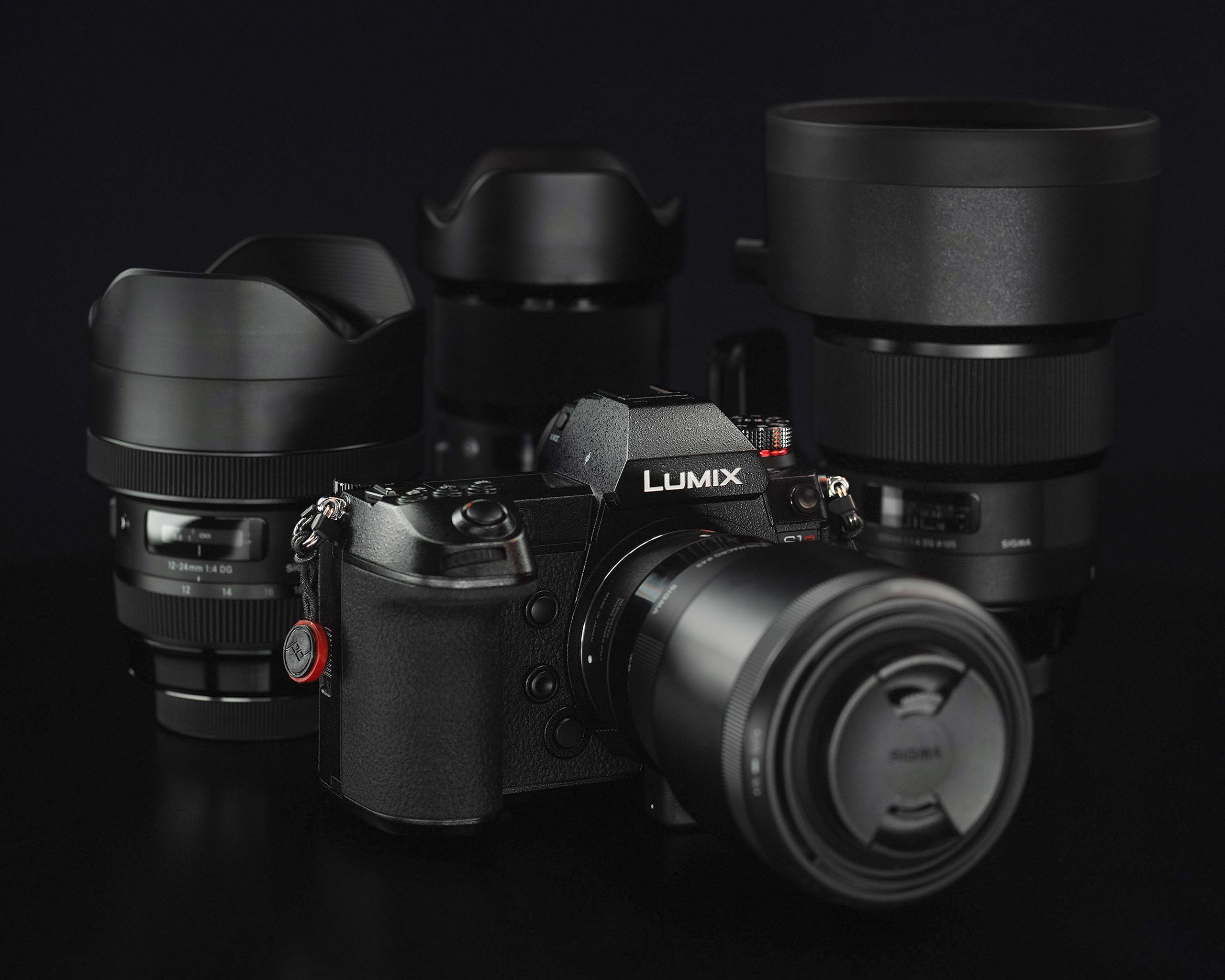

Panasonic Lumix S1R with a range of Sigma ART lens.

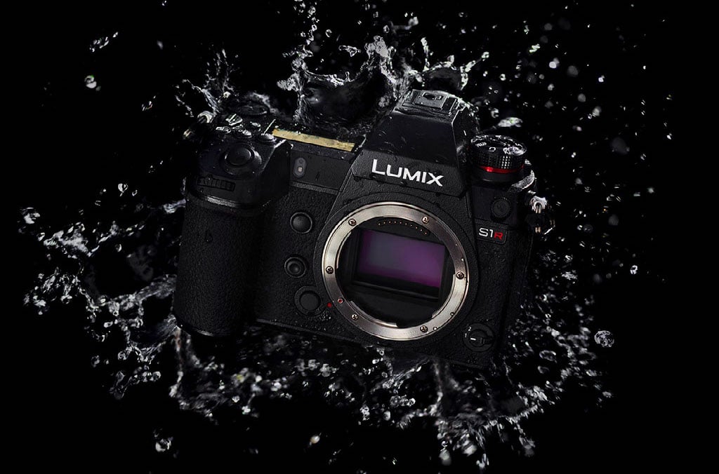

An image I created to showcase the S1R’s weather-sealed body and full-frame sensor.
While it is bigger and heavier than my older Sony a7 II, it feels much better built with a weather-sealed body that offers more controls and features, along with a 47MP sensor that can use the IBIS to generate impressive 187MP images. Of course, this is also reflected in the price at around £3,400.

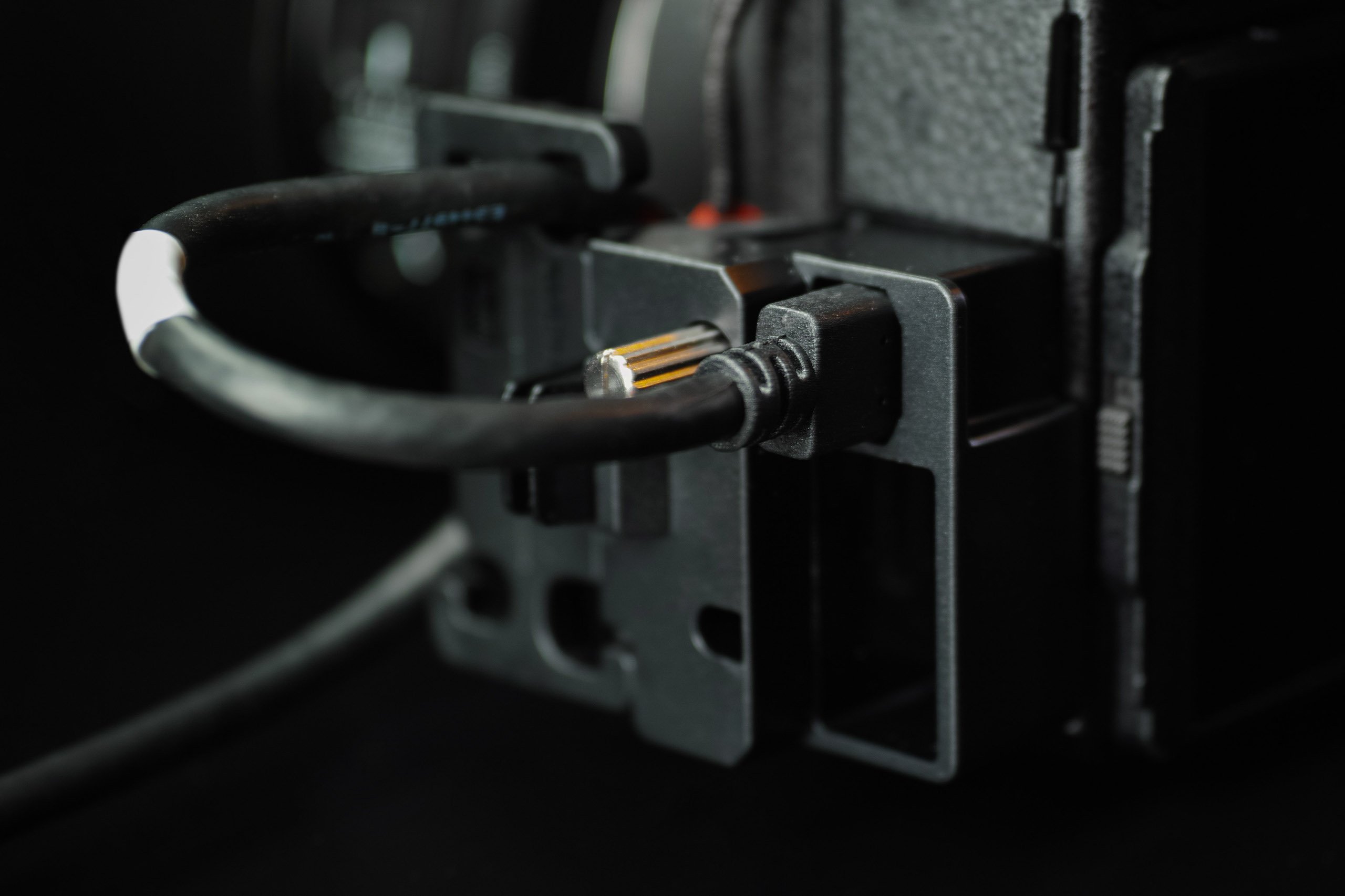

The camera also supports remote control shooting over WiFi or full tethering over USB-C, and is supplied with this little screw-in mount to secure both the USB-C and HMDI wires when in use.
The camera can also be supplied with power while in use via the USB-C port, allowing you to use a power bank for extended shooting or simply top up the battery on location.

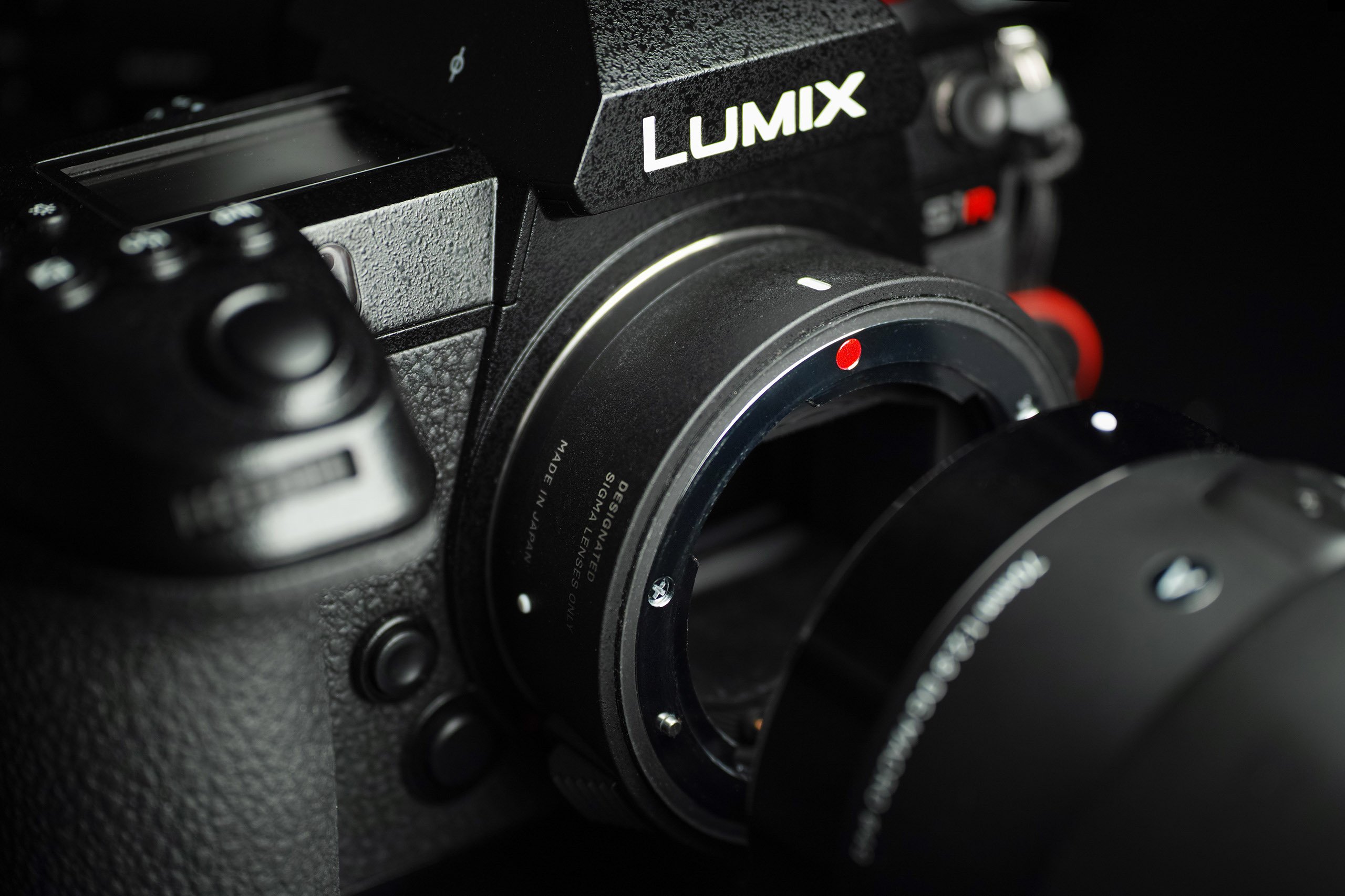

Since I am a Sigma Ambassador, I will be using the camera along with the Sigma MC-21 adaptor, which does sadly limit some features of the camera (mostly AF-C). You can read more in-depth about that on the Sigma UK Lounge, but to cut a long story short, using a proper L-Mount lens will open up what this camera can really do.
Still, using the Sigma SA lenses on the camera is simple and suits most of my photographic needs—just attach the MC-21, the lens and you’re good to go.
