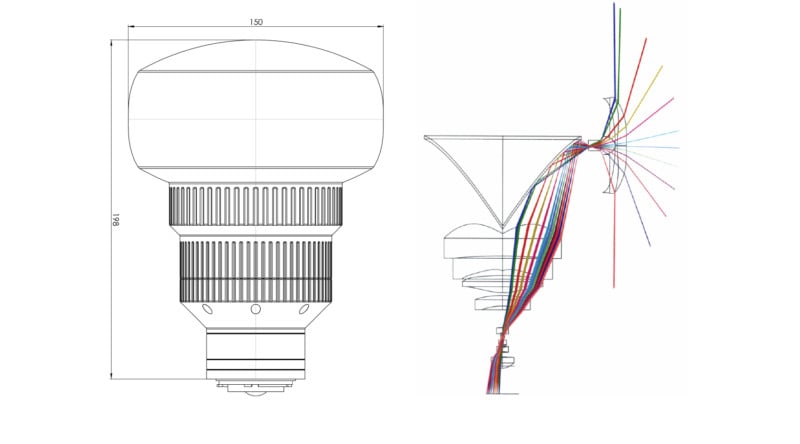

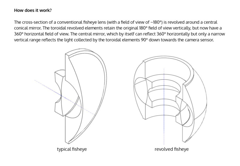

To cover 100-percent of the environment with the lens, they started with a regular circular fisheye lens with a field of view of approximately 180-degrees and mounted a mirror that reflects its image downward like a periscope in front of it. Then, using the cross-section of this setup, they extruded it in a circle around the axis of the mirror, which ended up with several donut-shaped lens elements around a cone-shaped mirror, which then provided the 180-degree vertical field of view of the original fisheye design as well as a 360-degree horizontal view from being revolved around the center.

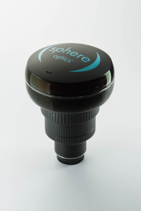

The current design of the lens has 12 elements: one reflective — the mirror — and 11 refractive, including twi torus-shaped elements that surround the mirror. Most of the elements of this lens are just as unique as the design itself and cannot be found in any other existing lenses.
The parts are made from specialist engineering plastics — using a family of materials called cyclic olefin copolymers — in a process called single-point diamond turning, which is the only way to generate the complex aspheric forms that make the lens design possible. These plastics have similar optical properties to glass, but are much lighter and easier to shape, and are used in top-end scientific applications, like space telescopes.
The duo chose to go with Nikon F-mount because it’s easily adaptable to most other common standards, making it easier for content creators to use the equipment they already have instead of investing in a completely new system while maintaining full control over the image at all times. The single-lens construction also allows capturing content that a standard VR setup couldn’t due to space limitations.
The lens has a fixed f/8 aperture and uses a 1mm focal length. It is 150 millimeters (5.9 inches) wide and 198 millimeters (7.8 inches) long and weighs 1.8 kg (4 lbs).

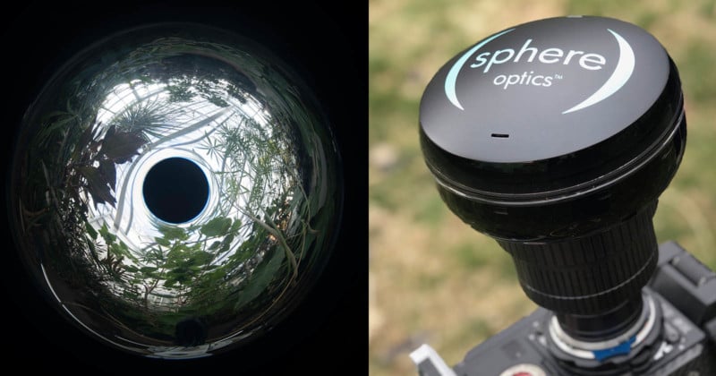

For stills, the lens produces a circular image with a black void in the center. The area near the center of the image corresponds to the forward end of the lens, and the outer periphery of the image circle is the direction facing the camera body. In their words, “It looks a lot like the black hole from ‘Interstellar.'”
