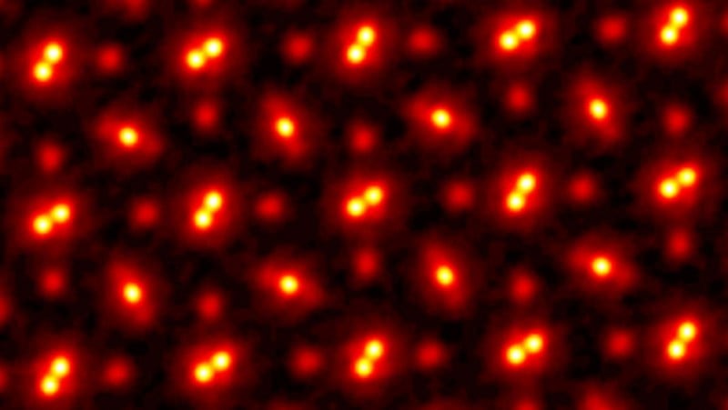

In 2018, Cornell researchers built a high-powered detector that set a world record for the highest resolution state of the art electron microscope which, at the time, tripled the previous resolution it could capture. Now, they’ve beaten their own record by a factor of two.
Cornell University’s David Nutt writes that as successful as the first approach led by David Muller — the Samuel B. Eckert Professor of Engineering — in 2018 was, it was flawed. It only worked with “ultrathin samples that were a few atoms thick.” Any thicker, and the electrons would scatter in ways that could not be disentangled.
However, on March 20, 2021, Muller again led a team that has beaten its own record with what is described as an electron microscope pixel array detector (EMPAD) that has an even more sophisticated 3D reconstruction algorithms and whose resolution is so finely tuned that the blurring visible in the finished image is due only to the motion of the atoms themselves.
The resulting photo (above) depicts an electron ptychographic reconstruction of a praseodymium orthoscandate (PrScO3) crystal, zoomed in 100 million times. The results of this experiment have been published in a full report here.
