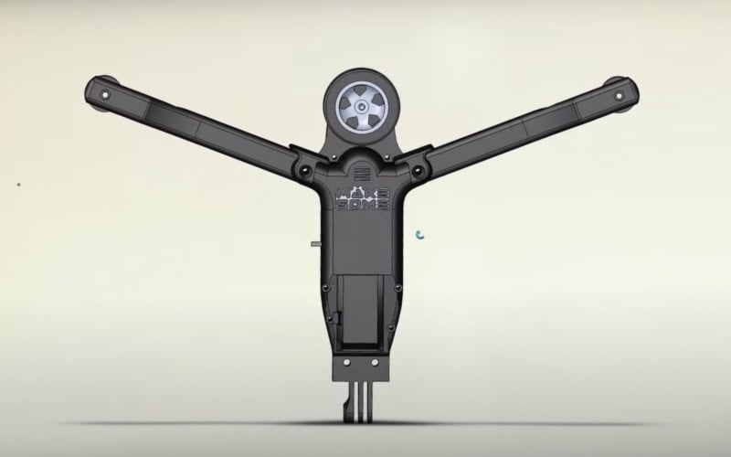

As Kasper explains in the video, he was “heavily inspired” by the Wiral LITE, and he created a nearly identical design, with the motor in the middle, two arms actually attached to the cable, and one wheel in the middle to run the camera one way or the other down the wire.

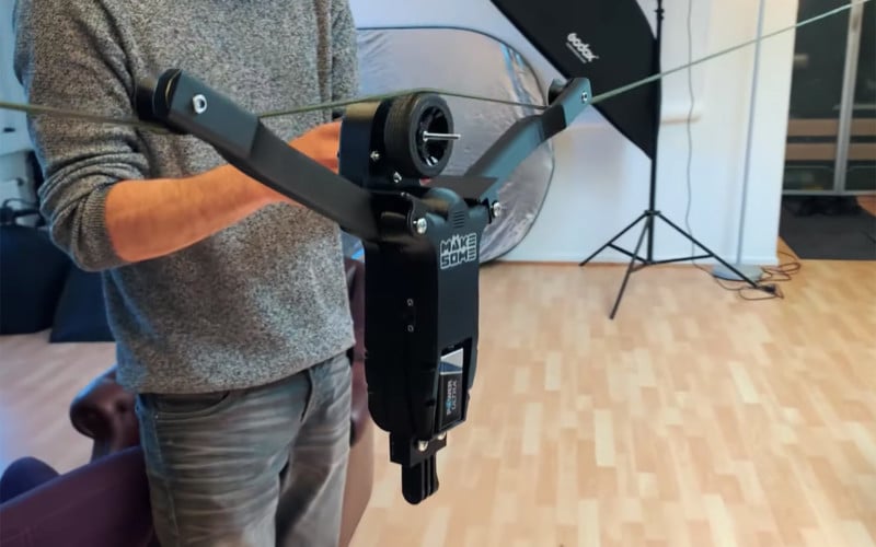

The final build consists of the controller/antenna from the RC car, one of the car’s wheels, the DC motor from an old HP printer, an Arduino Nano, an L298N double H-bridge, a 3S Tattu LiPo battery, and a BMS. All of this was put together into a 3D-printed final product that was printed on a Prusa i3 Mk3. The final product looks like this:
As you have probably already ascertained, by the end of their prototyping and building, there wasn’t that much of the RC car left. They initially wanted to use the motor and battery housing from the car as well, but that didn’t end up working because it was too weak and “flimsy.” So the final product ended up using the Arduino, and H-bridge, a LiPo battery, and the printer motor to make the whole thing work.

The development turned into a lot of prototyping and experimentation, but in the end we got it working and shot some really cool footage!
